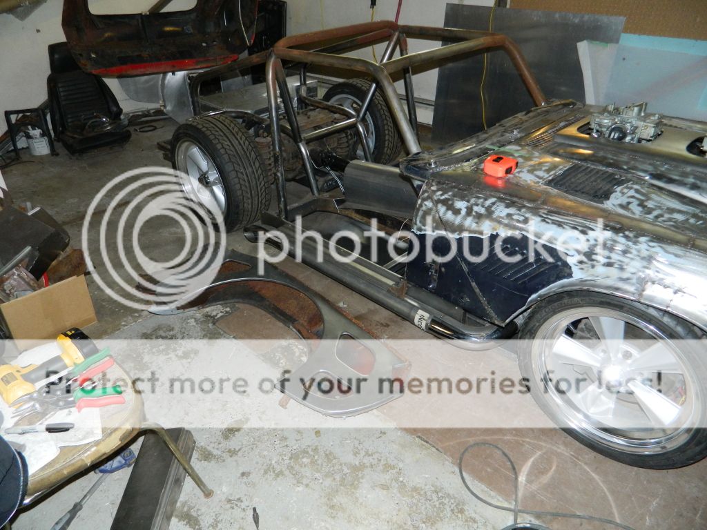

here's today.just about exactly one year later.

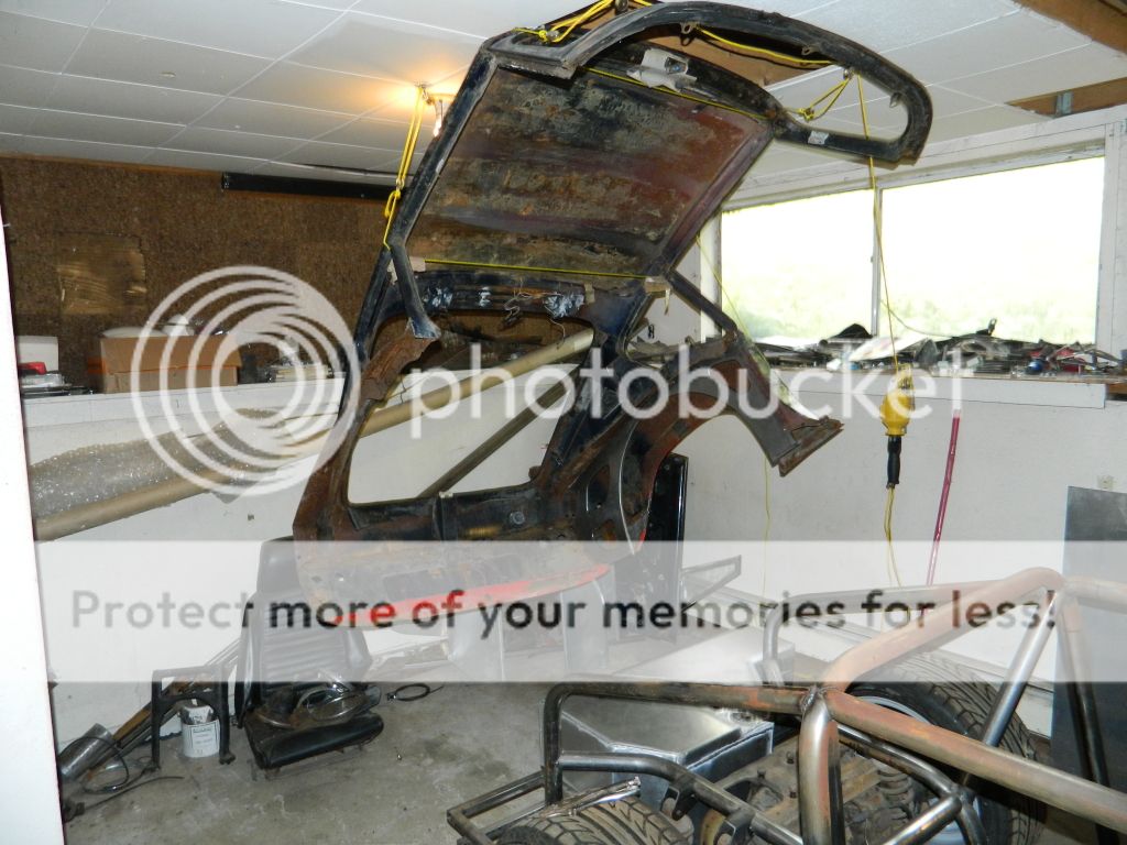

i've started taking the rest of the body shell apart-note the rear fender laying on the floor.
while still hanging from the roof,there's getting to be less and less up there.

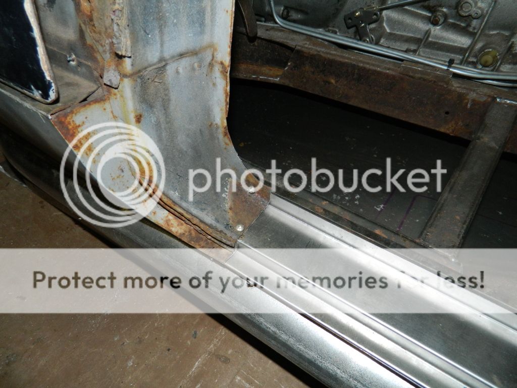

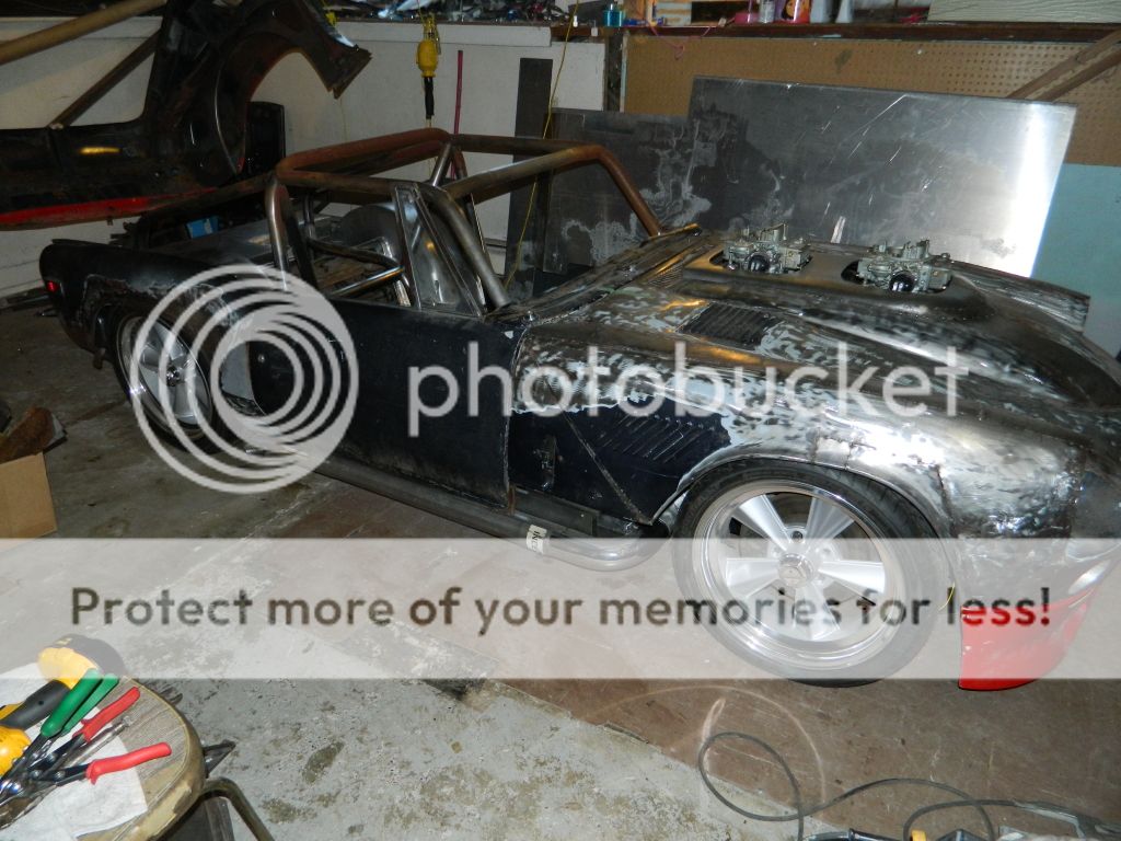

a bit more in place...but this time stuff is more solidly attached.
where possible everything is being held with sheet metal screws till i get everything lined up properly.then the screws can come out and everything gets welded permanently.
makes for easier adjustments.

Is it me or is there a bit of a camber issue in the back?
And at this rate it may be pretty close to finish welding after this winter. Looking good!
it's just the picture.i have to put the camera on wide angle to get it all in the pic in this small room(no standing way back)so there's some distortion.
your take on the timeline is about what i was thinking too.
Good. This thing is going to eat rear anyways, it doesn't need any help from the camber lol. :headbang:
It seems like you're pretty much there with the running gear, right? just metalwork that needs to be done?
yup.i have to get the cooling system buttoned up,and run a fuel line,but that about gets it going.some wiring,too.
there's some interior panelling to do still,and the body mods to finish,then it's paint and upholstery.

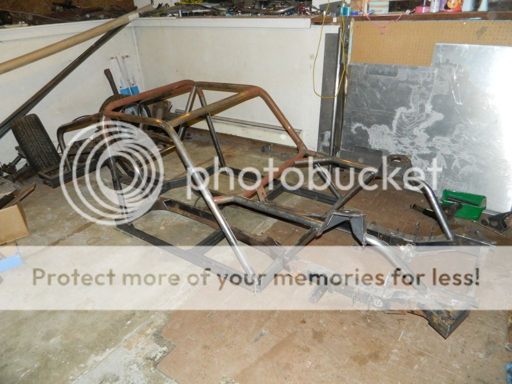

while i was measuring everthing to get the body panels lined up,i found a couple of minor discrepancies in the frame.
it's damned near impossible to get decent measurements with everything in place,so i figured i'd just strip it down and build a simple frame table to recheck everything.
Given your talent for understatement I'm gonna say "minor discrepancy" means half of it's not there and the other half is off by a few inches.
Or half of it's on the mainland....
