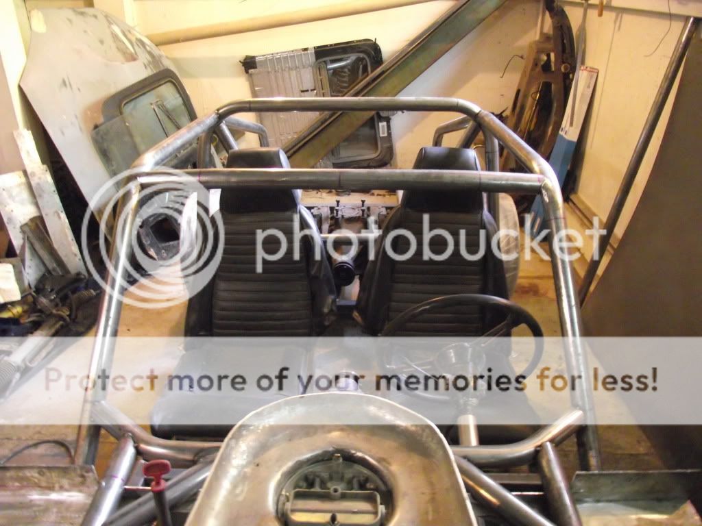

thought i would put up a photo that illustrates just how tiny the interior of this car is even before filling it up with engine and transmission..
Gt-12
notice the seats,how the back is wider than and offset from the bottom...this is because there is no room to put in a wide enough seat,so you actually have to sit in it leaning toward the middle of the car.
and that is factory original.

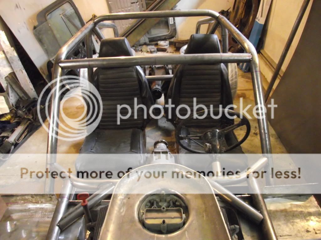

i also found that i have to raise the bar at the top of the windshield-when sitting in it(going 'vrooom vrooom')that bar is right in my field of view.
I hate when shit doesn't pass the vroooom vroooom test

oh,it still passed the test...just needed a small correction:D
Gt-12
hard to tell,but moving it up 7/8'' was enough to get it out of the way,and still not interfere with the body.i need every bit i can get,as the windshield is only 10'' high.this is why everything is just tacked until it's all figured out.

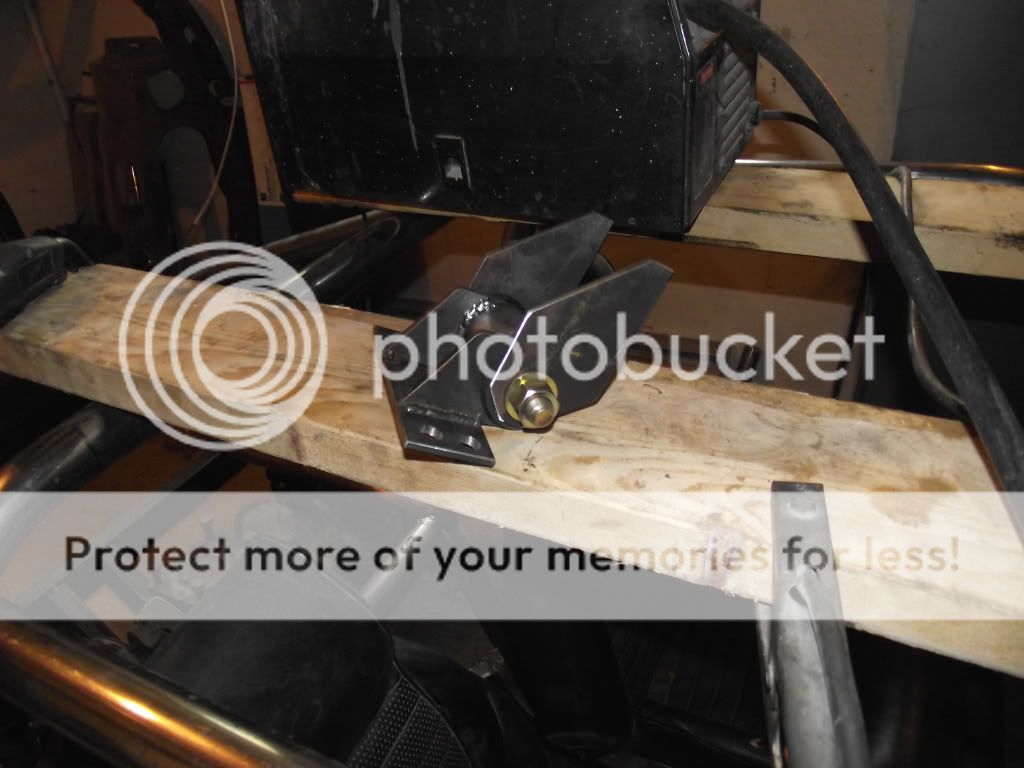

so,i figured since i mounted the engine,i may as well do the same for the transmission.
Gt-12
so i made this.

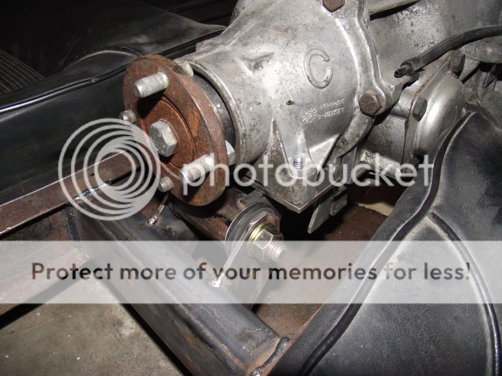

Gt-12
and in place.
