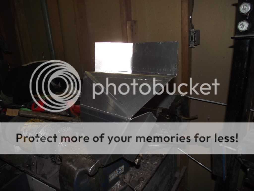

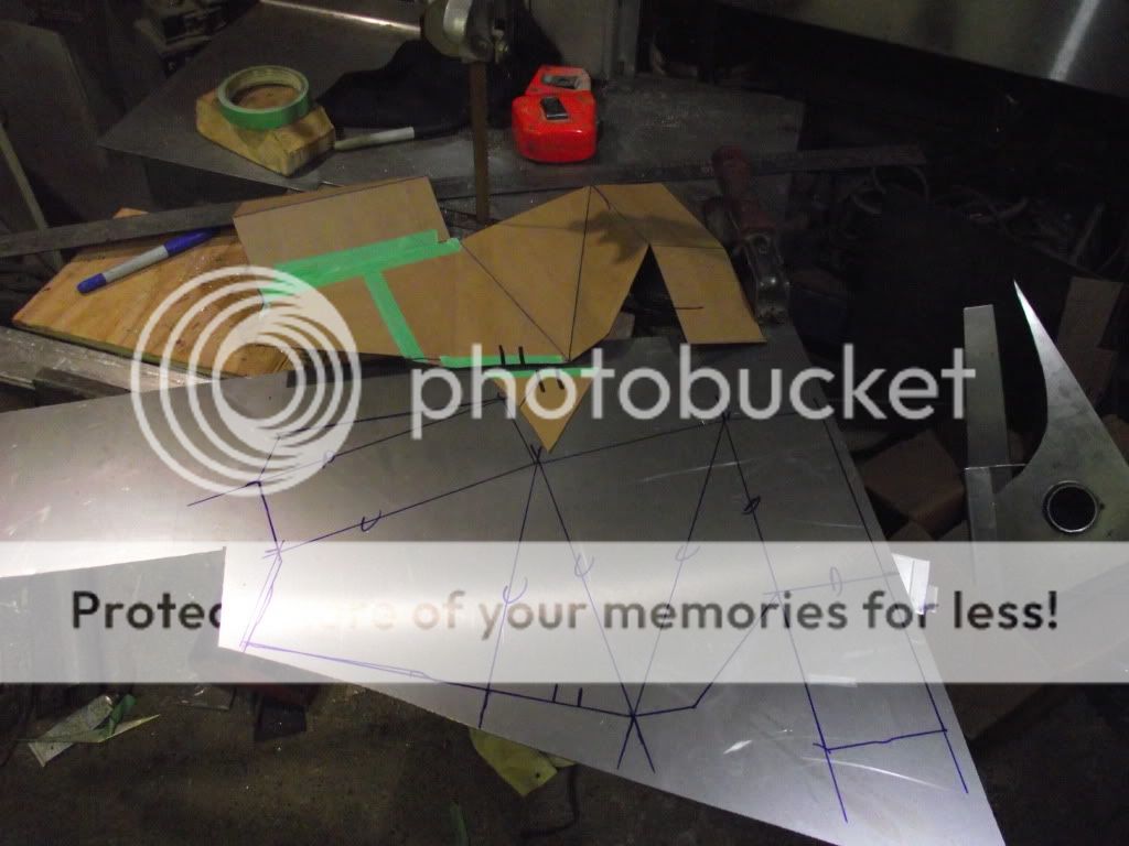

all that origami from last night is getting turned into something more substantial.i'm trying to make as muck of the shape by bending,rather than welding,as it saves time,money,and makes the finished product look better.
having said that,when theres this many bends on a small piece some planning is needed.every bend must be thought out to make sure it's possible to do.i've had to cut parts from the brake before because after a bend there was no other way to remove them.
after much planning and visualizing,it turned out ok.

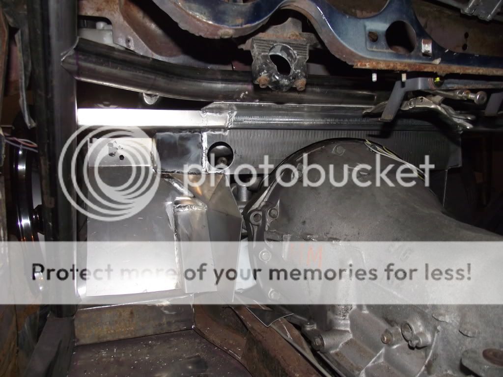

and in place,i'm one step closer to getting the trans tunnel made.
Now I see another reason why it's a automatic now room for a third pedal. although heel toe clutching will be easier for drifting!!:icon_hornsup: Steering is gonna be tight too.
I see Vise grips at work!
ya,there's no room for anything there.
as for the vice-grips,i should have taken a pic when i was welding the new piece in-there were 8 pairs holding things in place.

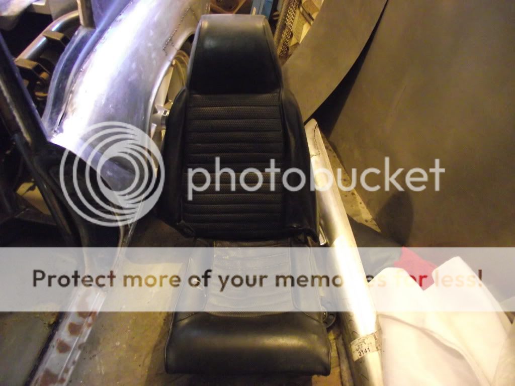

here's the driver's seat.....
and no,i haven't modified it in any way.that's how they come from the factory.these cars are so small you have to drive them leaning towards the middle.the passenger seat looks just like that,but offset the other way.
and if i moved the column over any the steering wheel would be hanging out the window.:D
