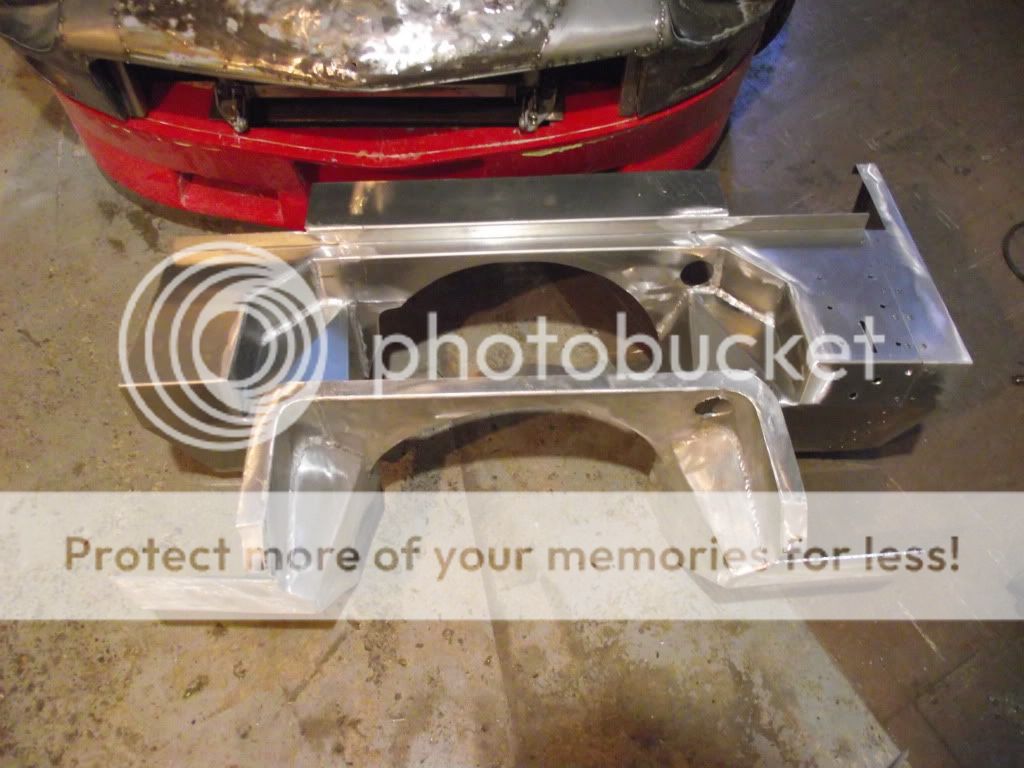

here you can see the difference between the old firewall and the new one.the part that wraps around the engine is 5'' wider now.much more room to get hands into the header bolts.

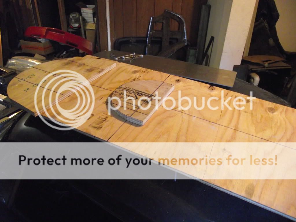

and now i get to start on the next bit of woodwork.this will become a station buck for the trans tunnel.
Wow! that's one impressive piece of work.
it's getting there.i still need to finish the right side end cap,some bracing for the master cylinder,and the tunnel flange.the need for it to be removeable has upped the challenge some.(i'm assuming you're talking about the firewall)

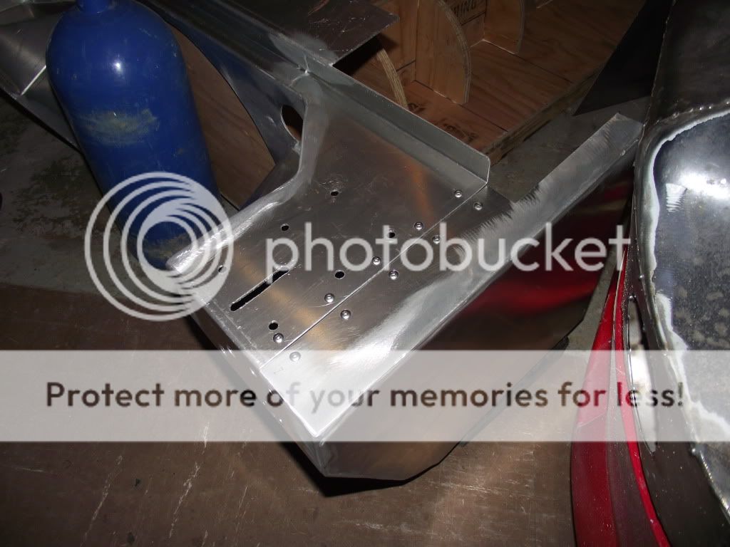

here's a pic of how the left end cap is held on.i used a double row of countersunk stainless screws and a strip of 1/8 aluminum on the backside tapped for them.this gives a clean,flush joint.the cap attaches to the kick panel on the car's body,but is removeable to allow the firewall to be removed.

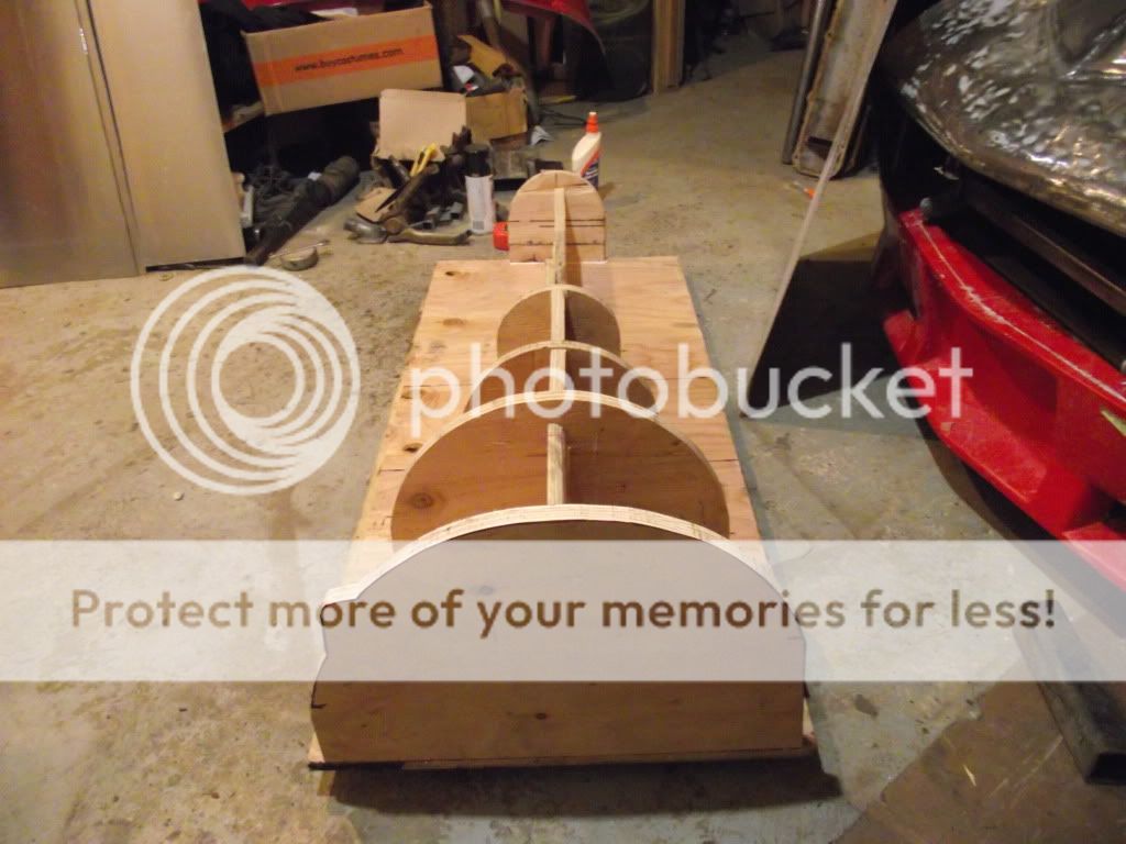

and the station buck for the trans tunnel.all it needs to be is a representation of the profile at specific spots(stations)along the length.this will be used to determine the templates for the aluminum and check the fit of the final parts,but nothing will be hammered or formed on it so it doesn't need to be as robust as the wheel tub forms were.

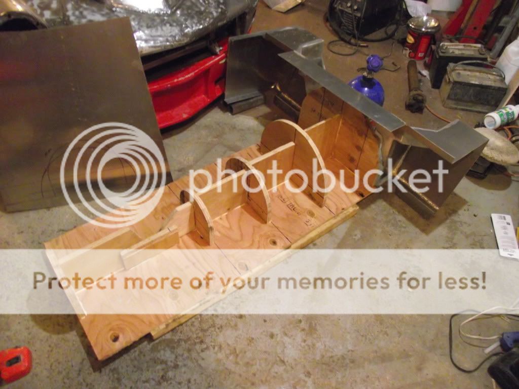

another view of the buck.this covers the whole tunnel from the firewall to the rear diff flange.it's 4' long.
