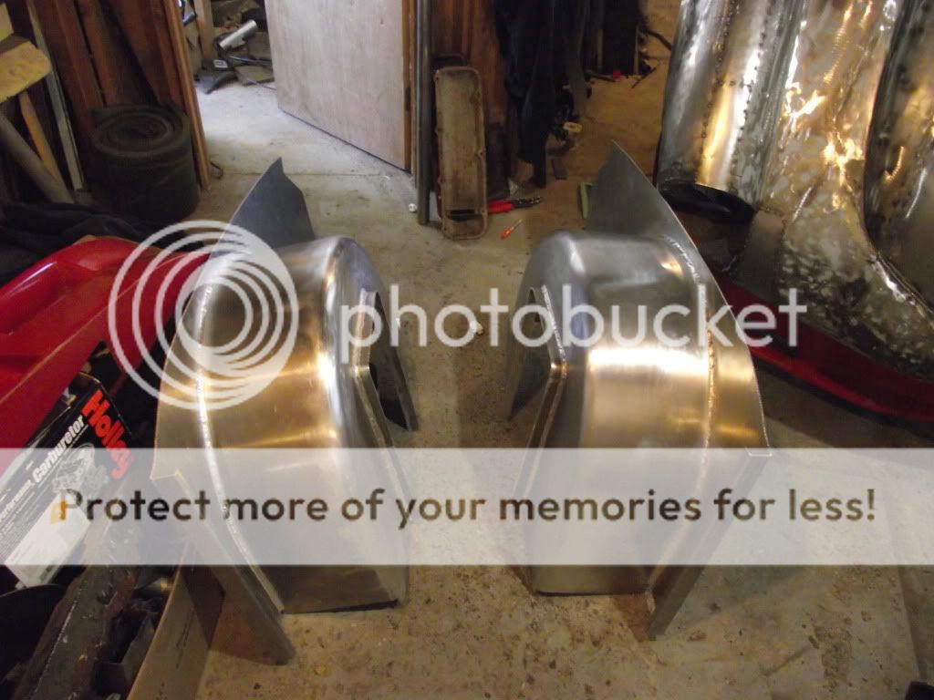

ok,here's some pictures....
like i said earlier,i finished the other wheel tub.

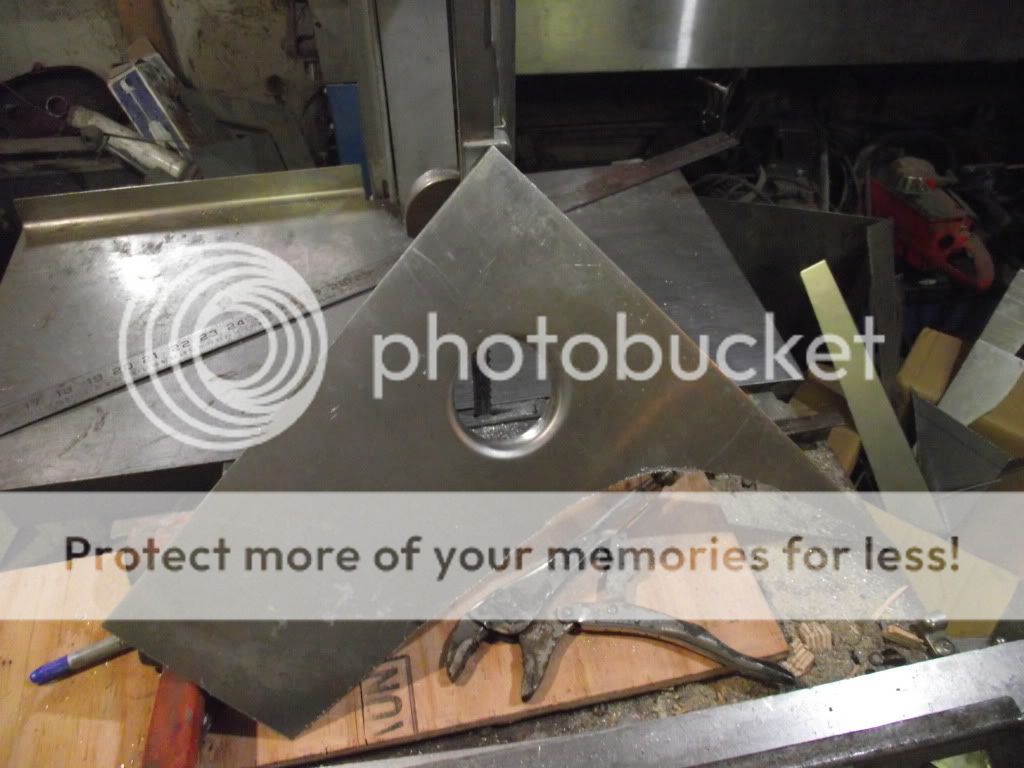

i've been trying out dimpled holes...some of these may be sprinkled about the car.

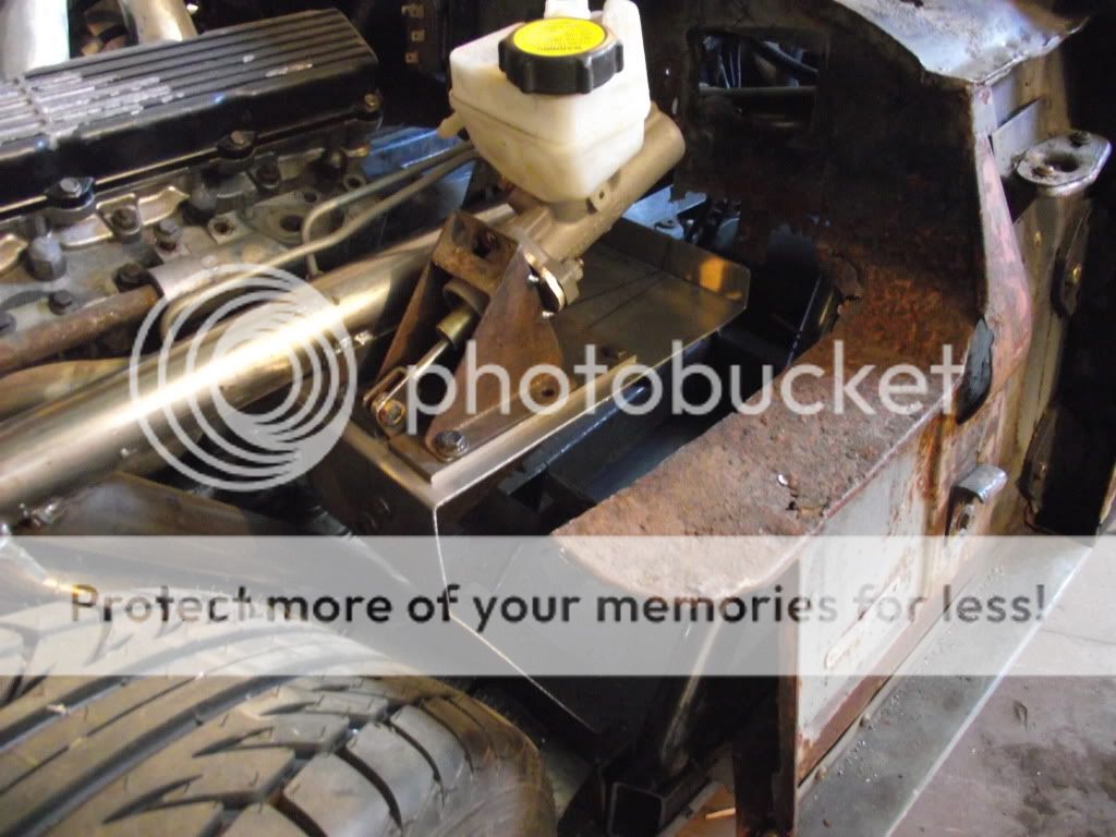

ahhhh....the firewall.this is a complex piece.it's a tight fit everywhere,and needs a huge amount of shape to get around everything,plus it's got things like steering and brakes going through it.one of the other challenges is that it needs to be removable.that is why it ends short of the outer edge of the body-it needs to fit out between the cage bars.the outer ends will be part of the body shell.

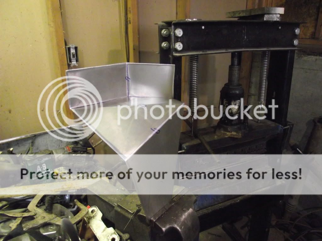

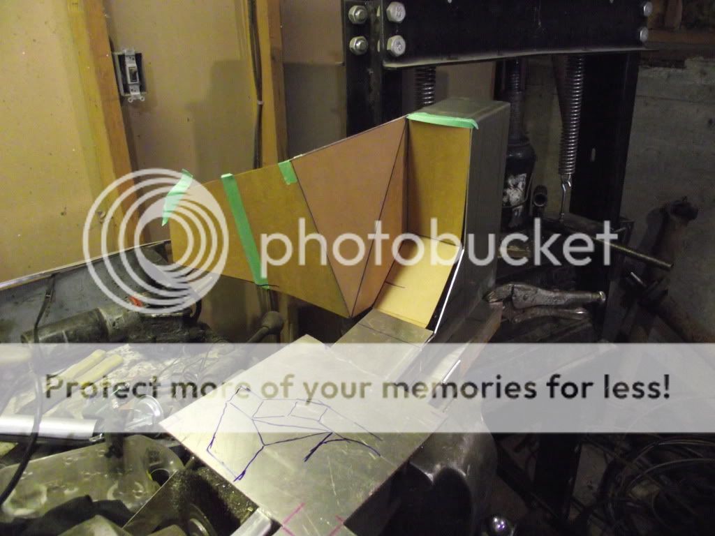

heres part of the passenger side,figureing out part of the layout for a panel.i did the layout on cardboard,then formed it up to check the fit.you can see the concept sketch on the chunk of aluminum in the foreground.

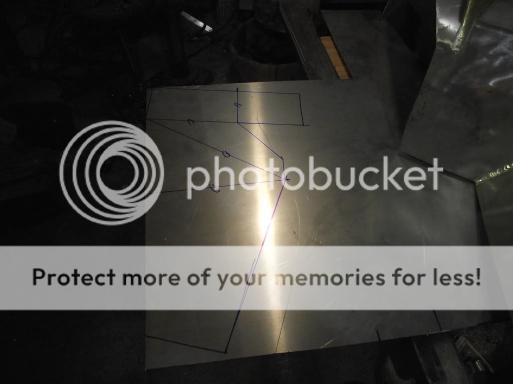

this was transfered to aluminum.

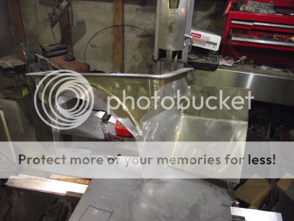

after cutting out and bending,i've got some welding to do.
Very handy things those are. They can cut down on weight while increasing strength. You'll find them a lot on aircraft for that very reason. They also have the added advantage of looking better than a plain hole when you need one for something to pass through.
all the real reasons i don't care about too much.i just think they look cool.
I kinda figured that, I was just point out the other qualities they have. I agree completely with doing it just because they look cool.
thought you would:icon_thumby:
i mean,don't get me wrong,all that other stuff is great....especially if you've got an airplane,or a race car.but we all know,on a hot-rod it's all about the wow factor:D

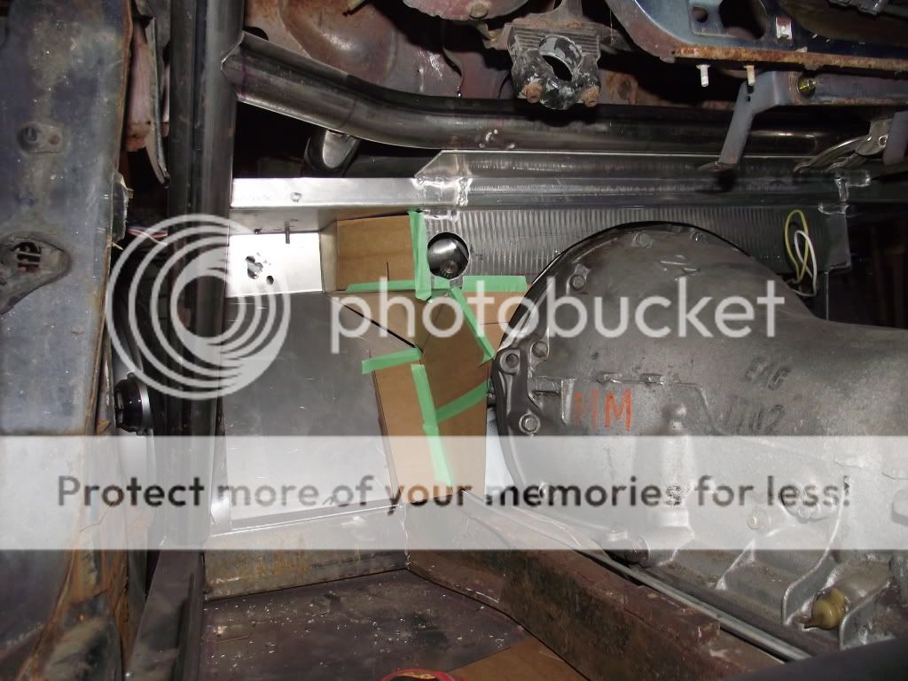

ok,more cardboard fabrication...
i'm fighting for every fraction of an inch here.clearance from the bell to the firewall averages about 3/8''.good thing it's got stiff engine mounts-there won't be too much banging going on.

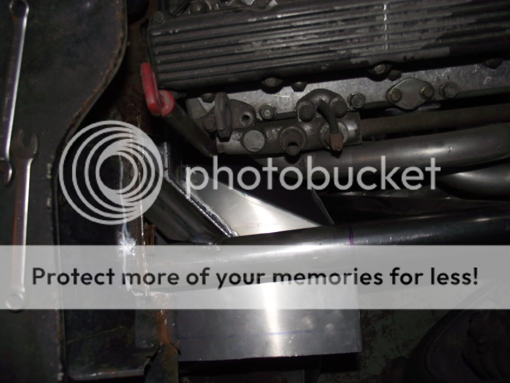

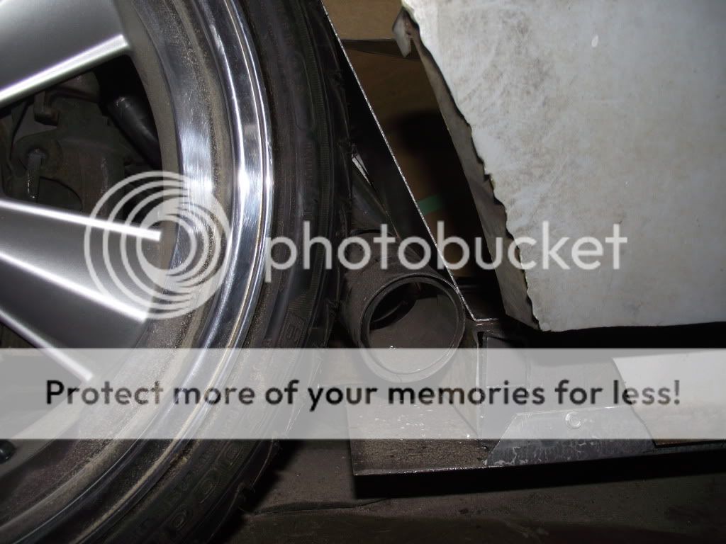

and the tire-exhaust-firewall spacing.no,there's no extra room here either.
and here's one of the reasons for remaking the firewall...
looking down from the top you can see there's lots of room around the header flange-on the old one it was too tight to the header....i could get at the nuts,but it was a struggle.i realized that the room i was saving by having it so tight was just being wasted as open space above the feet,so in this design there's a little less space in the upper footwell,but servicing on the headers(which need to be removed for virtually any major engine service)is now much easier.
Doc... I'm not sure it's gonna fit. For my eyes that's to close for comfort, but then I am looking at a pic and not the car itself.
ya,the pic makes it look like the exhaust is tight to the firewall.there's actually about 1/8'' there.lots of room.
how about clearance between header and tire? i'm worried about melting tires! :(
