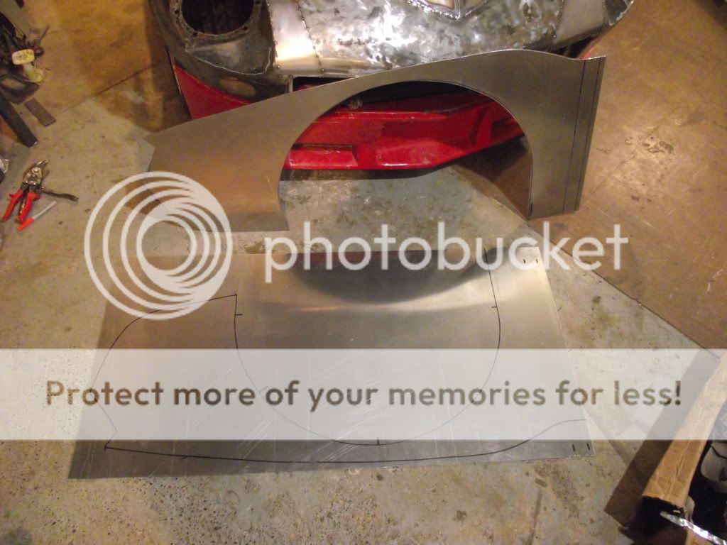

figured i'd get onto the outer 'flange' for the wheel tubs.it's actually more than a flange,it's a complete inner fender.here you can see one cut out,and the other traced,ready for cutting.

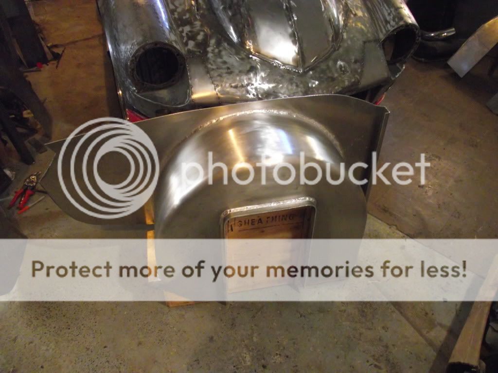

after welding to the tub,and the inner flange put on,it still fits on the form.this is a good sign.
these will be welded to the floor pan made earlier,ad be bolted to the outer fenders to support the body.
