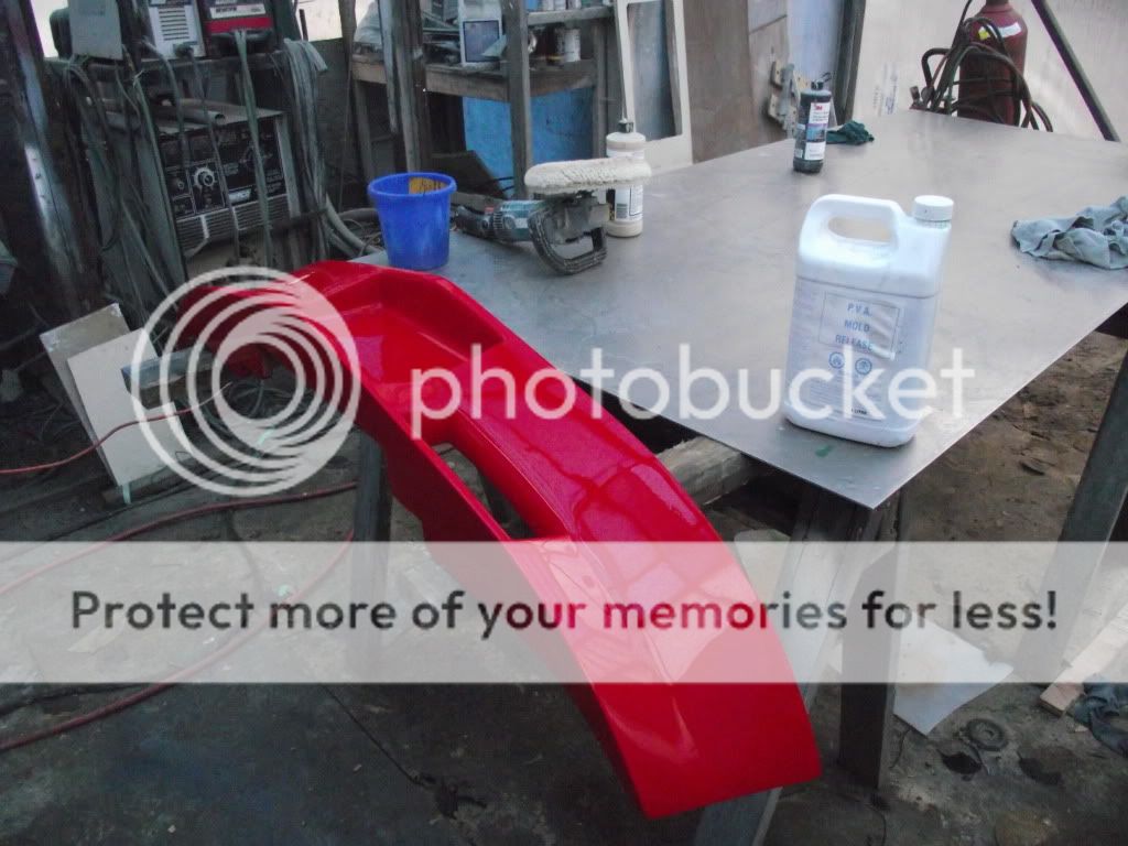

Gt-12
i polished out the plug and sprayed on a layer of pva.

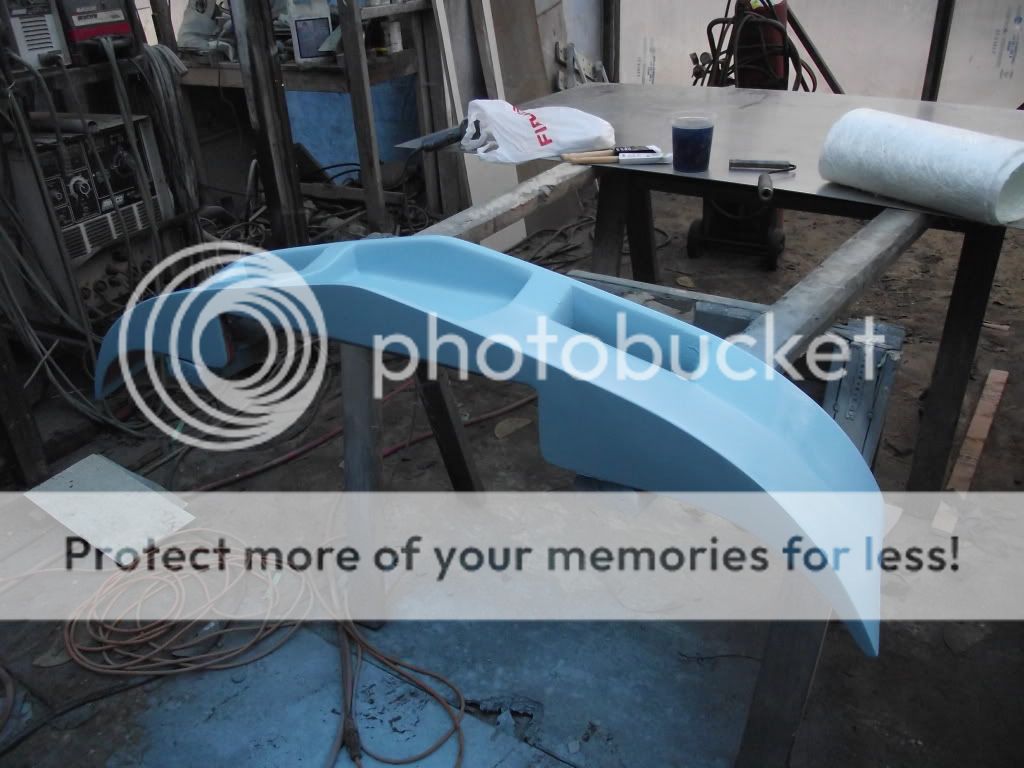

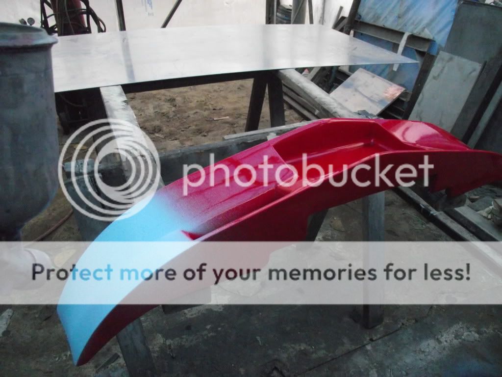

Gt-12
once that dried,i shot on some gelcoat.while the color of the gelcoat makes no difference to the final product,i like to use a color that is not similar to that used on the plug,and also not similar to that i intend to use on the final part.this is just so i can see the coverage as i'm spraying.if it's the same color it's hard to see if there's enough material sprayed on.

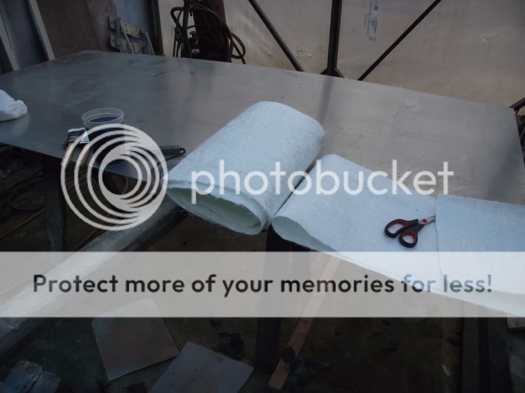

Gt-12
once the gelcoat is set,i cut the matt and get all the tools and materials ready.
once you start this step there is no stopping till it's done,so you don't want to be hunting for stuff halfway through.

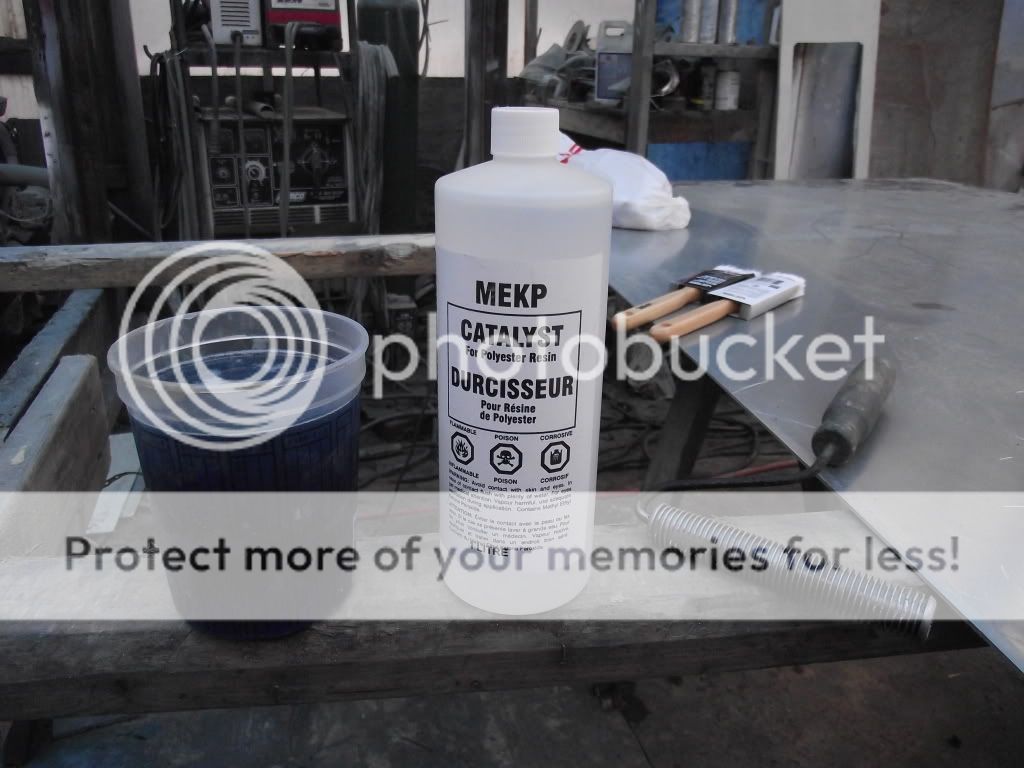

Gt-12
some things to have ready...resin,of course.pre-cut matt,and a cheap disposable pair of scissors.de-airing roller,brushes,some rags and a tub of acetone need to be on hand.
Gt-12
there are a lot of numbers out there about mixing resin and catalyst.i've used experience over the years to determine how much to use depending on temperature and moisture conditions.lower temps need more,higher humidity needs more.today it's about 4*c and raining,i used 1 1/2 capsfull of hardener to a litre of resin.if it were summer and dry,i'd use about 1/2 a capfull.
you'll notice i buy the catalyst by the litre,i also buy the resin by the 45 gallon drum.smaller quantities will be purchased by most people out there.

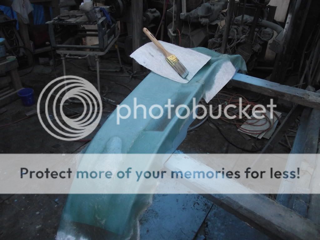

Gt-12
when starting the layup,i put down one layer initially.this makes it easier to get all the air bubbles rolled out.this is a vital step...any trapped air will lead to pits in the mold that will need to be fixed.that is not easy to do.
this is as far as i got today...now i need to let that layer set so i can get to the rest of the layup.
