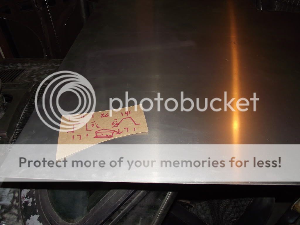

i think i figured out what to do next....
Gt-12
i dragged out the blueprint for the driveshaft tunnel,i think i might just see if i can get some interior stuff made.
