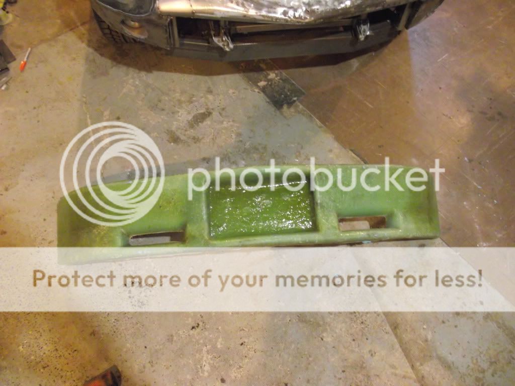

so i laid up the final layers this morning,and now it's set up.
Gt-12
i'm a little worried about one thing...the gelcoat wasn't fully set up when i started laying glass yesterday,but it was about to get dark so i figured i'd chance it.this morning i noticed on the ends of the airdam there was some wrinkling of the gelcoat under the glass,but i had no way to tell just how far under it went without pulling everything up.
so i had a decision to make-do i hope it doesn't go too far and carry on,or pull everything off now when i can probably save the plug still,and start over.
i decided to chance it,time will tell if i made the right decision.

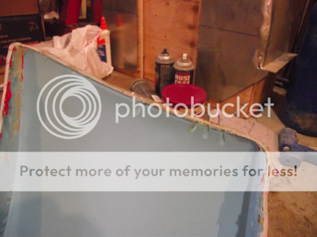

well,all's good:icon_thumby:
Gt-12
it turned out good-the wrinkles didn't go in very far...less than an inch.
Gt-12
you can see here what i'm talking about.not a worry.
nice work gwaii
thanks...i'm pretty relieved at this point.still got some cleanup,trimming and bracing to do,but i'll be able to lay up a part in no time.

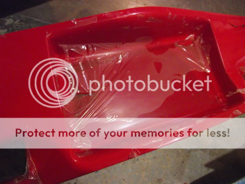

here's the celophane-like stuff that was mentioned before.it's the dried pva.

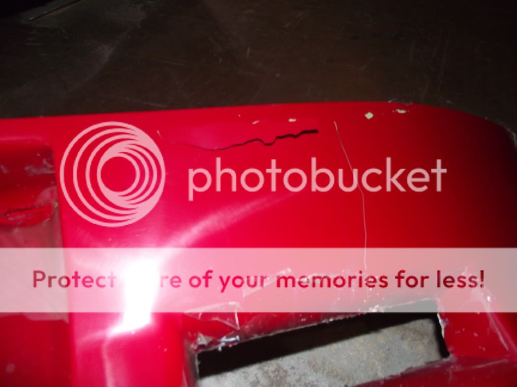

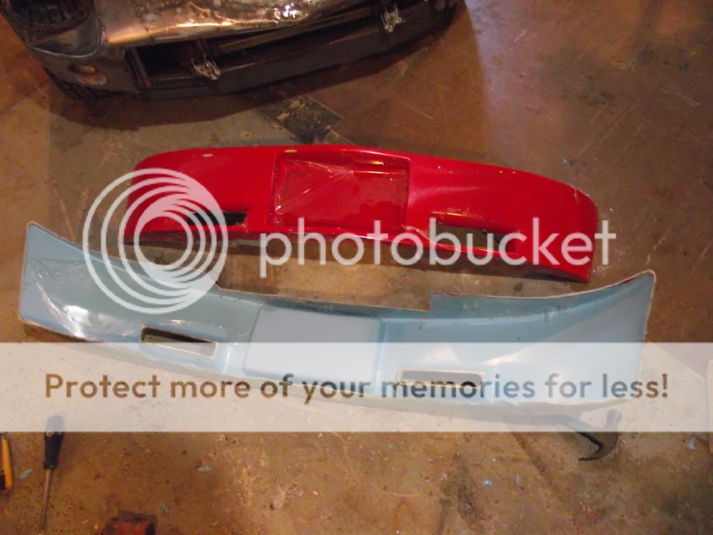

and this is some of the typical sort of damage that happens to the plug on removing the mold.this is why there's some anxiety at this point...it's a one-shot deal.
nice! so now you just need to fix the wrinkles, make sure that there's no no dips or anything caused by airbubbles, and lay in some fiber?
I'm glad that turned out well, looks good. Is the mould reasonably rigid or are you planning on adding some bracing to it.
