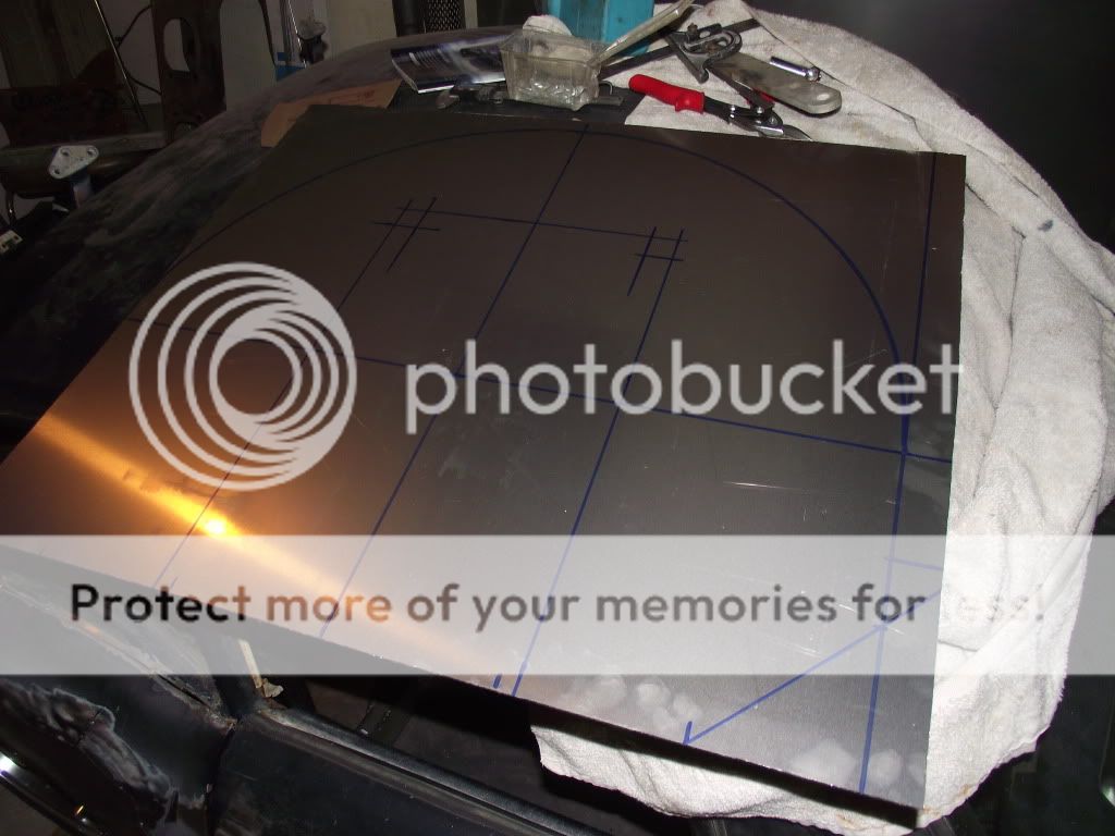

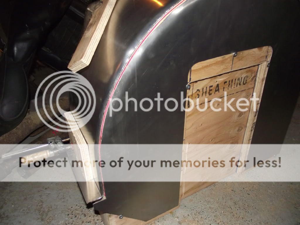

here's getting the face laid out.basic geometry.

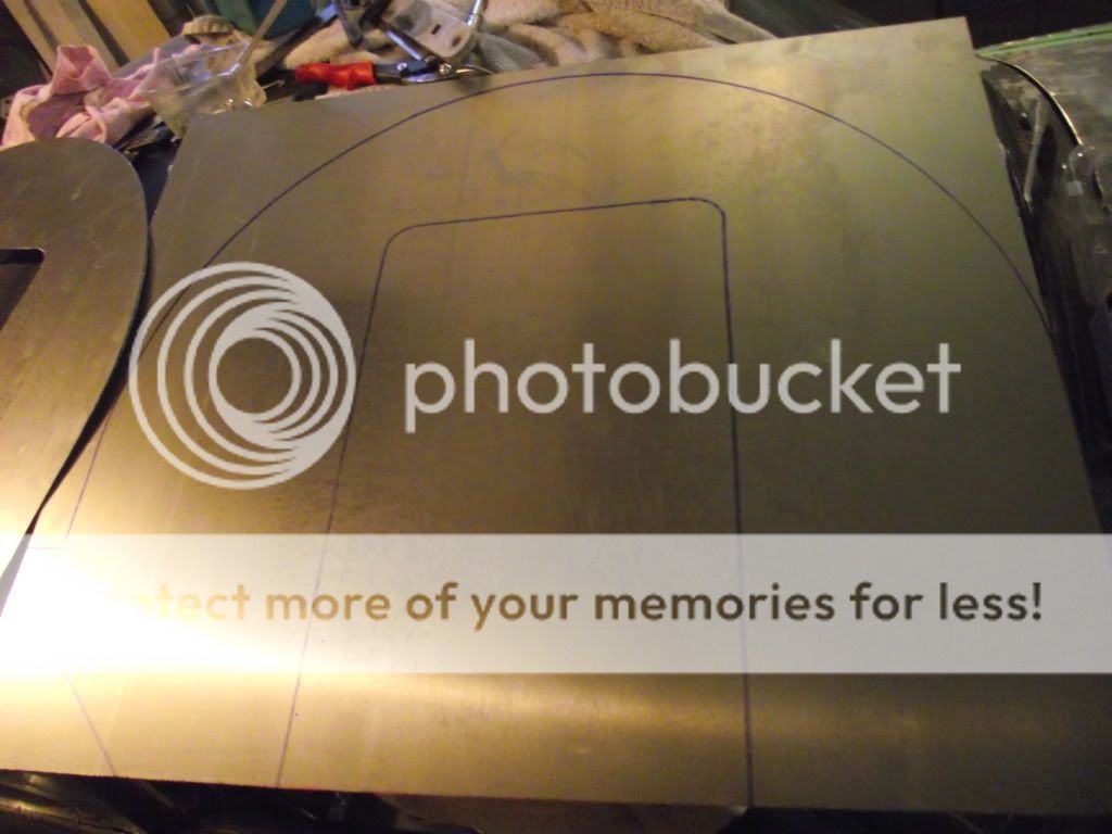

and cut out.
rather than laying out the one for the other side,i just traced the one i just did.

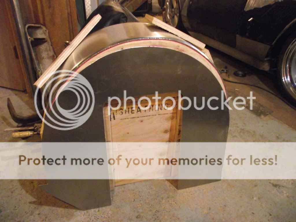

after rounding the edges,it's ready for welding.

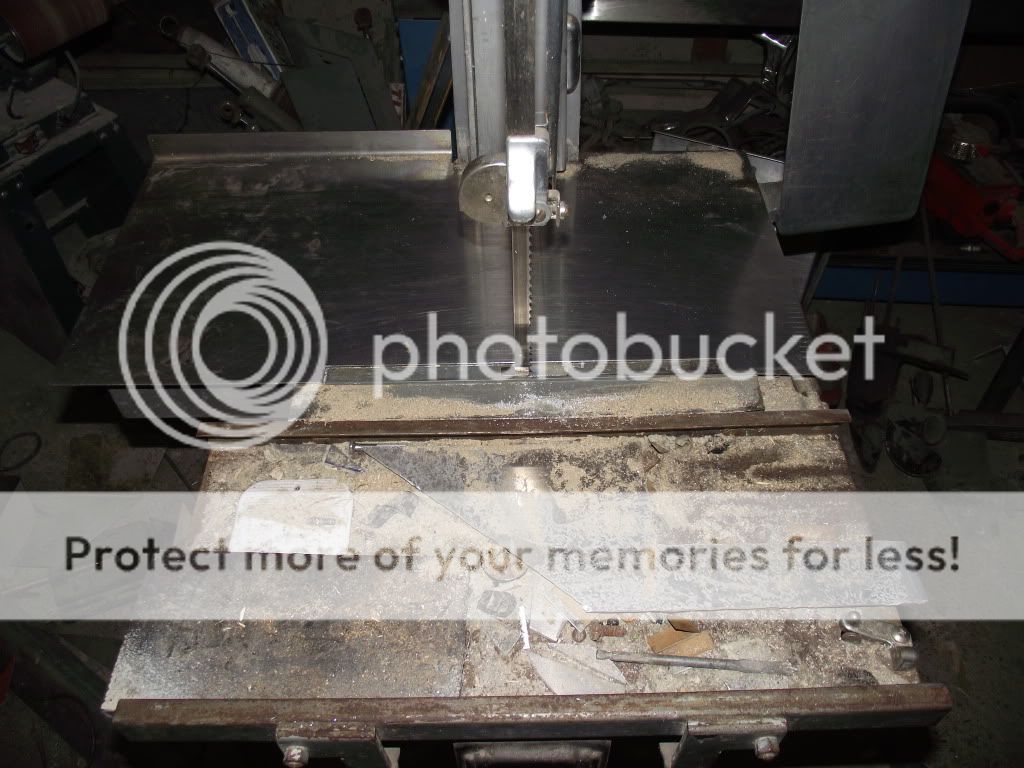

Just curious but what did you cut the sheet out with?. I noticed how nice and flat the parts are.
bandsaw.
i got a good deal on an old meatcutting saw a while ago that is a very solid unit....and the blade that was in it when i got it works well on aluminum and wood.i'll need to slow it down a bit to use it on steel.
on inside radius corners i holesawed the corner first,then cut the straight parts with the bandsaw.

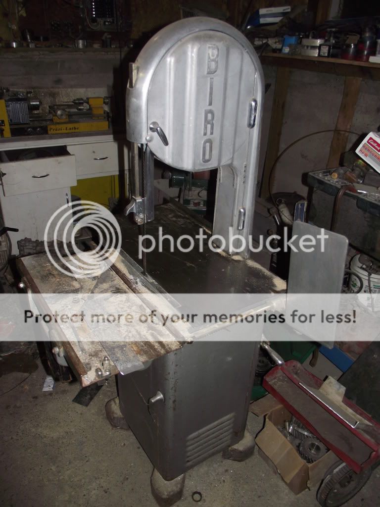

this is the bandsaw i got.i paid $250 for it,and it's in near perfect shape....but it's obsolete for the butcher shop.
that's a 3hp motor hiding under the cover.lots of power,and this thing weighs about 400lbs,so it's very stable.
How big of a throat does that thing have?
11''.
not as big as the saw i had in mission,but still lots for most of what i'm doing.
this was the one downside...it had a sliding table on it,i had to remove that for my use-but i still need to make a new platform to replace it.

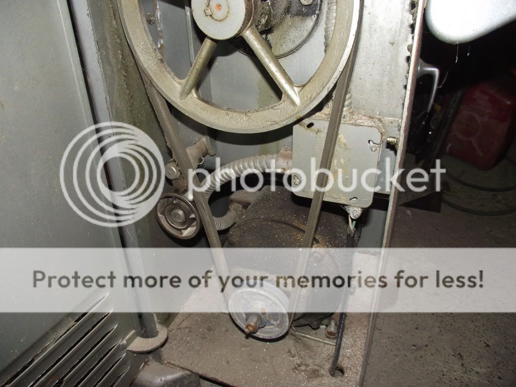

Mine's a 3/4 horse 14" throat. From what I'm seeing though it looks like I can get a lot done with mine so long as I'm patient.
is it a three wheel?
i used to have a delta 3 wheel that was 3/4hp/14''
Two wheel, Says porter cable but they recently bought Delta so it's probably a similar design. Let me see if I can snag some pics.
hm.3/4 hp sounds low for a 14'' two wheel.
slow cutting was what i didn't like about my delta.this meat saw you can push right into it and it doesn't slow down.i'm pretty happy,i didn't even know if it worked when i bought it.
It's a 2 speed and apparently it's a 1.5 horse, once again I've proven myself a retard.
