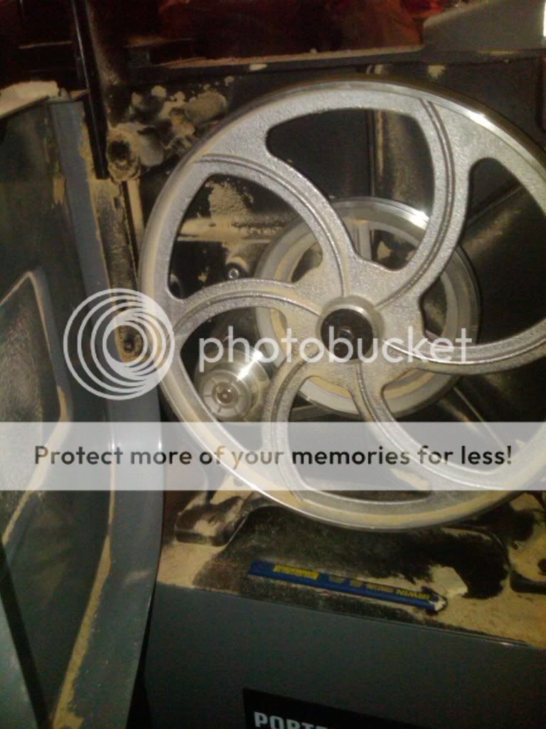

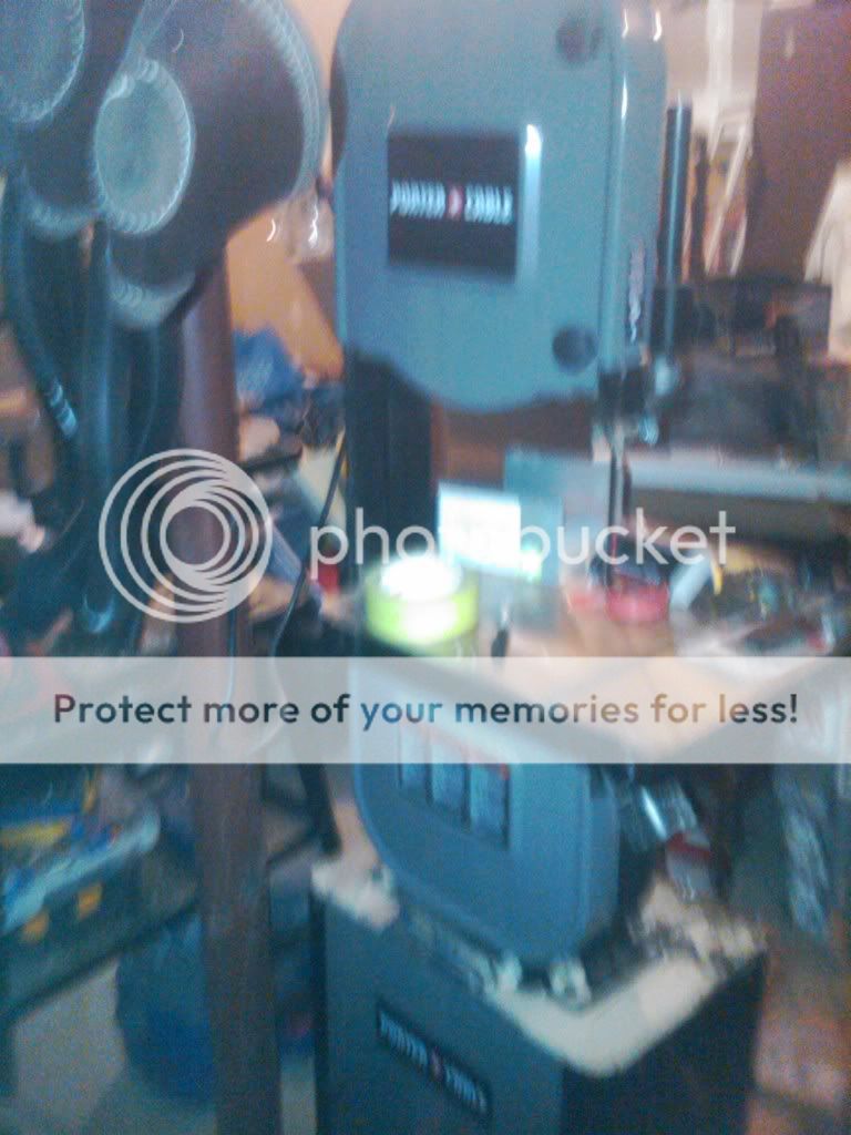

i do use a jigsaw sometimes,but only as a last resort...most cutting is done with a circular saw,and when i can,i use the band saw or a zipcut.i don't generally use shears on aluminum.

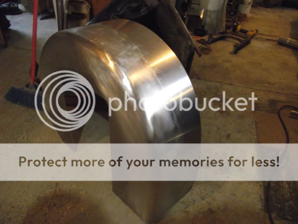

after welding and grinding and sanding,i've got pretty much what i was looking for.i still need to put the flanges on the inner and outer edges,but the outside corner was my key concern at this point.

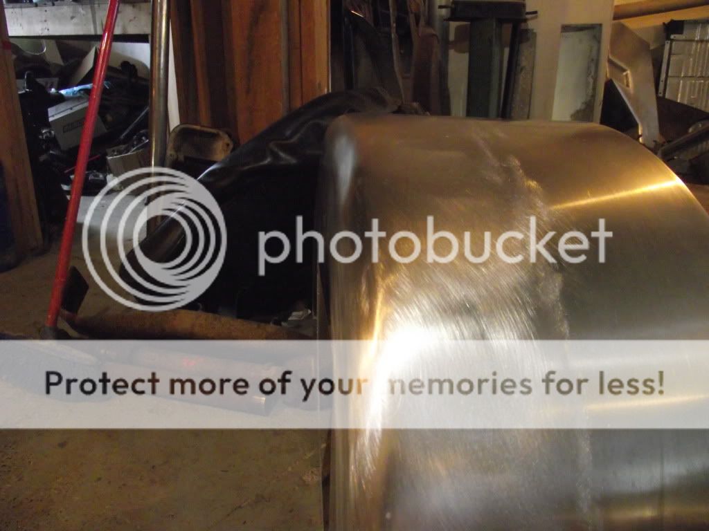

a profile shot shows better what i'm talking about.this looks way more professional than just having a squared off corner,even though it's much more work to do.
Impressive, looks like its all one piece
