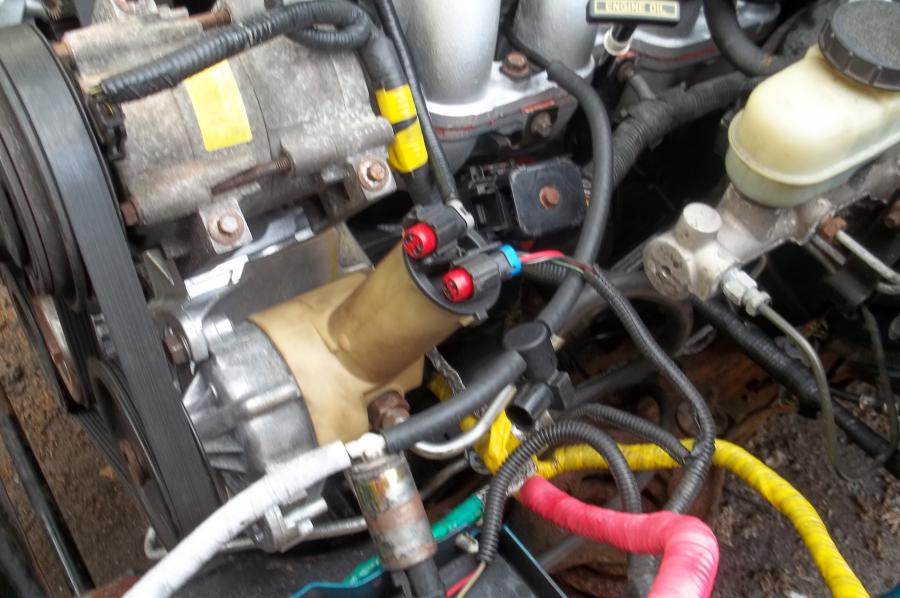

There are two identical connectors - one of which belongs on the canister purge flow sensor, and the other..... I cant find a home for. One is grouped with the connections for the power steering sensor and the canister purge solenoid and this branch leads from the drivers side fender skirt. This seems the logical choice, but its twin is homeless right now and reaches the sensor comfortably. This second connector branches with the AC Compressor connector and as far as I can see, every other connection in range is good to go.

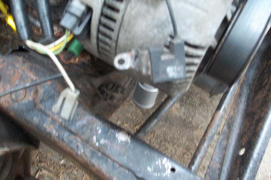

Also, branched with the connections to the alternator there are two that escape my memory. One is a single-wire gray connector and the other is a weird, black, U-shaped block with an eyelet at the end to bolt it somewhere....?

grey connector in second pic goes to alternator, and black thing in same pic goes to one of the coil bolts.
The single wire grey plug looks to be part of the voltage regulator assembly, it should plug in below the plug that is already in on the alternator.
The U-shaped block is you RFI capacitor, ground it to the body of one of the ignition coils. Just take one of the coil pack hold down bolts out and put that eyelet around it, then reinstall.

Anyway, the plug that has red, black and white, and black/green is the purge sensor.
I need to know the colors of the wires in the other plug to even guess.

Awesome you guys thanks so much for your replies!! I figured out the first two now but brilliant to consult the wire colors! The connector with the blue base is for the purge sensor and the other is for a pressure switch on the filter/dryer on the AC line between the condenser and compressor. I am eliminating the AC and didn't install the condenser or manifold/lines to the compressor, resulting in the confusion. I'll get the others hooked up tomorrow and I should have it up and running for the first time since beginning my "tune-up". You guys have put together a super forum here and I have gleaned a ton of info that has helped me immensely! Thank you very much!
