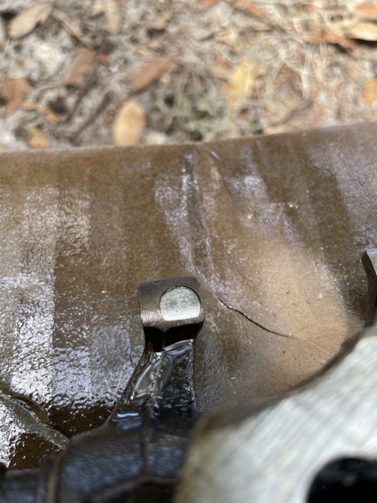

You could say things are worse- found a collapsed lifter, and half of the others missing their nylon hats…Will be pulling heads. here’s a shot of the average rocker arm valve-side tip:

Pulling heads? to replace lifters. Is that necessary on the 4.0. I can take the plenum off and access the lifter bay on my 2.9. Are the head gaskets blown? Ive seen worse rocker arm contact points. looks a little tight? Little lapping and good as new. I would look at cam/lifter contact surface for wear.
If you pull the heads, get them magna-fluxed!!
Yup, the lifter bores are partially covered by the cylinder heads in the 4.0 ohv. I have one completely collapsed lifter, might as well replace all, along with head bolts, gaskets, rocker arms and push rods
