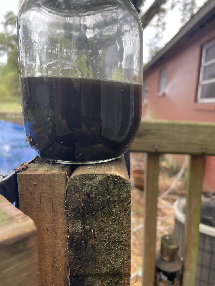

Running at idle, I get 32 psi fuel pressure. After shut down, it maintains 32 psi for about 30 minutes, but in an hour it drops to 20 psi… not sure if that’s normal or not. Dipstick looks like clean oil. Here’s a photo of sample as taken from oil pan.

I would pull the dipstick and put a drop of oil on my finger. If it is thinned out by fuel... it will spread real quick. You can just tell.
Strange... they don't make oil.
Sorry- somehow I’m not getting notifications of this thread, thought nobody cared 😞. Lol . I’ll post photo of fresh oil in a jar soon. It’s dark as heck!

Let that jar of oil sit for a day or two and it will separate if there are different elements in it. If there is water in it, it will separate almost immediately. If the truck sit for a length of time the fuel system will have to be cleaned out. You've probably got more than one injector screen full of debris and they are stuck open. pouring alot of "cleaners" into the fuel tank will just make matters worse.
The photo of oil was taken yesterday, but it has sat still for about three days now… Also, I removed the gas tank when I had the bed off to paint the cab, and installed a new fuel pump, fuel filter, and a section of hard plastic fuel line that had split causing a leak. I also replaced fuel injectors and regulator at that time.
