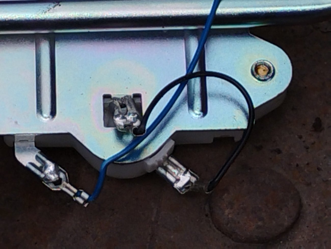

Here 2 more pictures of my fuel pump assembly. You will see what I found wrong with mine. I'm still playing around trying to get my gas gauge to work right.
Gas gauge not working properly
In that picture you see 2 wires for the fuel sender. Note the black wire goes from the sender unit to the plate the unit is attached to.
In this picture you see the in tank side of the point where the wiring harness plugs onto the fuel pump assembly.
The manufacturer of the fuel pump assembly thought the ground voltage or whatever it is would go through the metal of the pipe and the plate that the Sender unit is attached to, to the ground plug.
However the pen that goes through the upper plate that you see from the outside of the fuel pump assembly when it's installed has plastic around it and therefore the signal can't go through it.
I've also figured out that the metal that the pipe and both plates, the 1st one that the Sender is attached to and the 2nd one at the top that you can see from the outside when the assembly is in place are all 3 bad conductors.
This is what I've found wrong with mine.
I don't know what yours is got going on.
I'm just trying to help once again.
I hope you figure it out and wish you luck.

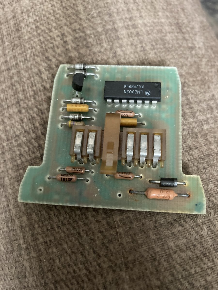

I would investigate FIRST before the sending unit, the slosh filter board in the dash.
It is located next to the gas gauge, must remove the instrument cluster, a small circuit board about 1.5 inch by maybe an inch with a simple PC board. On it will be an electrolytic capacitor of a value, likely has exploded. Replacement will fix, typically. It snaps in with a brown plastic spring clip that is part of the connector.
The better solution is to bypass the board. Multiple ways to do. The easiest is to cut the traces and solder a shunt into the circuit or the super cheapy is tape over connectors . It will simply redirect the sending unit signal past the board and into the gauge direct. The gauge will work great, bob a bit but will be outstanding.
There is a group of 3 pads and group of 2. Insulate in any way the THREE and BOND/SHUNT the TWO.
I literally severed the spring pads at the board on the THREE and the TWO, then soldered a bridge wire at the base of the TWO to short them.
make sure the THREE are not making any contact to the board when done. The TWO can contact no issues, the short you create will bypass the board.
You can also cut the two wires and splice in any form your comfortable with, in the harness. Then remove the module completely. It is better, IHMO to leave module in place and bypass on the board.
there is at least 403.2 more ways to carry out the bypass. The gist is, short the cluster of two pads and defeat the three......
Lastly, oxidation and/or the filter cap could be your issue. Clean the contact pads well and test. That may be the only issue. My gauge was dead in 2020 on Frankentruck. I replaced the cap with a sundry test bench cap and that fixed it for a while. A year later it failed again and I said never again. Bypassed and trouble free for 3 years. Cap obviously vented in the case of the OE cap. Second failure was not diagnosed. I was pissed about taking cluster out AGAIN for the 900th time on all sorts of other issues....
The technical name is SLOSH MODULE.
Front and back.

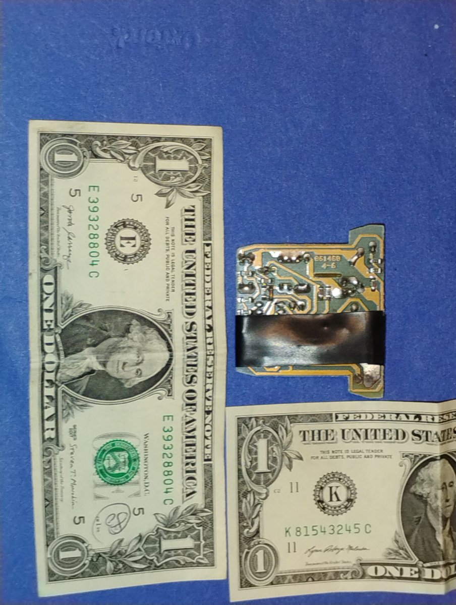

Dollar bills to give size perspective.

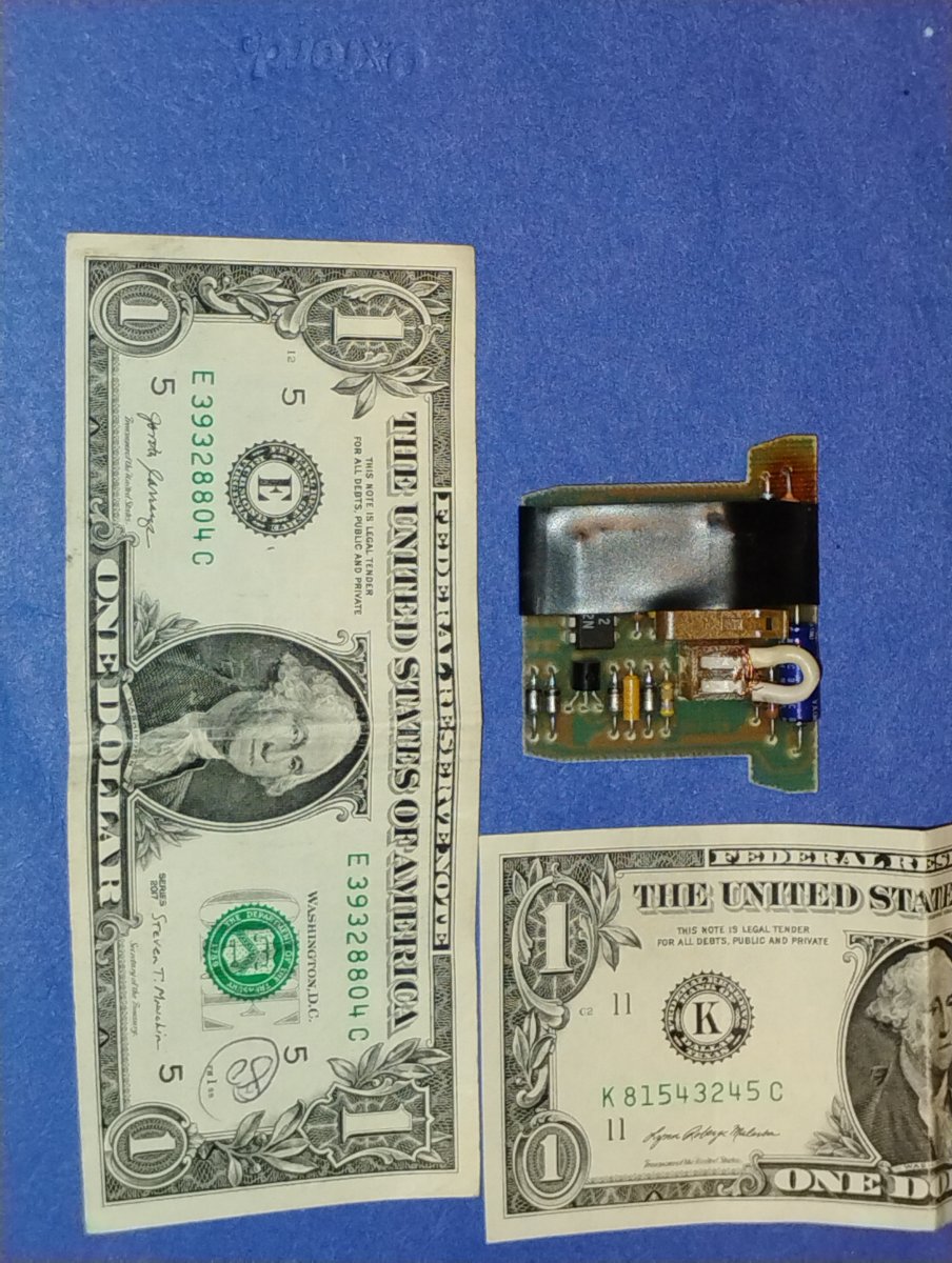

A SLOSH MODULE that's been bypassed.
Once again dollars for size perspective.

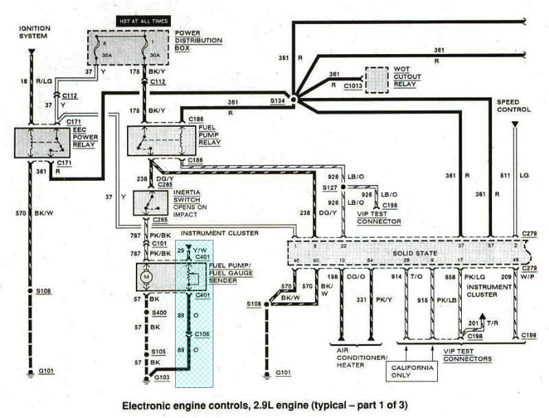

DC power has to be a closed loop and here is the full skinny.
Batt+ goes to the instrument cluster (one lead of the fuel gauge) then exits the 2nd leg of the fuel gauge on a Y/W wire heading to a switch (to toggle tanks) then to the fuel sender in the tank, then ground (and ground back to battery -)
