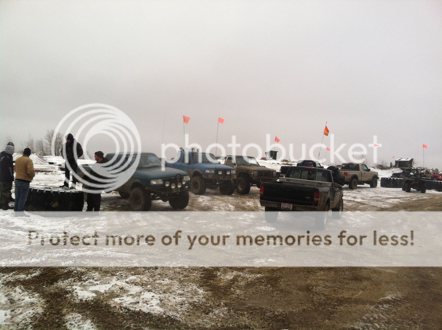

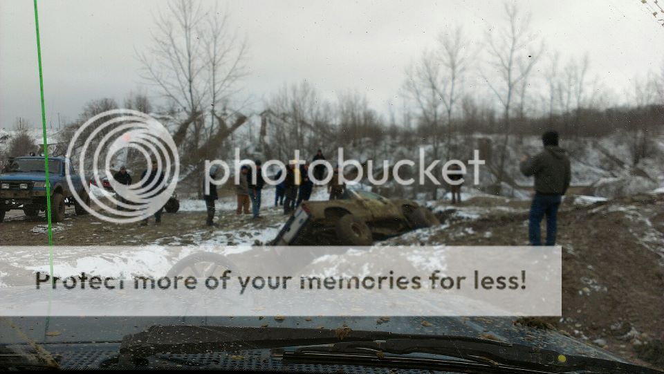

Rolling out there. We left the house at 5am. This is around 8am where me met more people. We got to BundyHill around 915am.

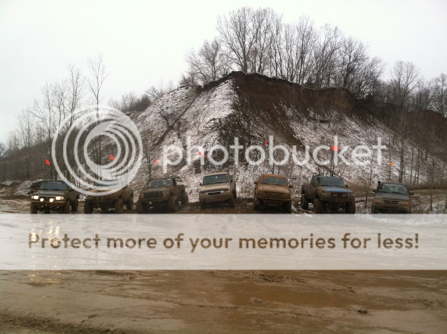

The Ranger Group

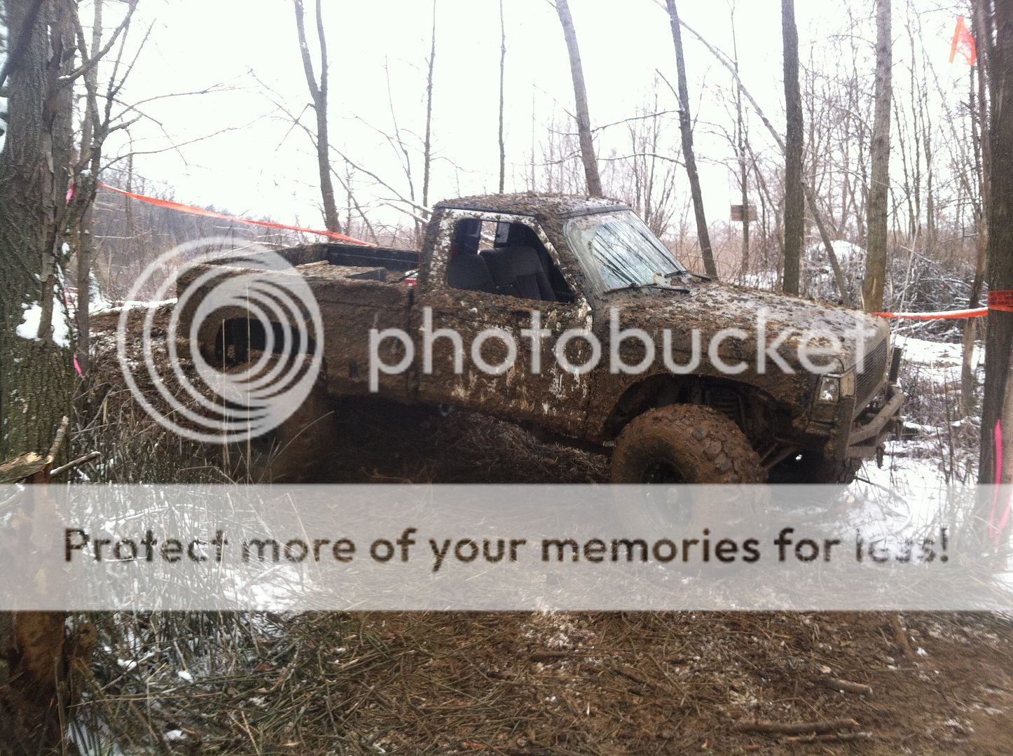

When I broke

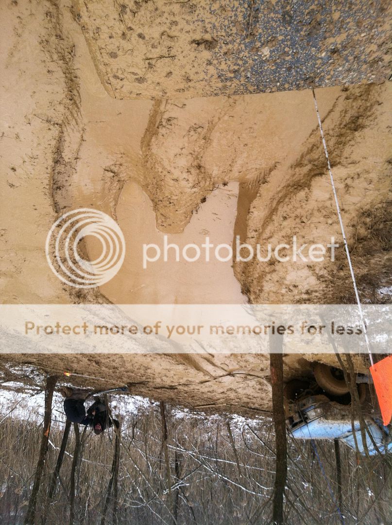

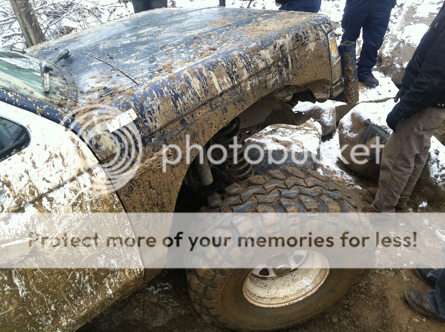

The hole that may have killed my 2.9. This is after we pulled the drivers front shaft out. I wheeled the rest of the day with only one

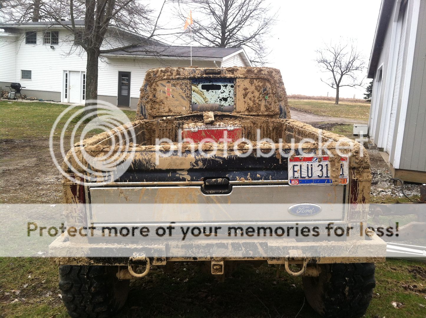

The next day... and how it sits as of 3-22
