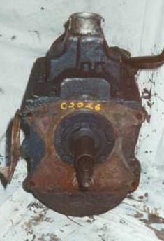

You must have scored that from one of the real early TK 4/5 speed Ranger transmissions, right?
I think it'd be possible to build an adapter plate. The bellhousing would probably hold up, the V8 bellhousings I referred to earlier are aluminum as well.
The problem you run into is finding a flywheel, a 10 spline clutch disk AND pressure plate that fit said flywheel, and the proper release bearing - the clutch disk being the hard part - those Ranger clutch disks were 8-7/8 diameter and to my knowledge, the smallest 10 spline V8 disk that would work with the NP435 is a 10".
It's more of a matter of it being (a lot) easier to use a V8 bellhousing and clutch like Rulebreaker did.
FWIW, here's the front of an NP435.
