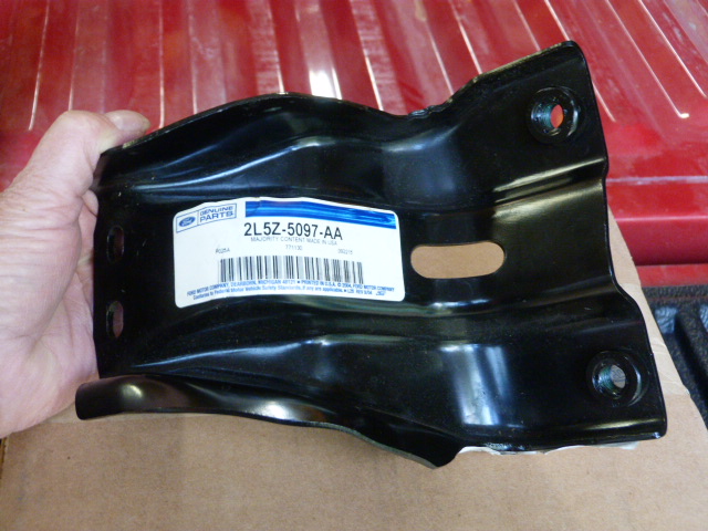

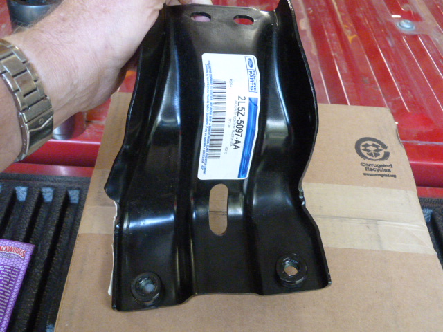

OK, I had luck finding the bracket, the little Ford guy that sits in the corner and makes up names, calls it a gusset. At any rate, here is a photo of the bracket, er gusset, along with the part number. Funny thing, on the label on the box, this was labeled, "Vintage Parts", crap, the trucks only 13 years olde!!

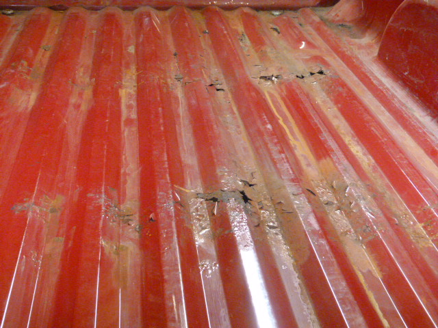

Photos of my bed from above as well.

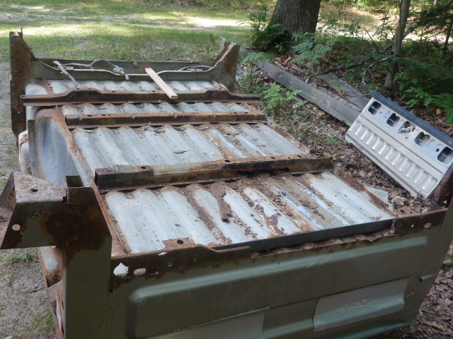

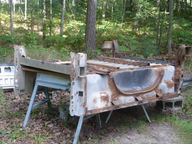

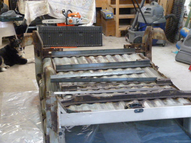

Picked this bed up the other day, and started to work on it.. The junk yard removed the fenders for me so I could get it in my 150. Mostly just surface rust,except for the first two crossmembers, I'll have to rebuild those.
After pressure washing and drying, I plan to use Corroseal on the rust, topcoat it with rustoleum, then spray the snot out of the whole exterior with rubberized rustproofing.
Good news, I was able to break all but one bedbolt loose, luckily it's not the one over the gastank.

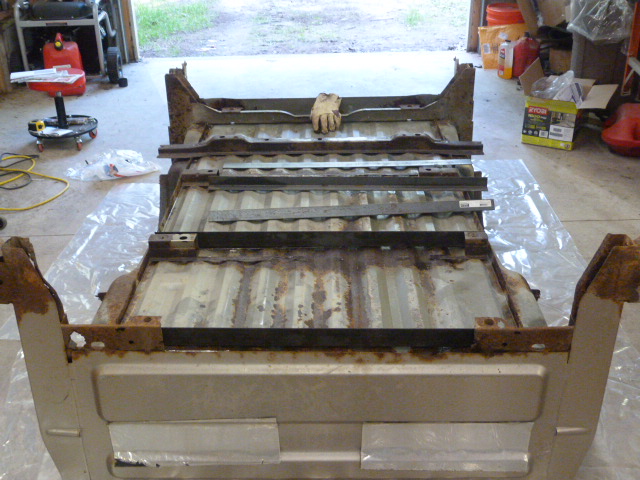

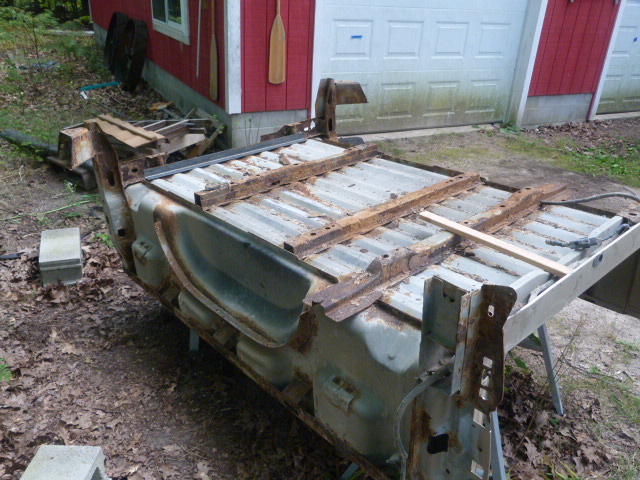

Still looking pretty rough, but got the rotted sections of crossmembers cut out, power brushed with my grinder, power washed and hung up to dry. Moved it into the barn to hopefully use some rust converter today, and start fabbing up the new crossmembers.
My welder took a major dump on me the other day, so it looks like I'll bolting things together, then reweld later on. It's getting too late in the year to be screwing around now.

Your dawg looks grouchy :D Great work, hows the left frame rail?
LOL, ya, he looks like that sometimes, he really isn't though.
I haven't taken the original bed off yet, but from I can see rummaging around under it, my frame looks good except for that rear gas tank strap mount. Needs to be cleaned up and repainted, hopefully I'll get into that this week. The Ranger is my daily driver, so I plan to have it off the road for a minimal time.
That is, what I "plan".:D
