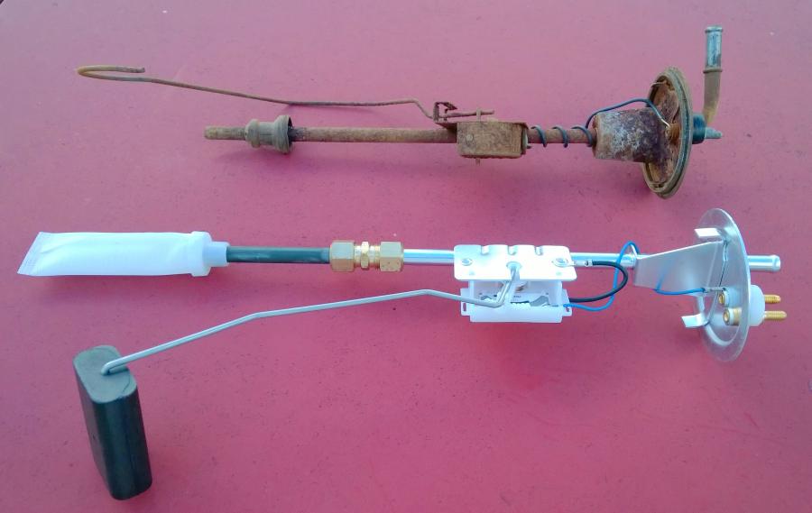

Modified Sending Unit
We were able to overcome this problem by purchasing a Spectra Premium FG72A (for a 1983 E-150) and extending it with a piece of tubing and a compression fitting. The gauge is a little bit off, but it seems to work ok.

wow! very cool.
