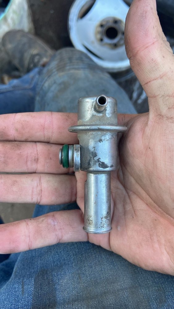

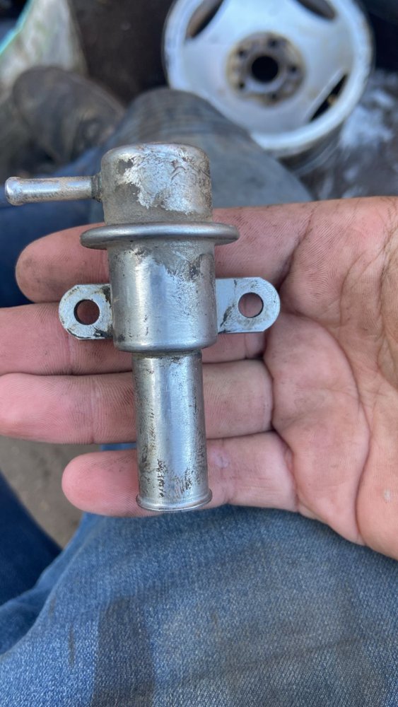

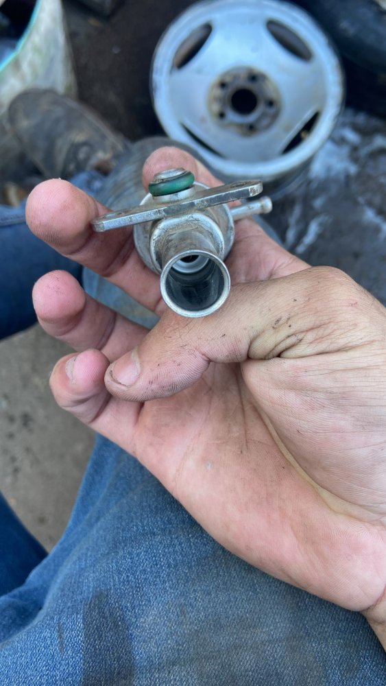

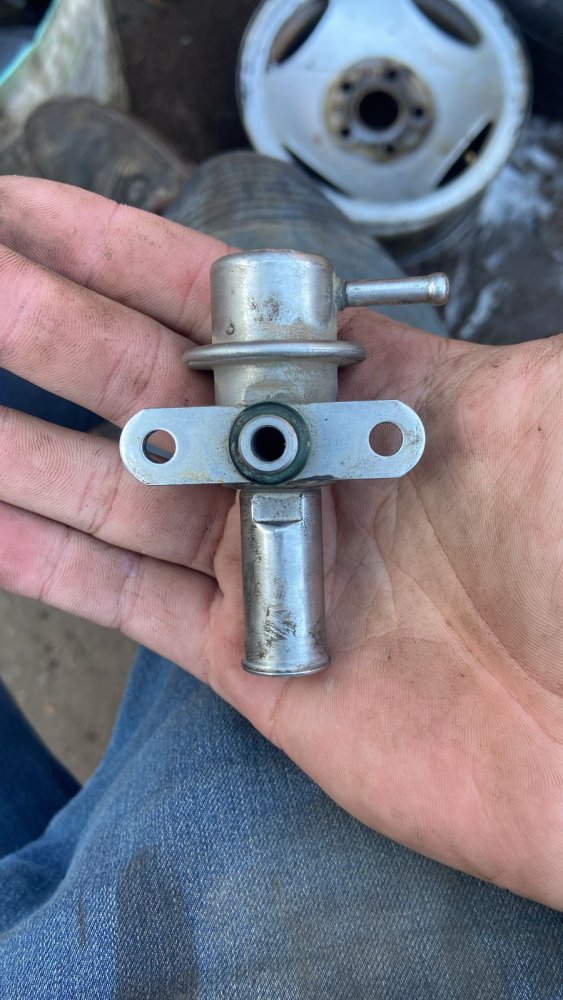

I’m looking for the most obsolete part ever built I’m guessing it’s the fuel injection regulator/damper any ideas in phoenix az

Haven't seen that exact one, but its a fuel pressure regulator. If you can smell gas in the vacuum line its FUBAR.

Dampers were used on Rangers in 1998 and up when the FPR was moved to inside the gas tank with the fuel pump, that's also when fuel pressure was raised to 60psi, from the 1997 and earlier 35psi
That damper was only used on ‘98’s for a short time. It’s no longer available from ford or aftermarket.
Part numbers:
Standard FDP22
Airtex 3g1007
Wells FD208
You may be able to track one down. I wish you luck.
