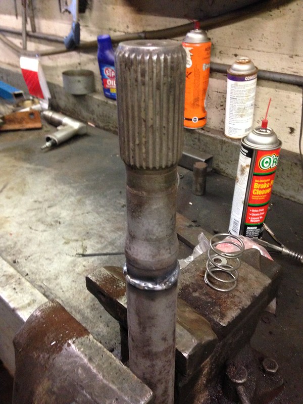

Which mid did you do? One method uses a weedeater spring on the outside of the shaft, pushing the two sections apart
The other method uses an jnternal spring and I've read of people having an issue with some cap popping out of the end of the shaft. I did the external spring. Pictures way, way back in my build thread.

External, it's linked above.
Just pushes the inner end up to the cross-pin.
Spindle bearings aren't too bad to do, sounds like it could be that
The welding on that link on the shaft isn't necessary, the clamp on the boot in the notch is plenty, that's what I've done and it's worked fine.

Then I got to thinking wondering is acting as a thrust bearing at the knuckle with the spring thing. I welded mine.
I'd seen that and wondered if it was necessary so I skipped it, doesn't seem to be needed... but that's not causing the noise... honestly I haven't paid attention in a LONG time as with no carpet just a full width rubber floor mat not even the factory rubber floor and the shift boots not even attached to the floor I have a bunch of road noise, everything is still attached so I just keep going, I need to drive that dumb thing more, it's been parked since like May just because gas has been expensive... maybe I'll clean the bed out this weekend and drive it next week...

At the wheel end there is a gray plastic shim (washer) at the base of the stub axle (behind the spindle) that the axle (with c-clip eliminator spring) is pressed against. This shim spaces the axle the correct distance for the seal to function properly (I thought I had a pic of this, but can't seem to find it now :icon_confused: ).
That area needs to be slathered with plenty of grease. If it's dried up (the plastic washer worn down or melted), it certainly could become the source of a grinding/scraping noise. However the spindle needle bearing is still a good possibility too. Either way, the spindle needs to come off to get at it.
And agreed, the welding is completely unnecessary.
IMO, Jim should remove that detail from the article since it can cause a stress riser on the shaft, potentially leading to a future fatigue failure.
