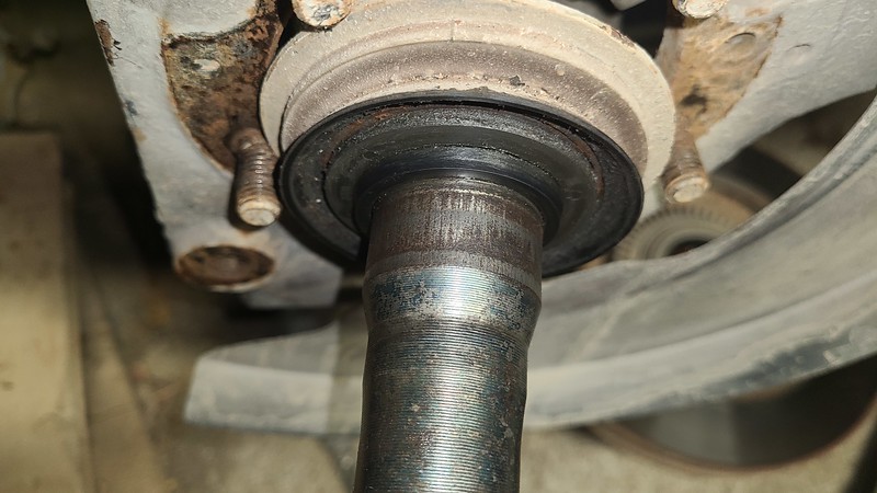

So I slipped it apart.
Less than perfect
Spindle cleaned up nice though.
Grease on the shaft was dark but not the groady orange color.
Bearing looked ok, grease is dark but there and not dry at all.
Anyway, plastic washer is there and greasy so i did that right. Shaft where the spindle bearing runs is on the rougher side, kinda wondering if that is the cause. This axle was EXTREMLY neglected when I got it, I had to break a seized u-joint apart to get the knuckle off, one ball joint had actually worn a hole in the cup etc. I suppose I figured it I would try it and see how it went... and then it took me 5 years to get a driveshaft to fit in it full time and between here and there I forgot.

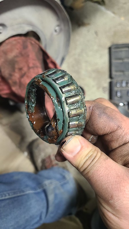

Wheel bearings look ok for the most part, oddly the grease in the rollers is still nice and green.
Current plan is to touch up that bearing surface with a little emery cloth, repack the wheel bearings and try to clean and regrease everything else and see if it makes a difference.

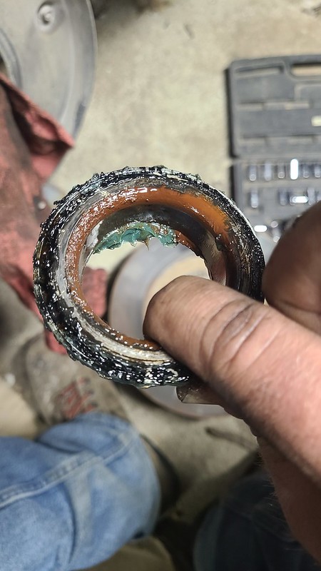

that last bearing picture looks like the inner race is rotating on the spindle more than the rollers roll.
The grease was filthy with water so the spindle is kinda trying to flash rust a day later, I dont see any signs of a bearing spinning though.
the rusty grease is a tell-tale sign of fine metal particles.

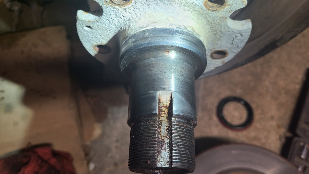

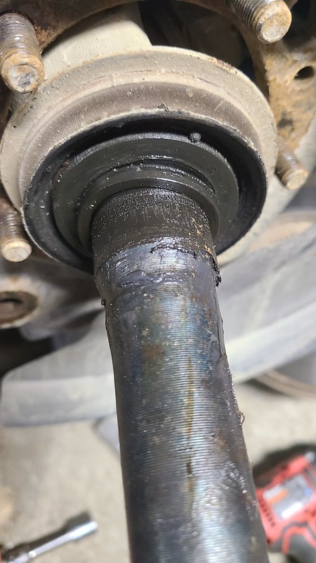

what does the bottom of the spindle look like?
I agree the top looks good. But check the bottom since the weight bears down in that direction. If bottom looks good and the bearing has a good fit, go with it.
I forgot to get a pic this morning, I can see where it has been turning some on the bottom. Not much wear, almost like a change from the usual machine finish to more of a polish. Can barely catch it with my fingernail.

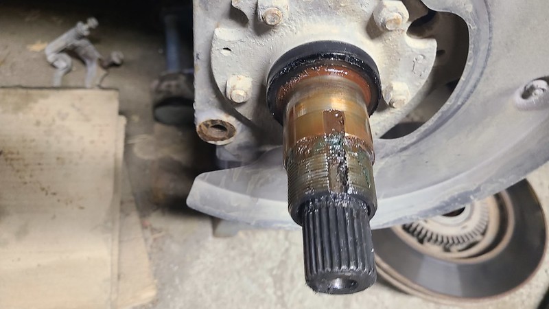

Anyway back to the reason we are here, found my spare axle shaft in the barn. Where the spindle bearing runs on the shaft is dang near perfect on it... so I think I might throw a new ujoint and seal kit on it and promote the one that is in the truck to spare.
Ran dad down in town today and showed him the spindle. He said more or less said "I wouldn't risk it, but I don't know if a new aftermarket one would really be much better"
I have a good used spindle with no wear at all so I figure it would be good to keep the one off the truck around for an emergency spare. Of course when the pinhead pulled the spare spindle that is probably going on the truck they had to hit it several times on the seal area so I have that to deal with... maybe a speedi sleeve I dunno. It is almost worth buying a new spindle to just not have to deal with replacing the POS spindle bearing again.
