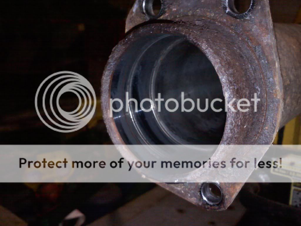

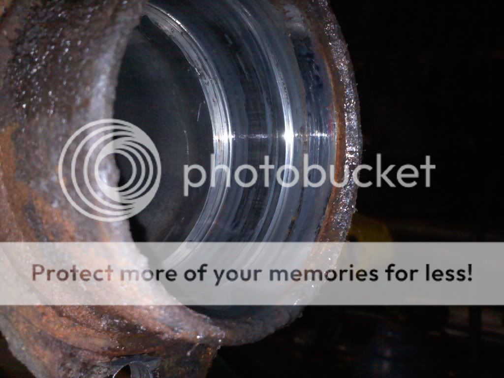

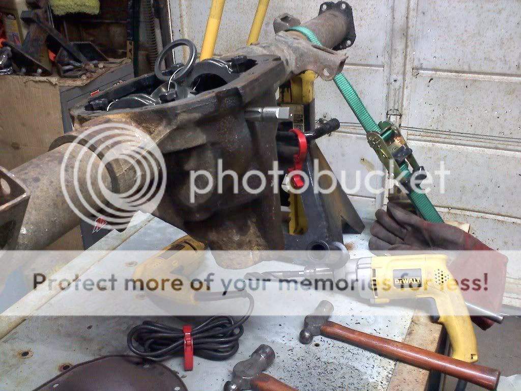

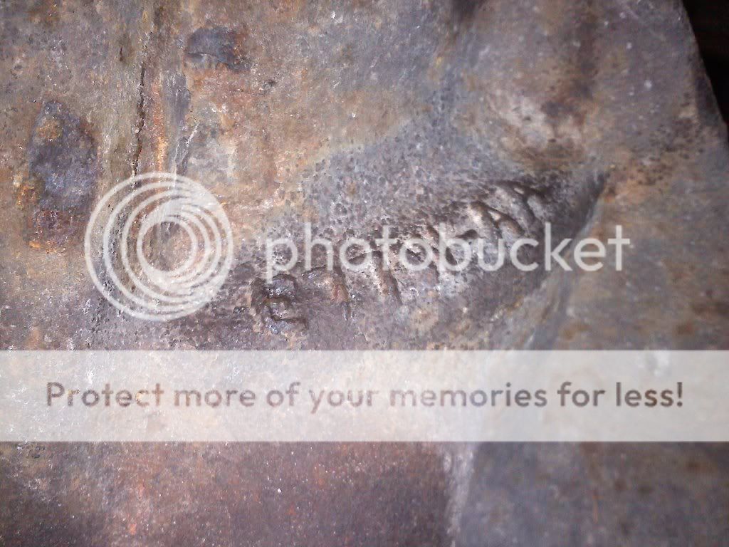

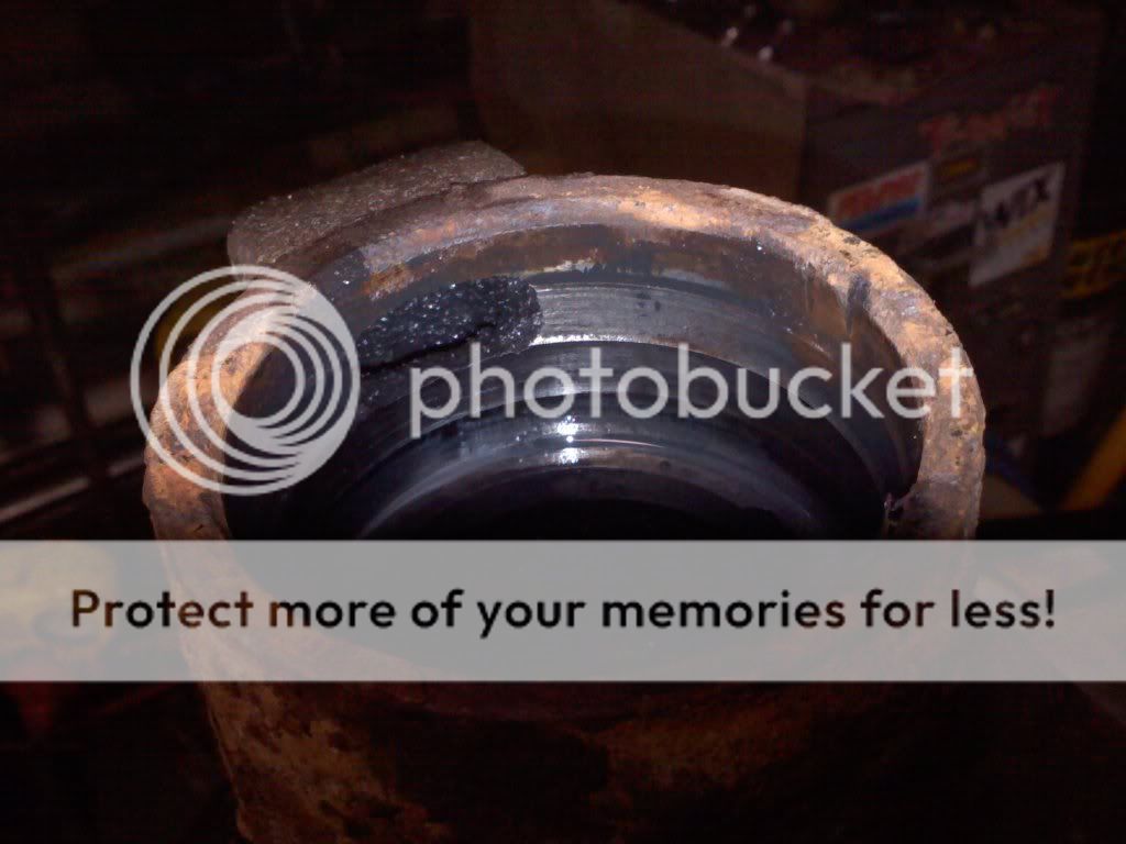

i took some pics of the bearing surfaces in the axle, it looks like everyone of them spun but they were all pretty tight fitting when i was taking them out so maybe those are just marks from pressing?
this is hole for the outer pinion race and seal
ForOffRoadDriving's 94 Ranger Build
this is the drivers side axle bearing hole
passenger side

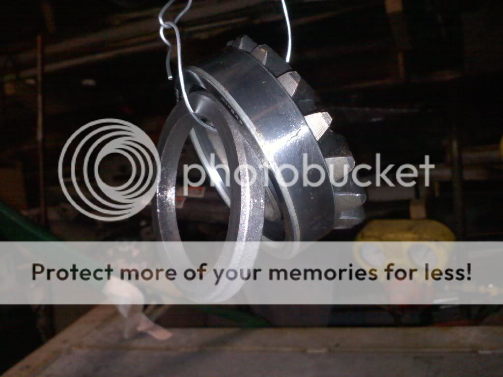

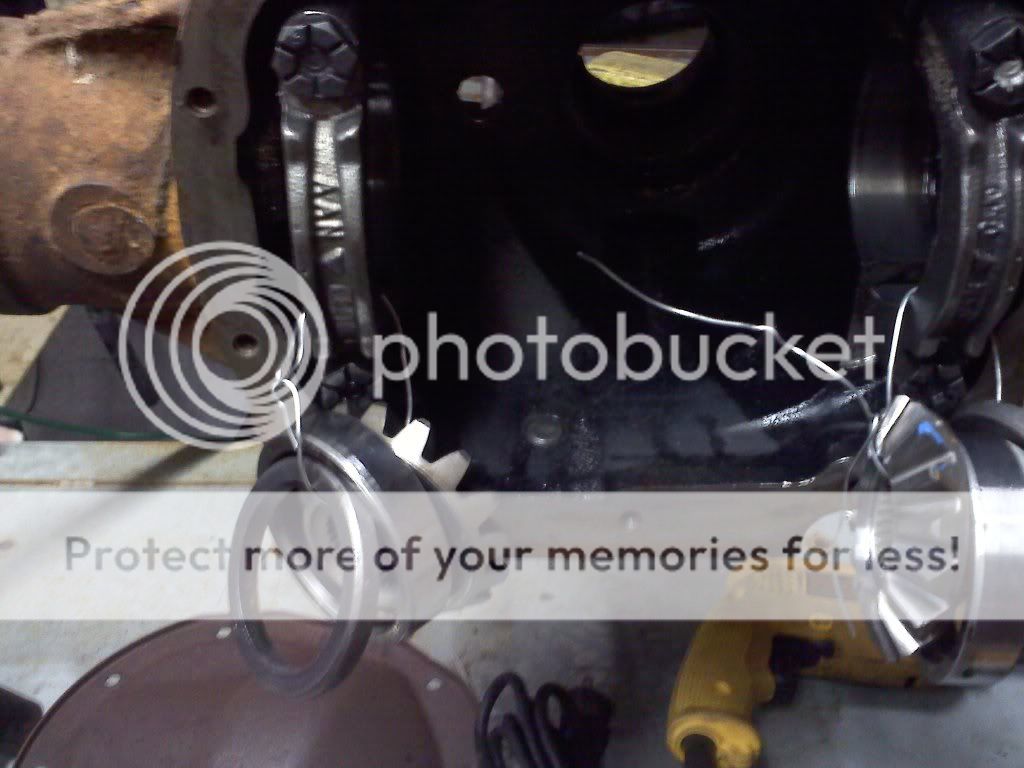

heres the spiders and spacers and carrier races, i expected to find some thin shims on one side or both sides of the carrier, but there werent any?

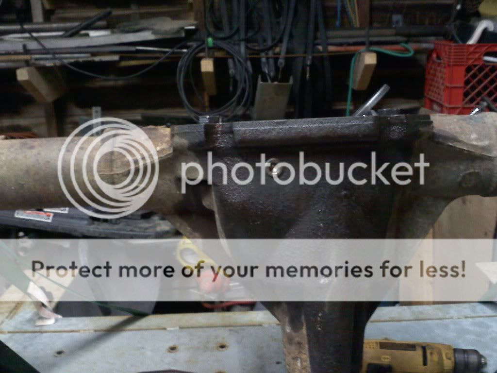

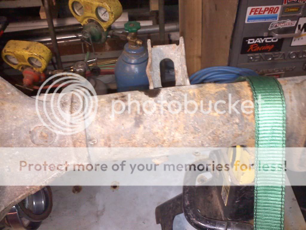

heres a bent shock tab, probably from handling it after it was torched out at the junk yard?

some kind of casting number i havent been able to decode

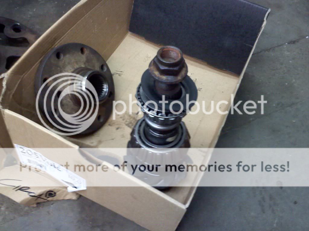

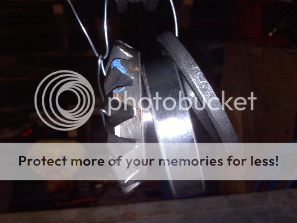

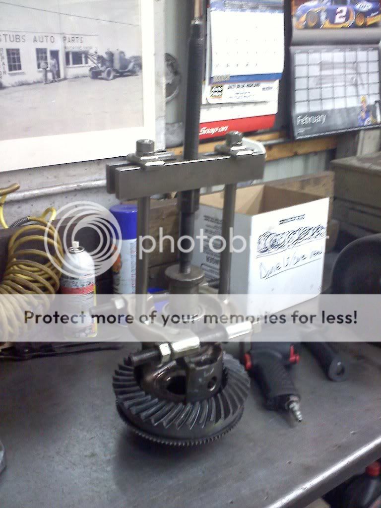

i got the pinion gear pulled off, but the carrier is giving me alot of grief!
once i tighten the bearing splitter down it becomes the same size as the ring gear so i cant put the blocks under it for support.

looks good man. reason you didnt find any thin shims behind the carrier bearing race, is that there is only the one BIG shim. Instead of using multiple shims, when these axles were made, they just machined one shim to the correct size, hence there only being on big shim, and not multiple small ones.
thanks nathan, thats what i was thinking because why would ford pay a bunch of guys to set these up by hand? so if my contact pattern is way off ill need to use the shims i bought to take the place of the machined-to-fit ones?
if you are swapping to a different ratio, than yes you will need to use different shims. Remember too, that if you put new carrier bearings in place, you will need to add more thickness than the total of just the originals, in order to make sure you have enough carrier bearing preload. Those new bearings will loosen up with time, and if there isnt enough preload set on them during installation, youll be changing them in the future. If you have any questions feel free to pm me anytime.

when i got to work i found out that there is a special tool for removing the carrier bearings, and it works much better than the press!

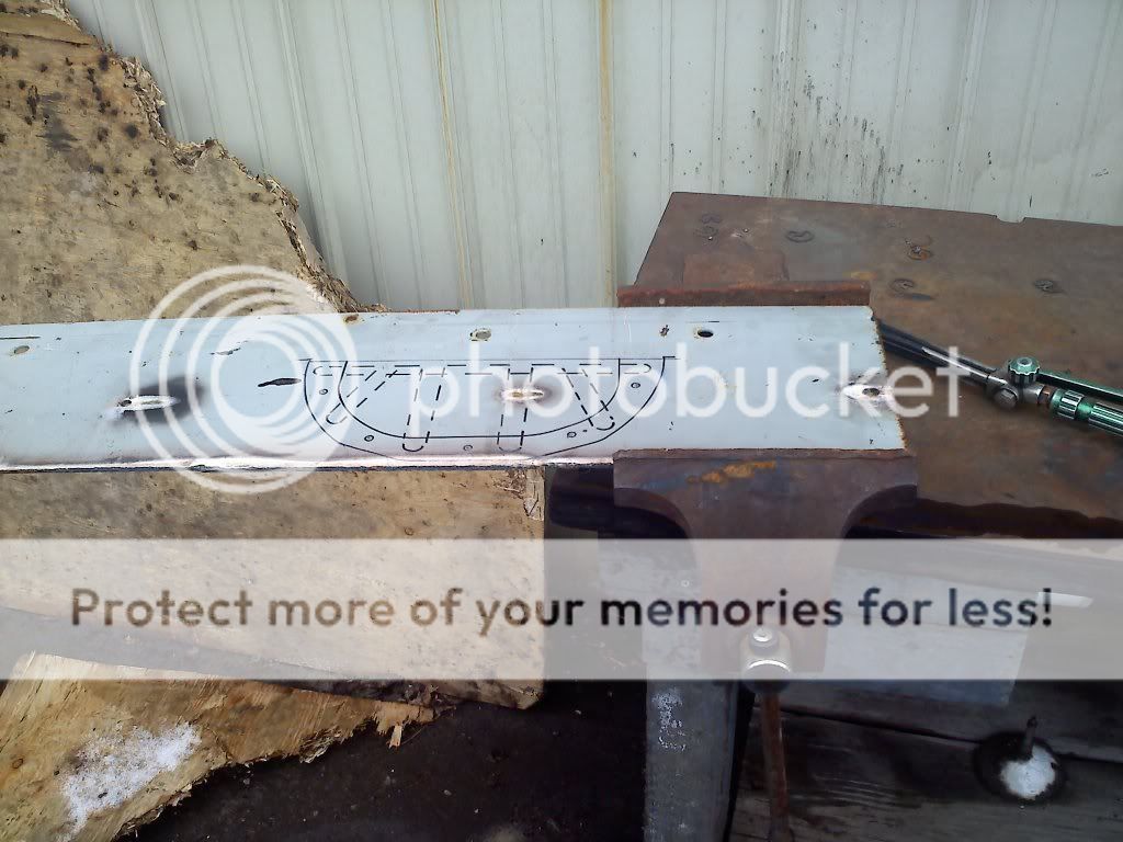

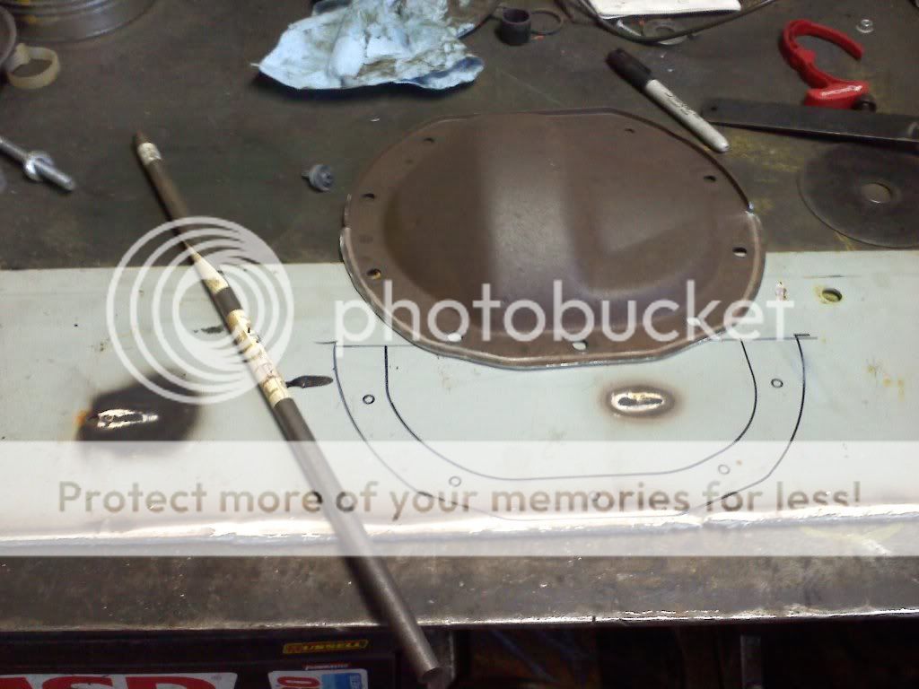

i also started making templates and gathering rod to make my diff cover bash guard.
the dotted lines are where i plan to run the 1/2" bar stock for my bash guard.

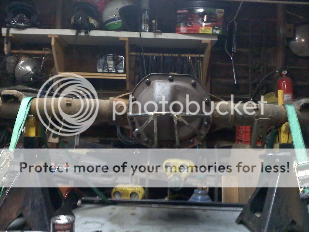

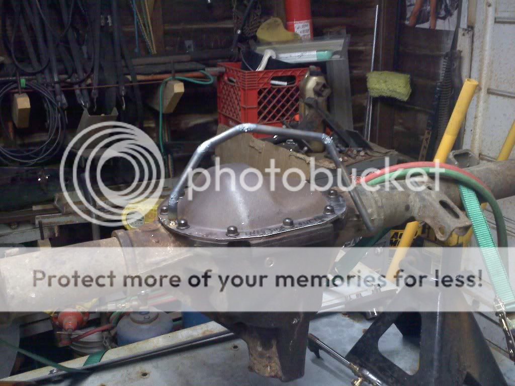

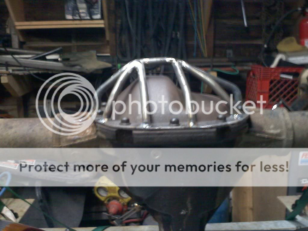

i got the axle cleaned up (used a wire wheel on my 4-1/2" angle grinder but still need to get into some of the nooks and crannies with a drill pwered brush), and i made the bash guard. i was a little dissapointed in the positions i had to place the rods in, but it turned out ok and with minimal warping.

nice job man. Planning on making basically the same thing when i get a new diff cover. no real reason for it but they look damn cool.
i added some more gusset work to the guard last night, then finished cleaning things up and slapped on some paint.

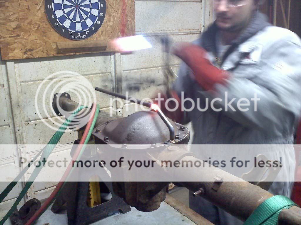

heres the wrench that i used to bend the rods on the guard after the torch ran out of gas
