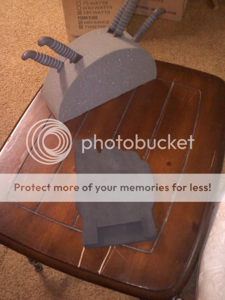

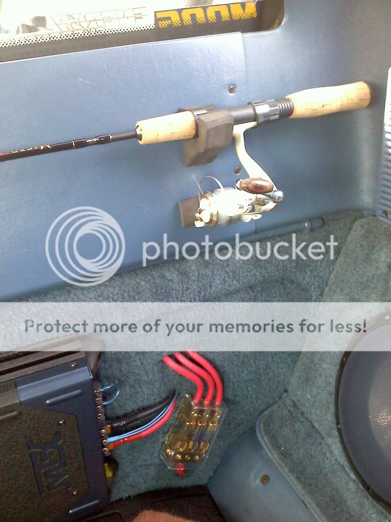

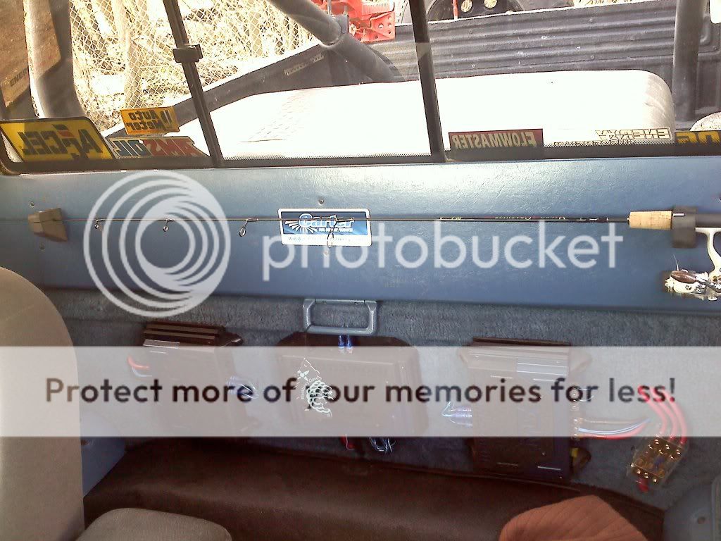

i wanted to work on the gears some more last night, but it was rainy and cold so i just stayed inside for the night.... but that doesnt mean nothing got done. with spring finally gettig here its time to pull out the snow scraper and put the fishing pole back in the truck, but i dont want my pole to get smashed by cargo so i made a pole holder out of a foam finger.
