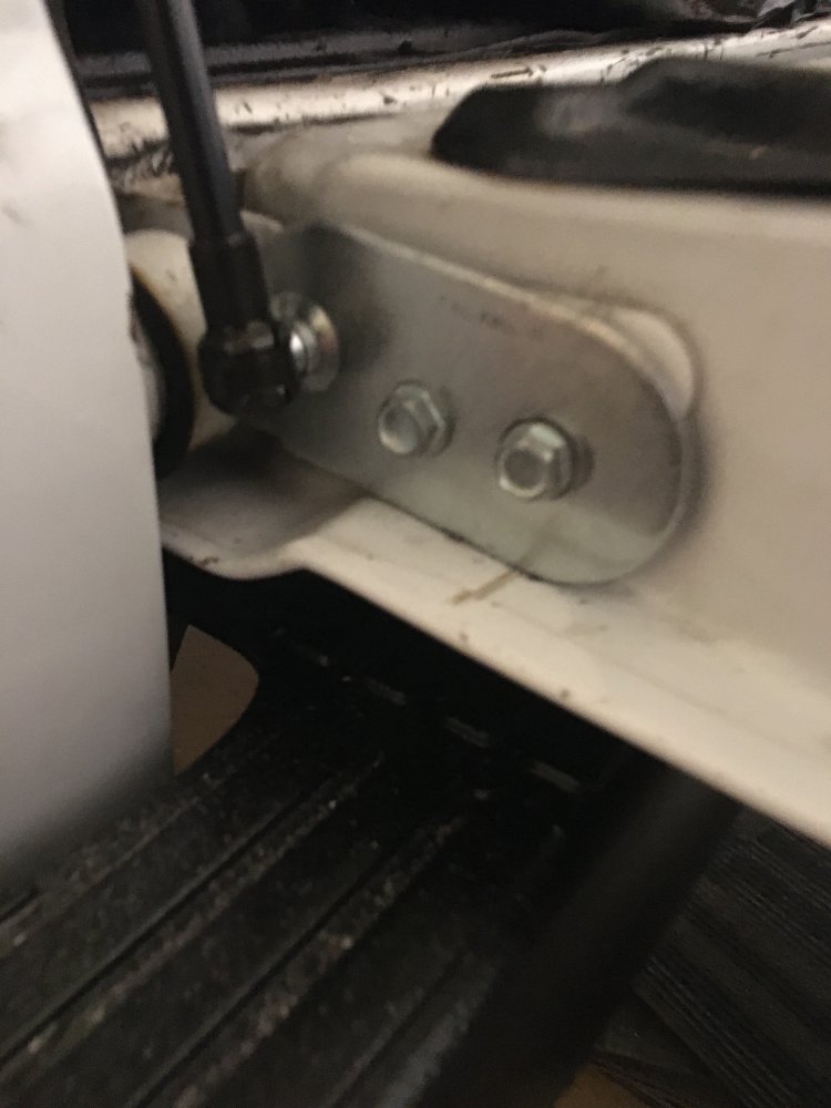

Steps 1:
Ford Ranger Tail Gate Assist DIY
Drill Holes for self tapping screws, then attach plate with screws as seen in photo

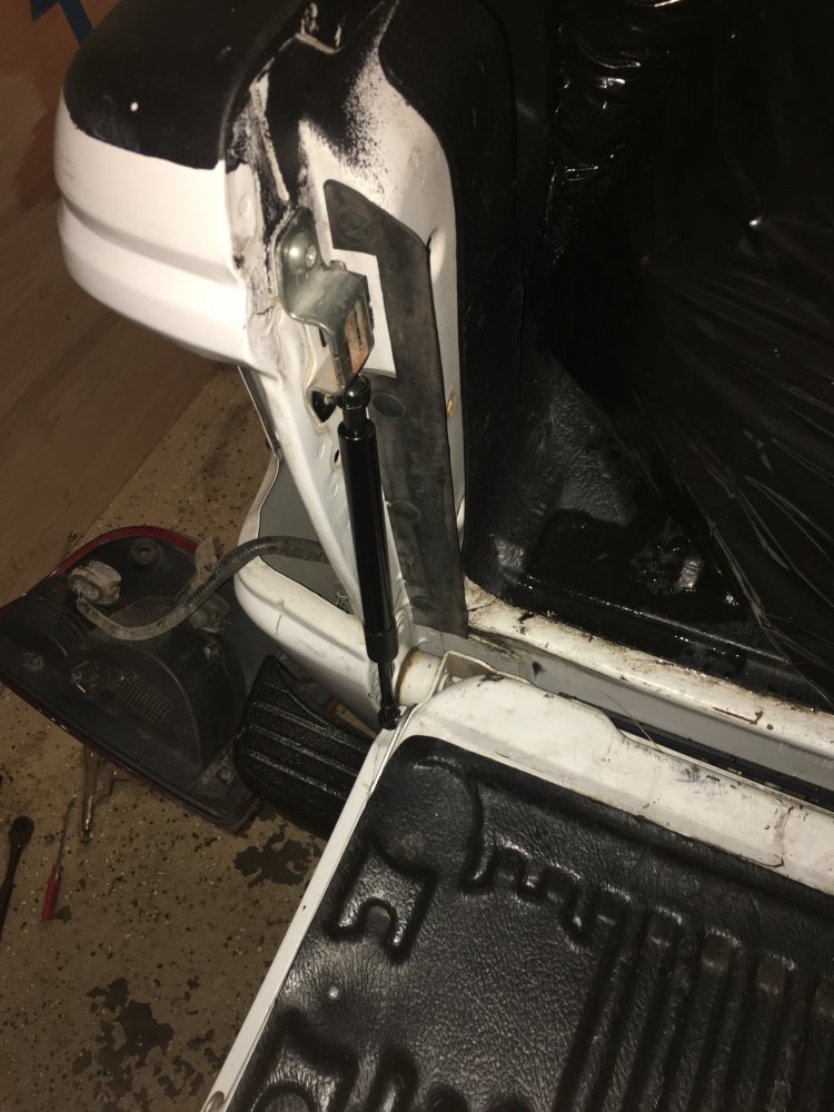

Steps 2:
Remove the driver side brake light, Then remove the bottom bolt holding tailgate support wire, then with vice grips grab the bottom latch square nutplate inside brake light housing and yank it out.
Steps 3:
insert the small round ball for suspension, then add nut (not included) to back side.
Step 4:
Add suspension to the 2 round ball, and your done
