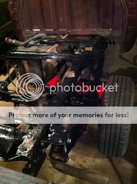

Making good progress! Here are a few of my latest pics. I'm waiting for my front leaf spring bushings to show up from Rock Auto, so in the mean time I'm painting and replacing all of my parking brake cables.
looking good! :icon_thumby:
Wow, yours is looking great!

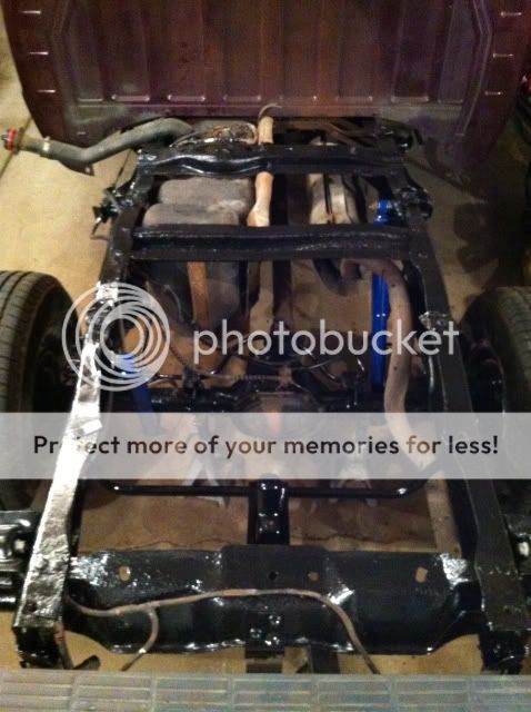

Today I did a little more painting, installed the shocks, installed my new parking brake cables, and lastly tightened up the front brackets. Oh, and I pulled the diff cover. I figured after 200 some thousand it would be a good idea to change it. Here's a few photo's of how it's looking now.
For those that have replaced leaf spring hangers...
The cables aren't sitting right until I get that bushing installed and tightened up
