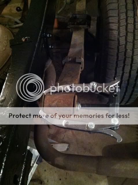

I was able to work on the Ranger for the first time since Christmas Eve and fortunately I was able to make quick work out of removing the leaf spring bushings. I used a 2 jawed puller and placed a bolt with some washers that we're approximately the same diameter as the bushing, and they came right out. Hopefully tomorrow I'll work on it for another hour and start the reassembly.
Good work Randy! I really hadn't planned to replace my leaf bushings, but maybe I will, since it would be a good time to do so. Thanks for the pics! I am itching to get mine started. Its kinda scarey driving with one of them broken! :icon_surprised:
