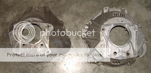

The Tri-Y headers will fit your heads, but you may need to do a little bit of grinding on your bellhousing. The '94/'95 bellhousing locates the starter and clutch fork at a lower angle than the Fox bell/trans, so they come close or touch the headers.
sn95 on the right

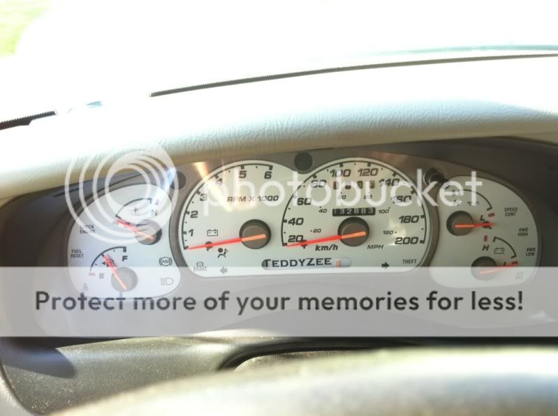

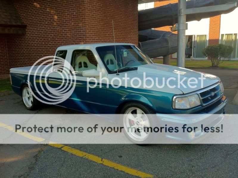

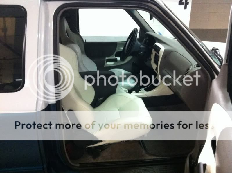

Guess I can toss some updates here. In the past year I swapped the seats, they're mounted on power Explorer tracks, painted the interior trim, and installed my "custom" Sport Trac cluster.

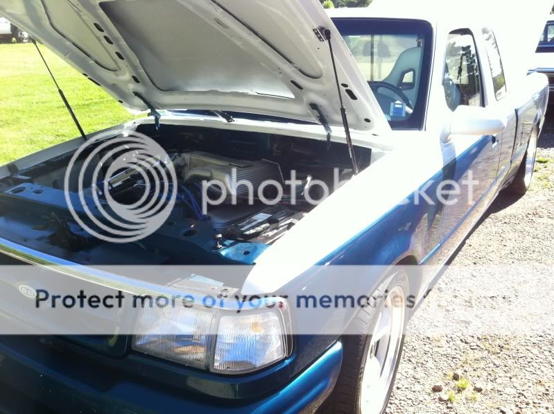

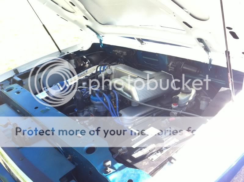

Finally finished my hood and painted/installed it and the tonneau. Stock Ranger hood that I grafted a Fox body cowl to.

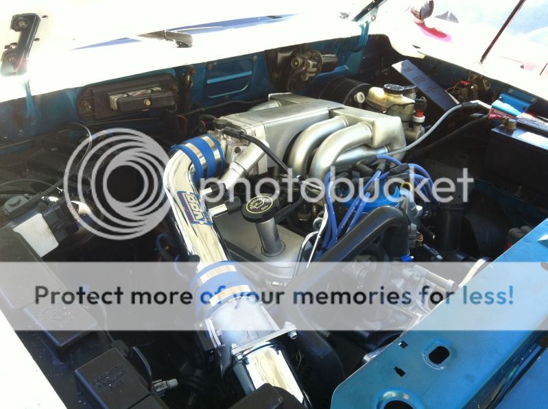

Swapped the GT40 tubular intake, found a cover plate for it... Not in the pics, but I have a new C&L 76mm MAF housing and 24lb injectors...
May be other stuff, but here are some pics:
