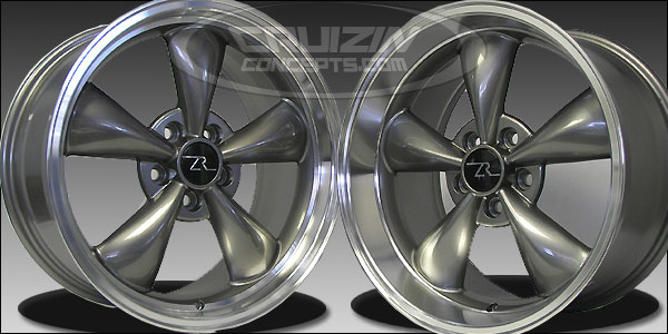

wheels
hey man could ya let me know where u got ur rims?
Yes, they are '94-'04 "style" 18" Bullitts. They came from ebay years ago (OEWheels, I believe).

Did you have any issues with those wheels firing the front hubs? I had to use spacers on mine. Doesn't look like you did?

Allpau, the wheels originally needed a 5/16" or so spacer to clear the hub, to fit the center cap. I now have a custom made hub to accept a Cobra 13" rotor, and I added long studs with a half inch spacer. The large spacer is to match the look of the rear wheels.
