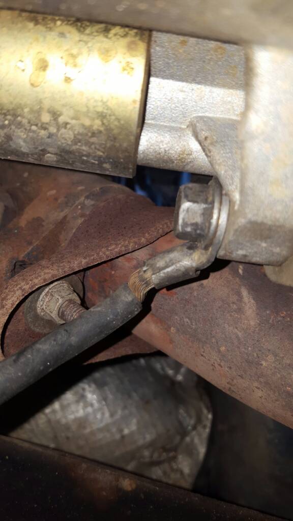

Recently my charge indicator light has been on sometimes, off sometimes, and flickering at other times. Its been changing more frequently when i go to high RPM (3500+)
So i figure it was probably a loose wire. i made sure all the battery wires were secure.
I traced the wires to the block, and noticed the fat ground wire running from the battery to the engine block was 'backed' out of its connector. But the wire itself didnt seem loose to where it would lose connection. It appears slightly corroded. Could this be it?
Not likely that wire causing the issue. How old is the battery and how cold is it where you are?
