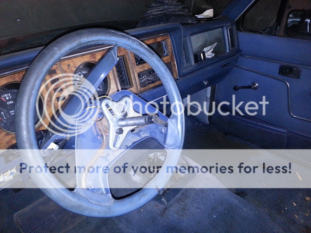

1. Remover the front cover of the steering wheel. There are two philips head screws on the back of the steering wheel.
2. Remove the two Philips head screws on the bottom of the steering column. This is where you need the long screw driver as they are recessed quite a bit. They are in the whole circled in red in the picture below.

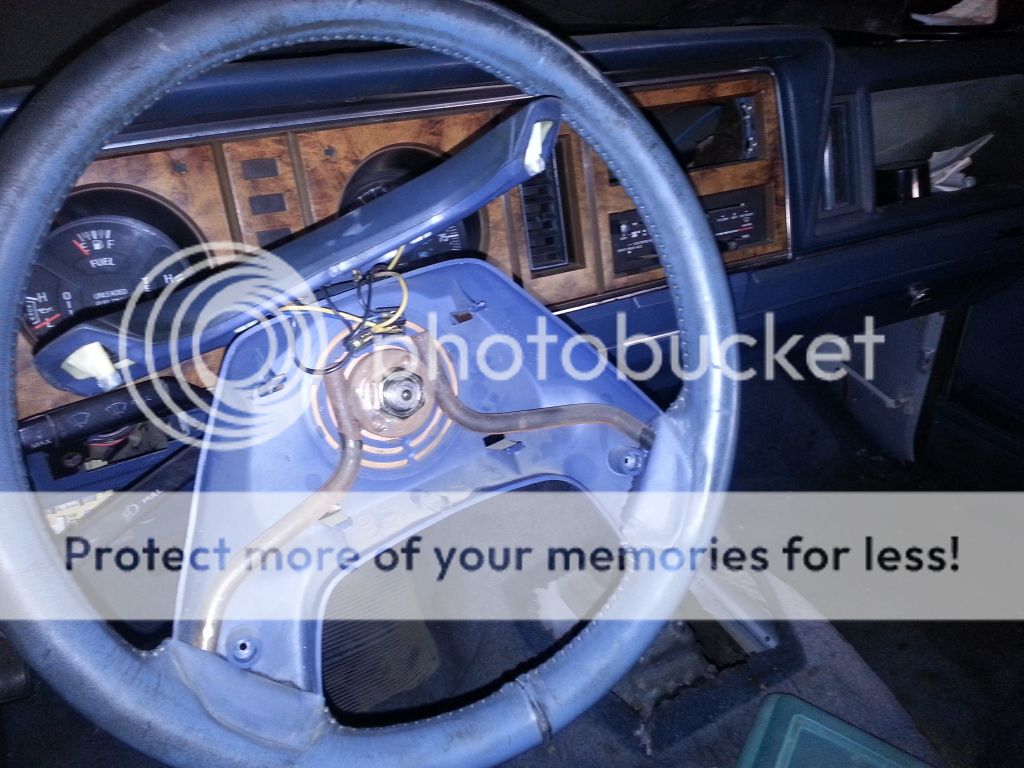

3. Flip the front of the steering wheel over the back, no need to remove any of the wires.
Use the 24mm socket on the ratchet to remove the nut holding the steering wheel on, mine was quite loose but other might be tight still from the factory, and attach you puller and use it to remove the steering wheel.

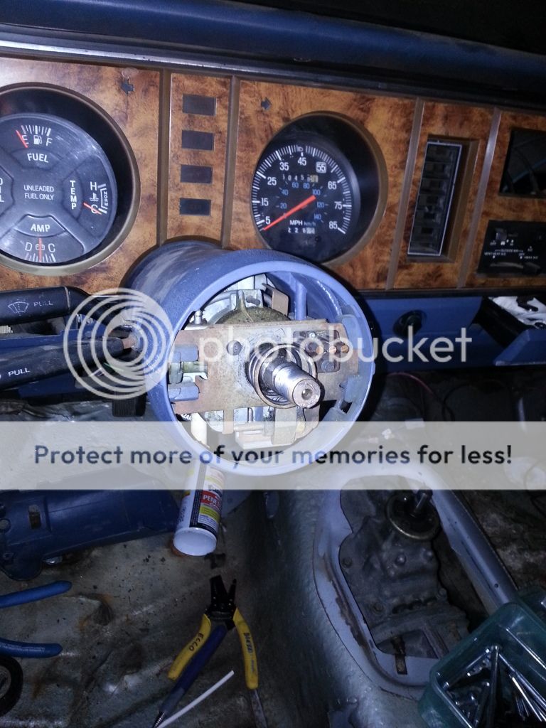

You should be left with this after the steering wheel has come off.
4. Remove the two philips head screws on the metal plate after removing the steering wheel. With them removed the top and bottom covering of the steering column should come right off. Next, there is 3 wires coming off the small brown fixture on the metal plate, the wires are pushed into a metal prong with a grommet around the wires. This need to be undone to get the blue collar off the steering shaft (don't think this is necessary to do, but it give you more space).

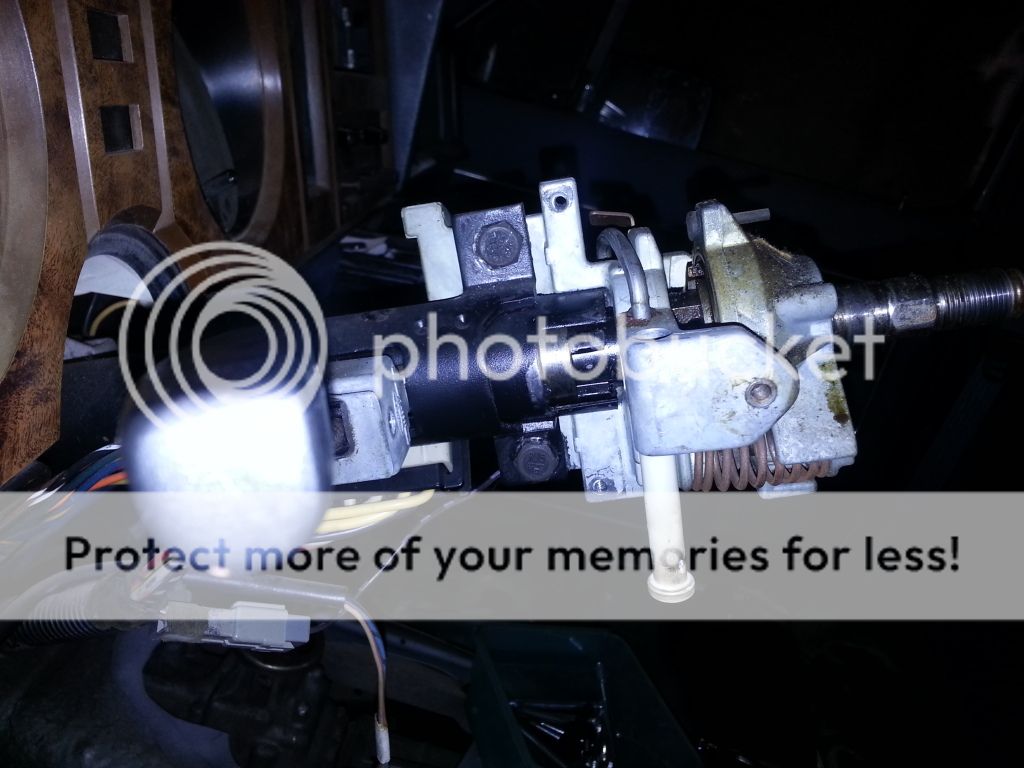

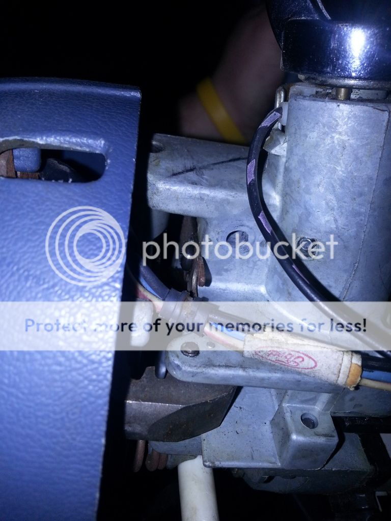

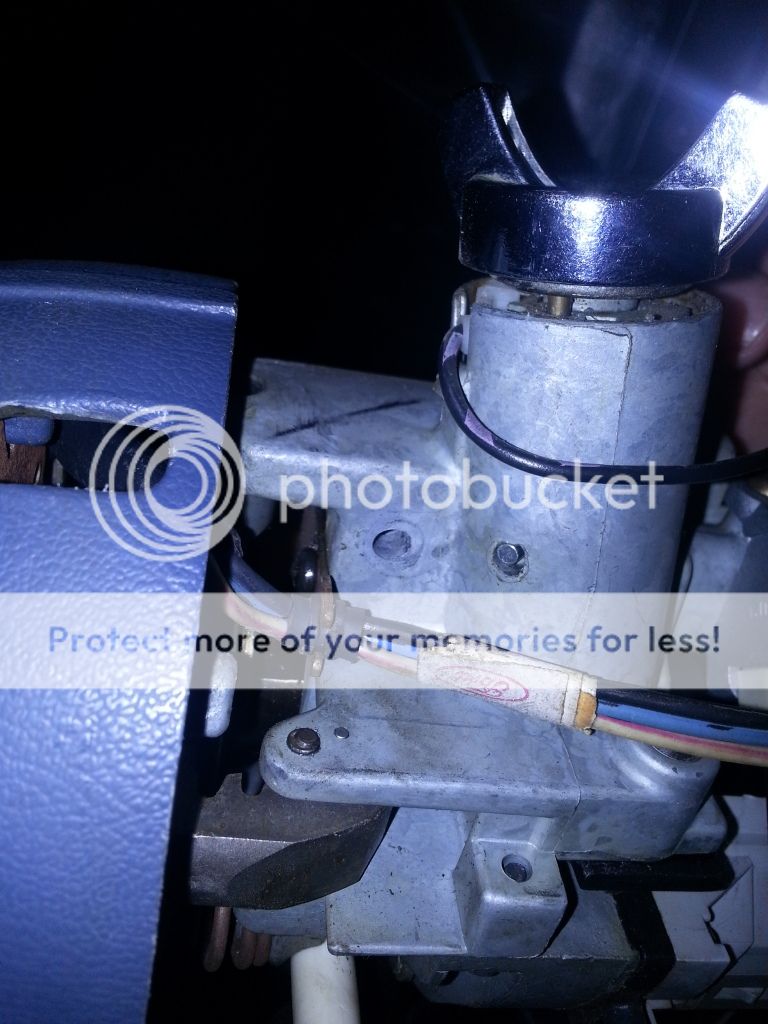

5. With all that removed, we next need to take of the multi function switch. This was held on by 2 philips head screws (circled in red in picture below). When removed it come right off. I unplugged the top plug to get more room, you don't have to.
6. The two bolts in the last picture is what we are after. They will become loose over time and cause you column to jiggle. Use the 13mm socket, tighten them both just slightly snug. Then remove one at a time. Using the paper towels and cleaner, clean the bolt, apply red loctite and put it back in and tighten tight. Repeat with other bolt. DO NOT REMOVE BOTH AT THE SAME TIME, IT CAN MESS UP THE ALIGNMENT!
