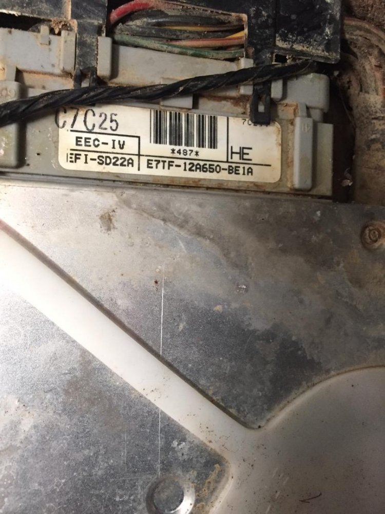

Alright first gen guys, I think I've toasted the ecm in my '87 2.9 4x4. I was jump starting my '03 Ranger with the '87 just like I've jumped any vehicle before. Truck acted funny when I hit the starter on the '03, it almost died, but caught back up and was running fine. I didn't like what happened so I disconnected the jumper cables. As soon as I disconnected the cables the '87 died, and would not fire back up. No fuel pump buzz when I cycle the ignition switch and turn the engine over. Checked fuses in the fuse block, all is good. Does this sound like the ECM, or is there a fuse I am missing in my search? Thanks for any suggestions.

Like I said before, everything works, I have power to everything. Lights work, horn works, starter is turning the engine over like it should. I'm not getting a fuel pump relay click, and that is controlled by the ECU if I am not mistaken. Is there anyone here that knows who repairs these? Or do you know what goes out in them that can be replaced. I am decent with electronics repair. The way I look at it, if it's not working now, what have I got to lose if I can get some information on what is usually replaced in them. I can find a used, or rebuilt ECU if I can't fix this one.
A couple of the more knowledgeable guys off the top of my head. I'm sure there are others that have the knowledge too.
These are the guys that know ECUs?
Yes the capacitors leak over time. But i doubt thats the issue here as it happend when you jumped the other truck.
