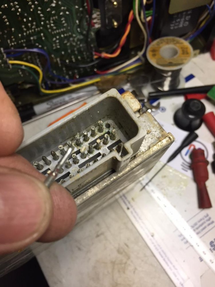

Ok, this is what I got when I pulled the plug in connector out of the puter box. Where do I find a pin out for this computer? I see a bit of green corrosion around the base of that pin that came out of the bulkhead connector.

Correctomundo!! I plugged it in to see if the fuel pump relay and pump buzzed up, it did!! Yay. So of course, I had to try it. It fired up, but it was running rough like the timing was way off, so I turned it off after it ran a second like that. Fuel pump worked with it though, so that tells me it was the factory EEC that was bad. But we already knew that after the previous tests I did, plus the pulled out pin in the bulkhead connection point on the puter.

I'm sure it's all good on that side of the connection since the '88 EEC would turn the fuel pump on. I was more or less wanting to find out which pin that is that pulled out of the computer. I'll look at the pin out and see if I can tell what pin it is. Thanks again.
Depending on what configuration the photo is in on that page, the pin that came out of my computer is either #1, (not used), or #20 (case ground).

RonD, can you look at the picture I posted of the busted pin, and the picture on the first link you send me for the pin out and tell me what # pin pulled out of my computer?
Pin 1 unused
Look on the wiring harness side to see if there is a wire there
The pins are all at a bit of an angle / / / / ect, thats how you can tell along with the tab out just under 41 and 42
