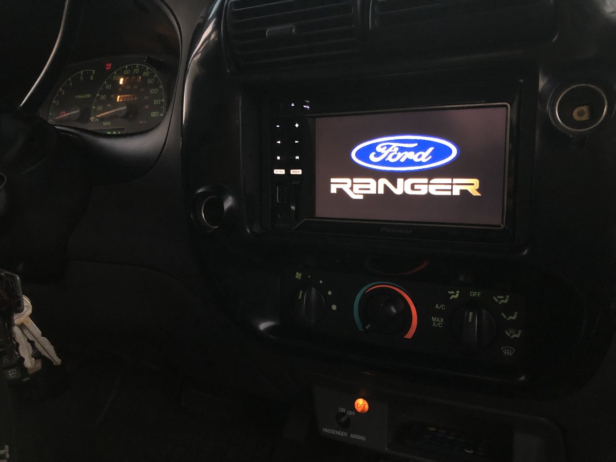

Tired of using the tape or FM adapter to plug in my phone. Had the bezel off to repair it as one of the 12v sockets got pushed in, and I’ve had this older Pioneer DVD head unit sitting around for a few years so figured I’d put it in the truck. Ordered a cheap harness and dash kit for $15. I think the Pioneer is nearly 10 years old, so nothing special, but does have USB which connects to my phone, and an AUX in. Have had the truck since 2014 and just haven’t had the energy to change it, lol. I use to love playing with car audio.

Pics of it installed.

I did similar to a Lineman's style splice / solder so they are solid connections, never been a fan of the crimp connectors. I still need to zip tie and or loom the wiring, but not totally done with the wiring if I test the camera, and just got a bypass / delay module wired in and tested to play DVD's / video after powering on, so holding off on bundling it tightly, until I'm done with that. Not necessarily pretty, but solid connections.
