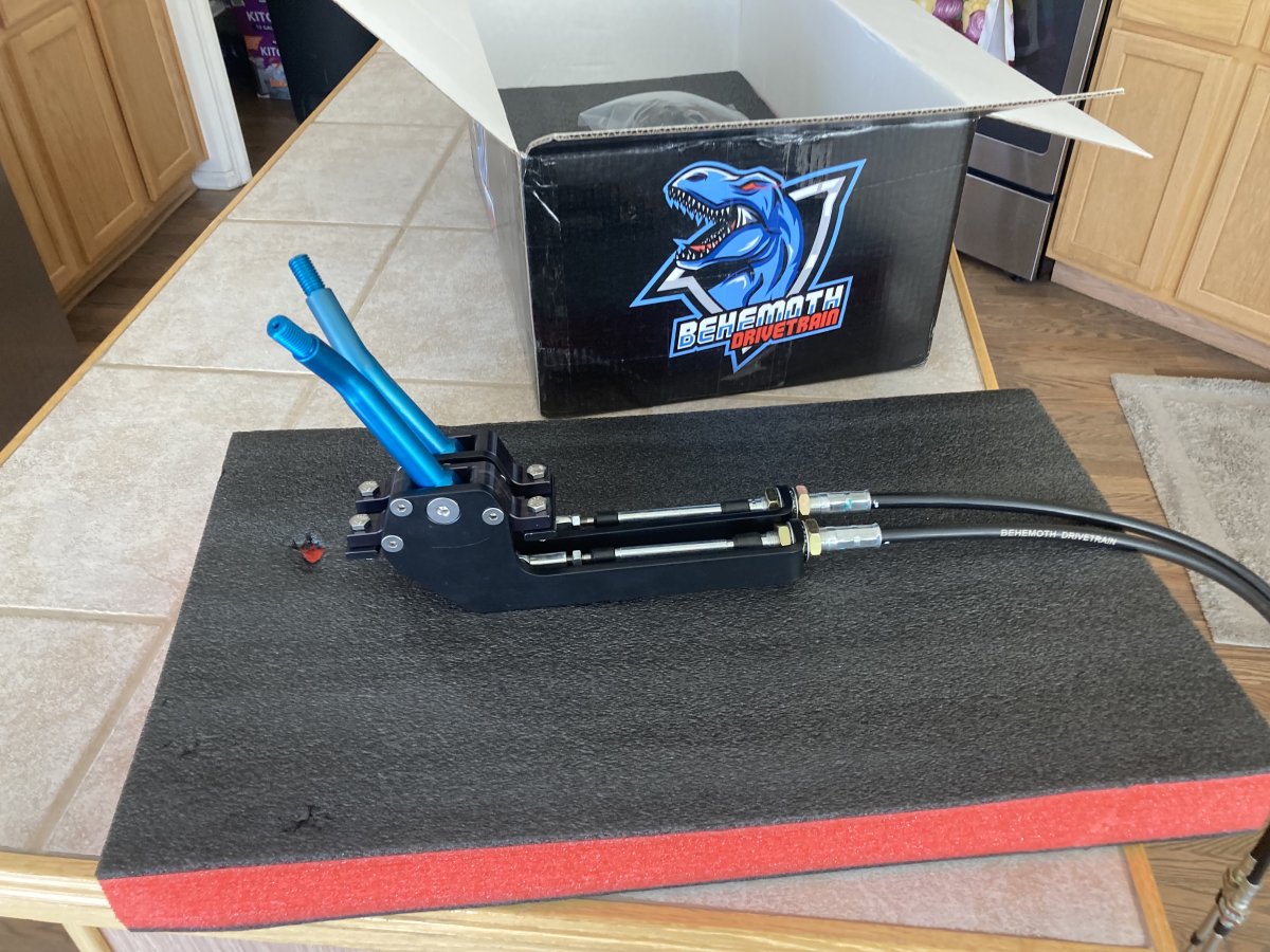

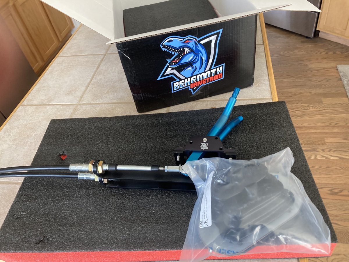

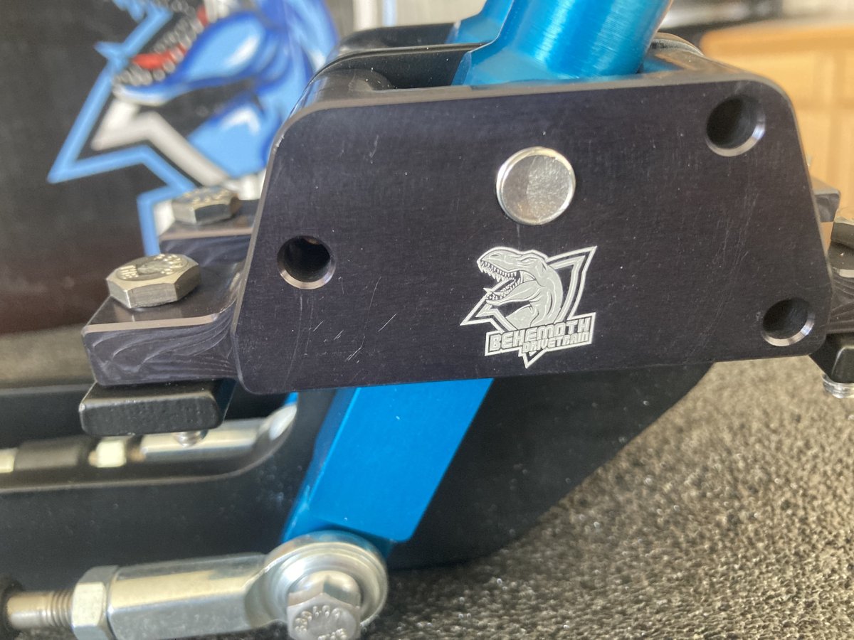

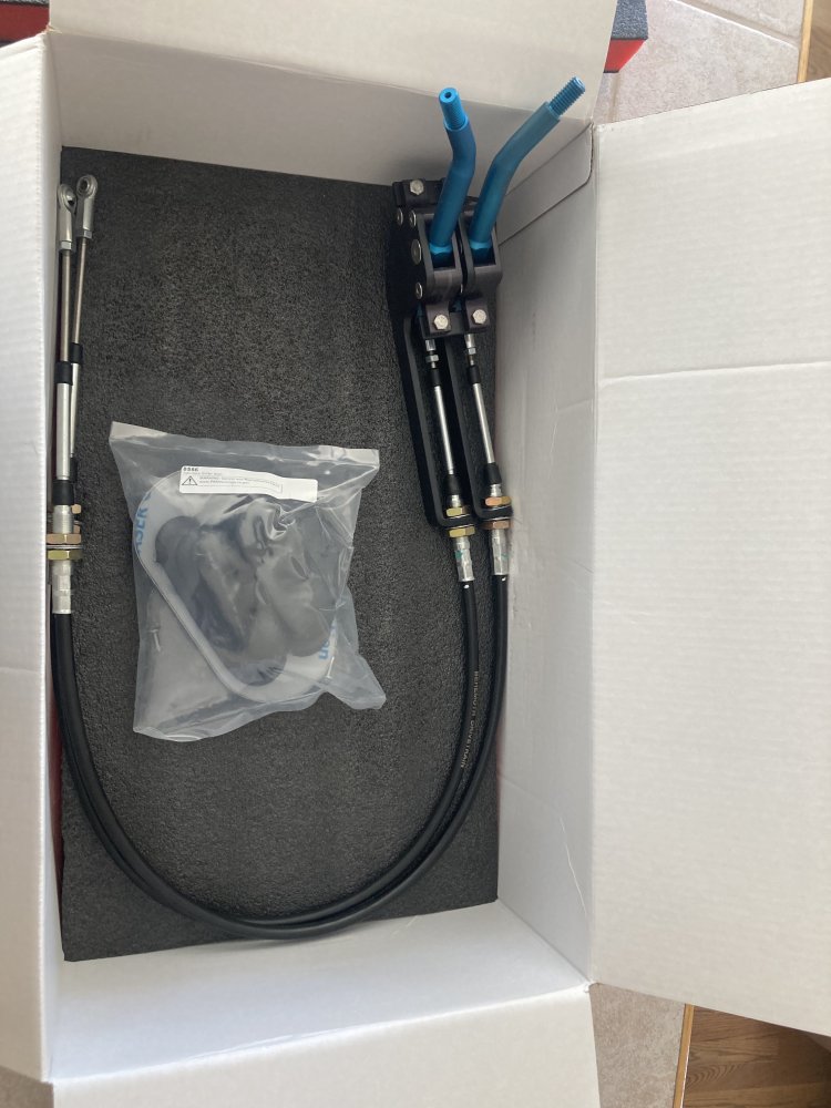

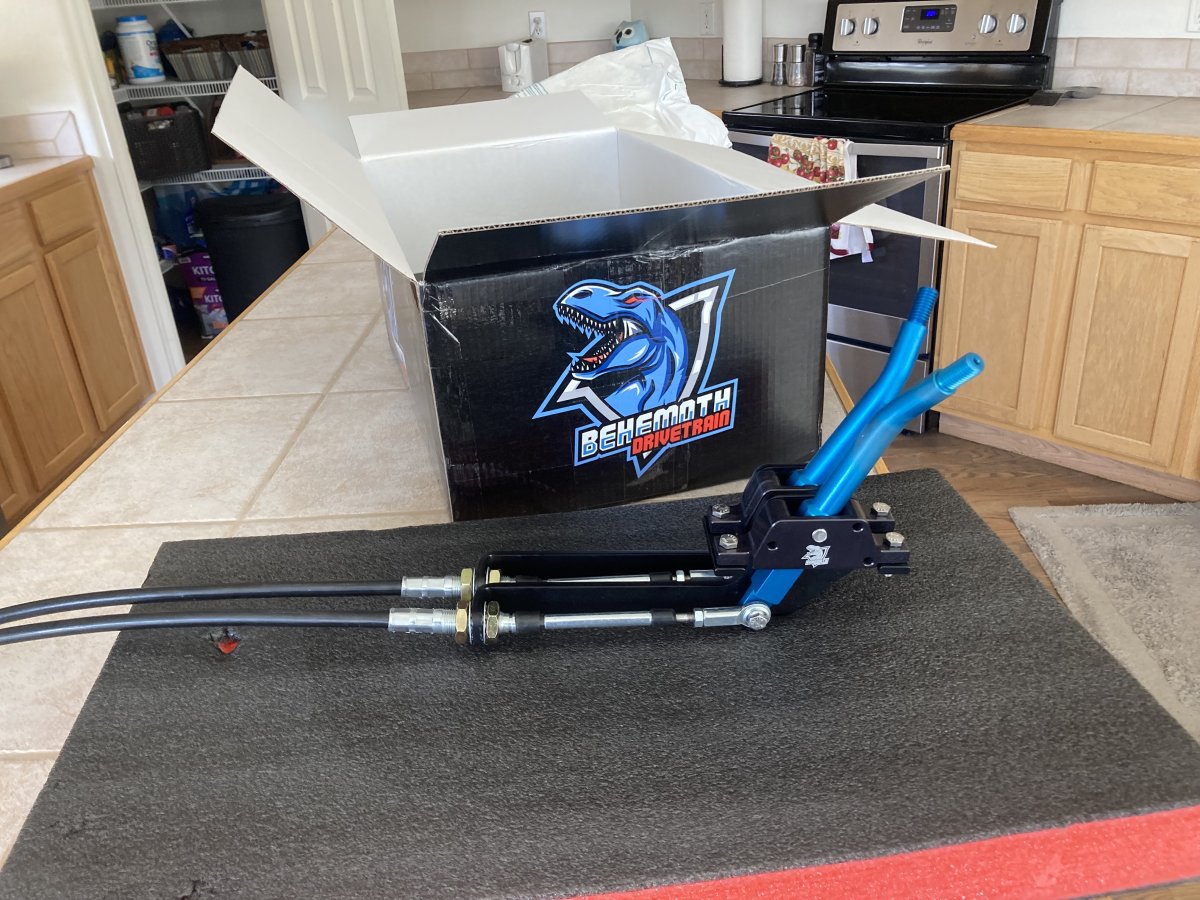

A couple of days ago I came home to a surprise! I got the shifters from behemoth.
I quickly got it into the kitchen and un boxed them. I didn't think they would come with cables but they did. I am impressed with the quality and size of these things.
You can see how they mount in this picture. I think I am going to make a new plate for my floor out of thicker steel than the current aluminum and have it rhino coated with a hole for these shifters. I need to find a good manual trans boot without the tcase boot attached. That could be a chore.
It came with an independent boot for the twin sticks:

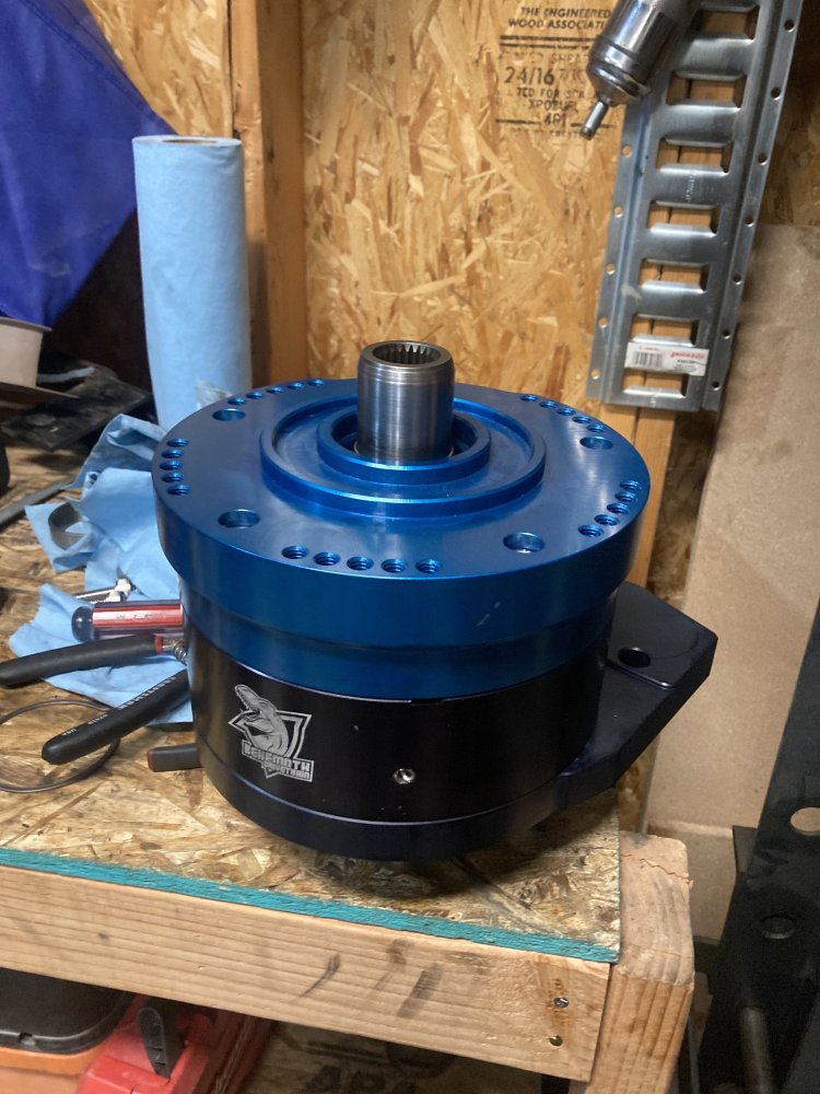

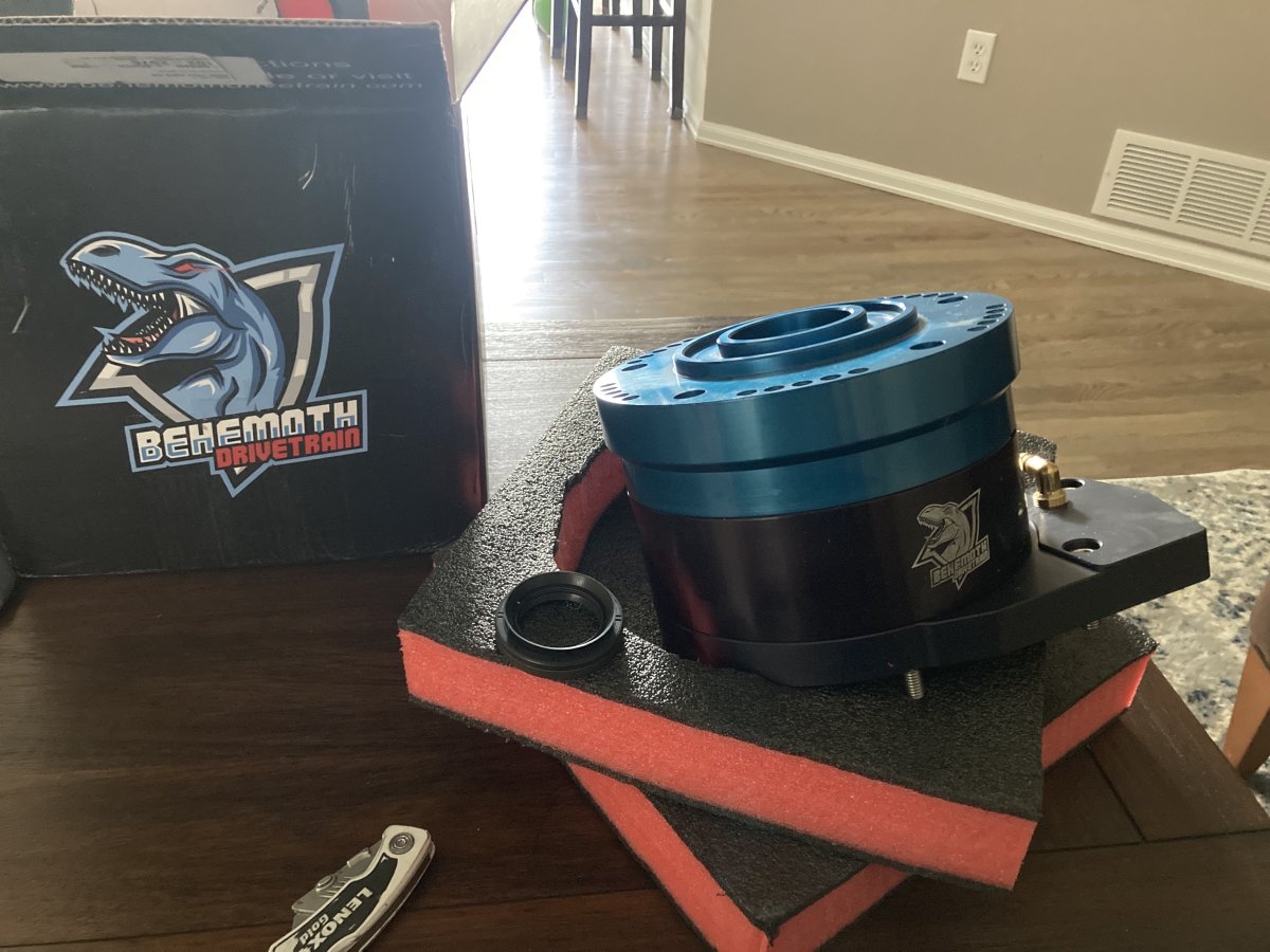

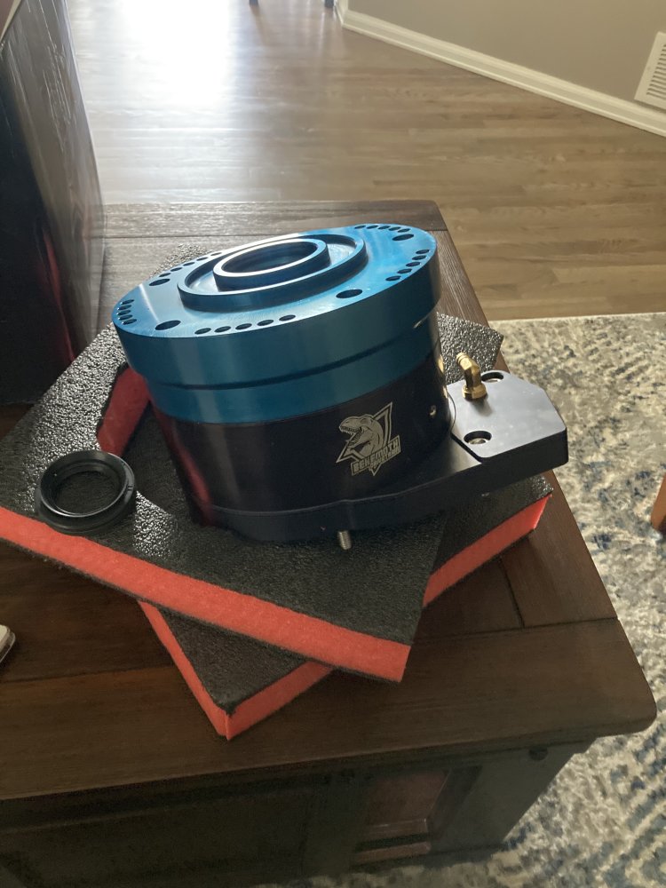

Sorry I haven't updated this in a while. I have made some progress, but I didn't get it installed.
It did arrive, boxed up perfect from behemoth and with a hand written thank you note. It was larger than I expected- I should have known it would be this size, but in the pictures it looked smaller.

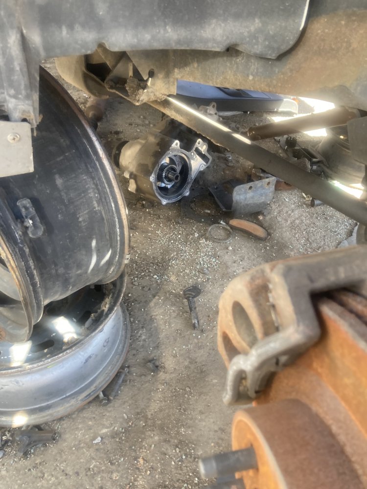

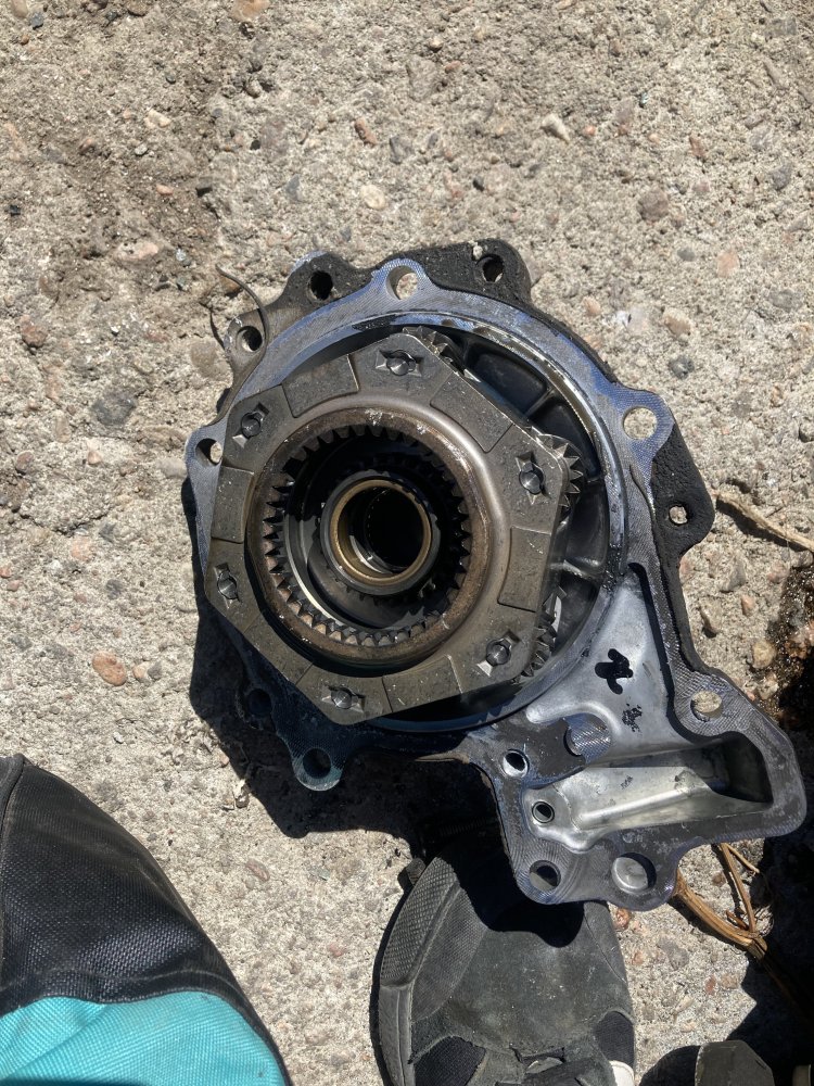

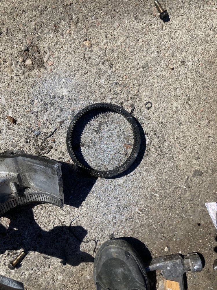

Next I went to the junk yard and bought some parts out of later model 1354s so that I could assemble the box.
These parts were all out of 2 2002 ish sport tracks. Probably died from timing chain issues. Both auto cases.
I got the planetary ring out of this one.
It required hacking the front low range section of the case in two.
Next I grabbed the planetary gears and clips and stuff.

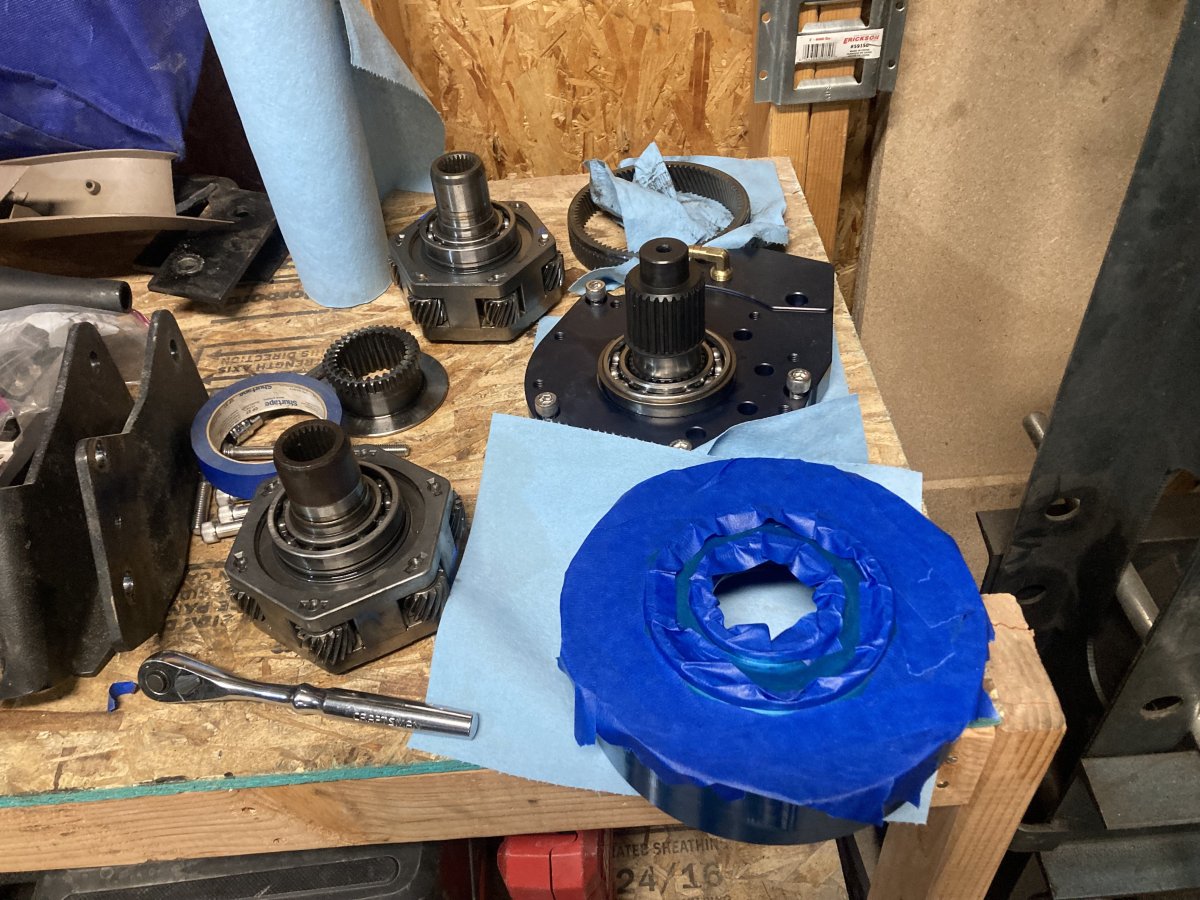

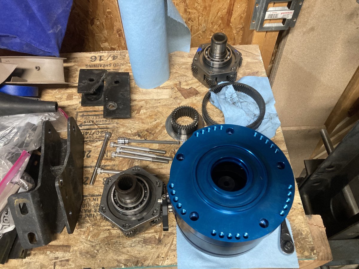

And got another set. My plan is to full assemble the doubler then pull the truck in and the doubler will be ready to swap without having to take mine apart and assemble during the swap.

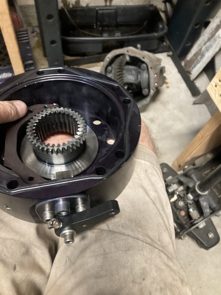

Here are the junk yard parts and the strong box on the bench. Notice I got 2 planetary gear sets- mostly because I expect my 1991 to have a 4 gear planetary set. I also got the shift collar gear and the planetary gear.

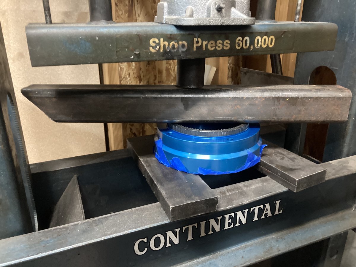

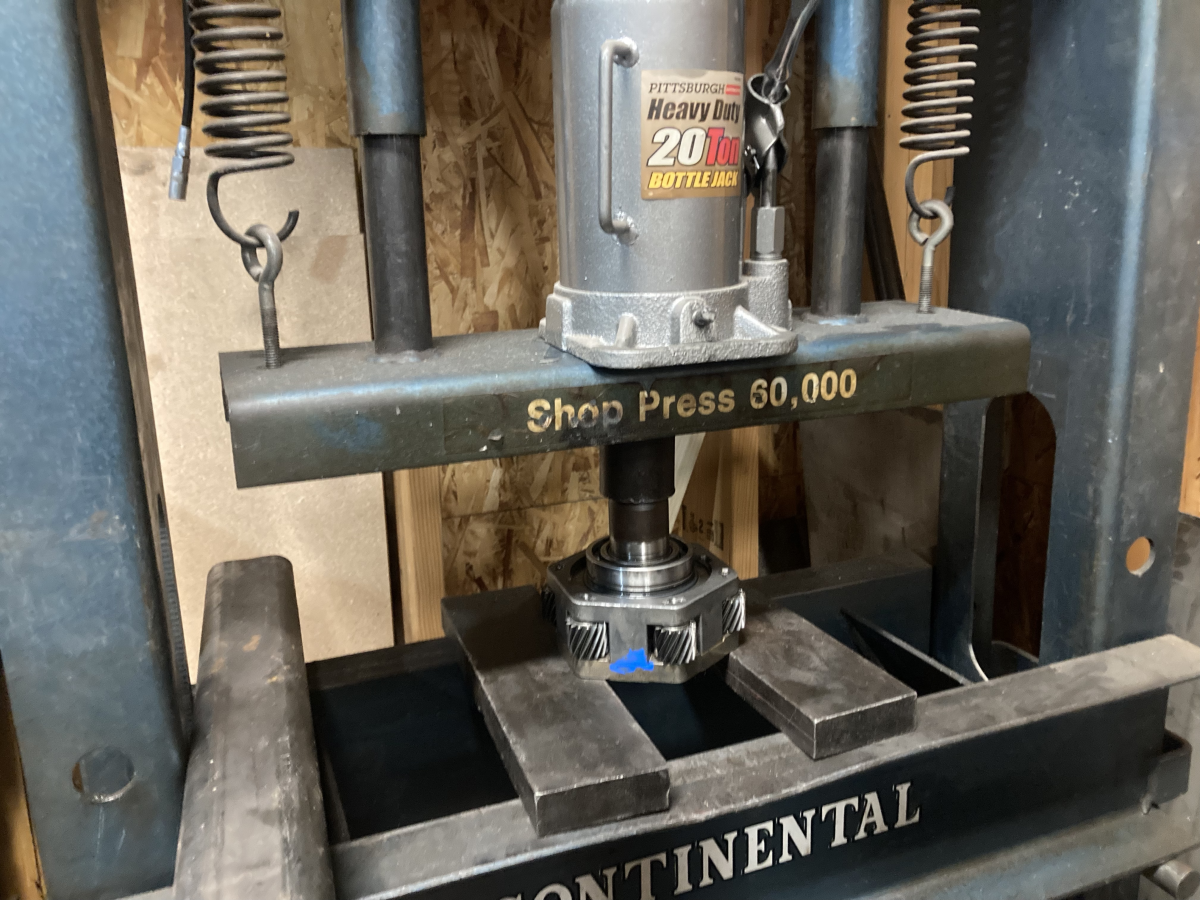

Next I took the strong box and applied tape to keep the annodizing nice.
Then I Pressed in the ring gear.
Here is the ring gear installed. I think it went just a little further but not much.

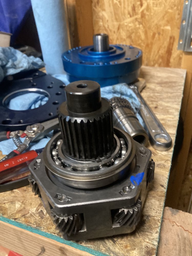

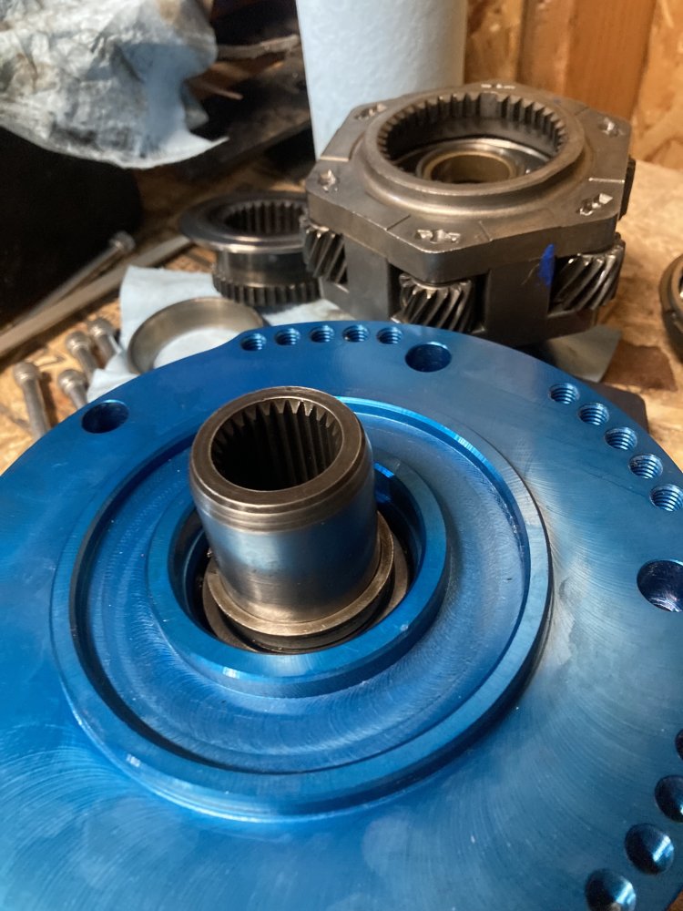

Next I pressed out one of the input shafts from the planetary set.
Saving the bearings. They all looked really nice and in good shape. I priced new ones but they are astronomical.
Then I installed the clip and the shaft in the front case.
T

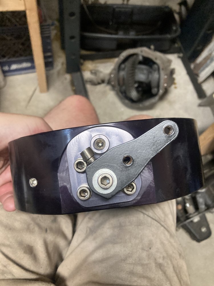

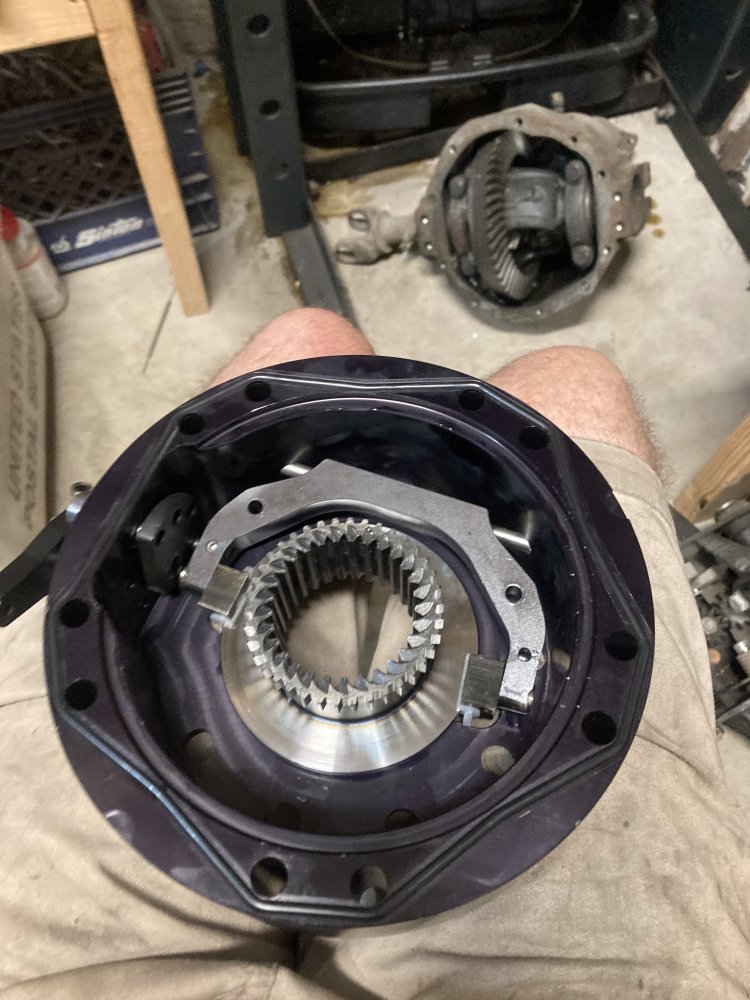

Next up is the shift collar gear.
Shifter shifts way nice and has some clocking options.
Next for the behemoth intermediate shaft on the other of the planetaries.
Ready for install. I won't glue until I have final orientation.
