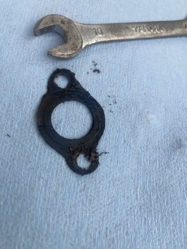

10mm for scale.
That gasket was in the pan?
Looks like the pickup tube gasket...
and no the oil pump is completly inside the pan.
If the HV pump works well for you let me know, cause ill put one in mine to shut it up.
Another member here named petroleumjunke420 built a pretty hipo 2.9 and was really looking into their common issues. He tried an HV pump and ran it on a stand and said it flooded the top end with oil. So that maybe the ticket assuming everything else is in good order.
No I didn’t touch the pan at all. And the drain plug is not wide enough for this gasket to pop out unless it was bent a bunch. So I have no idea how it ended up on the ground but it’s fresh oil so clearly it was me and no other vehicle parks here.

Will also try to figure out where this gasket came from. It’s pretty bonkers.

10mm for scale.
I don't see that gasket as "popping" out. The bolt hole areas are not broken. It's an old gasket that happened to fall after being stuck somewhere for awhile.
