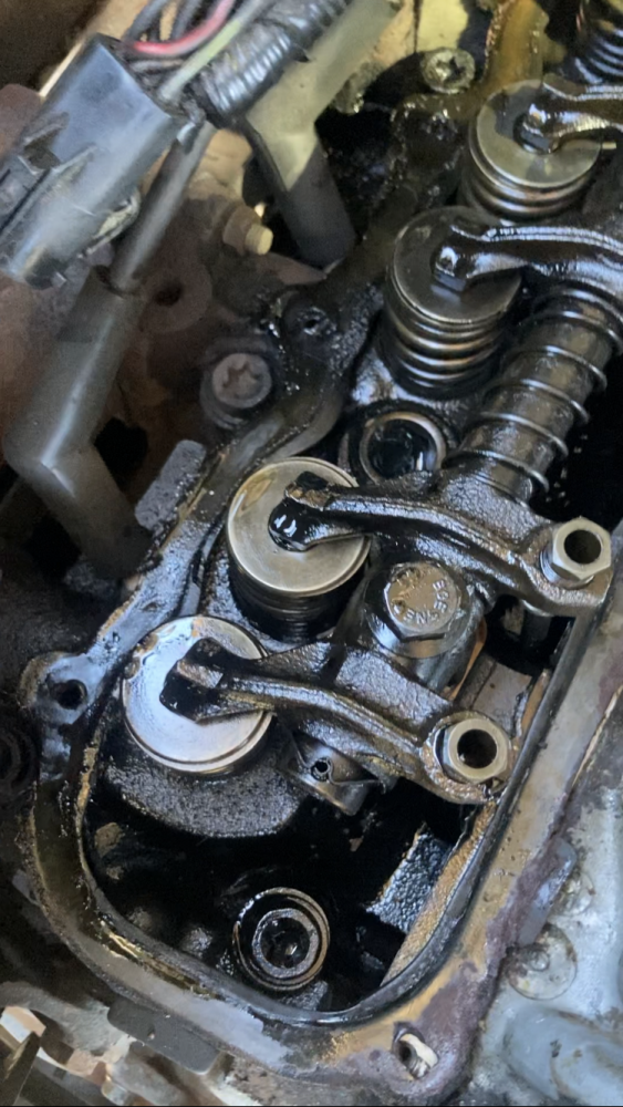

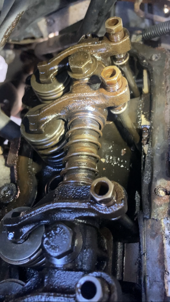

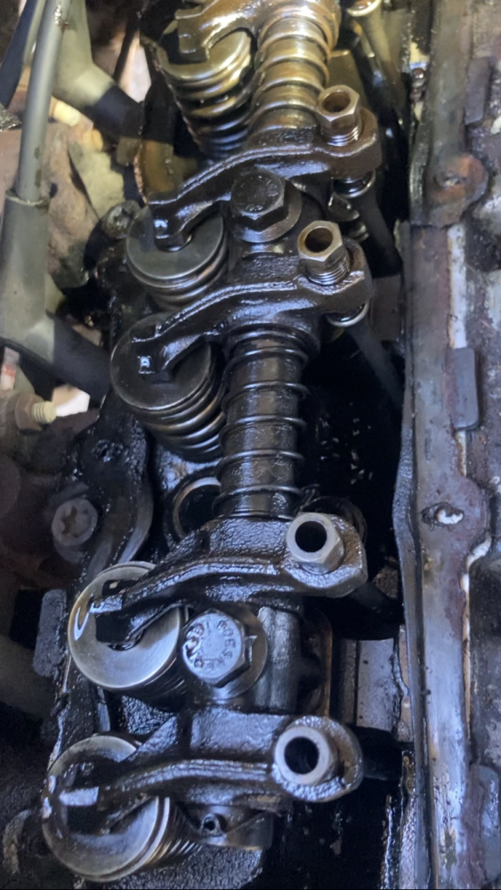

Here’s the passenger side valve cover opened up. Doing drives side shortly. Not sure yet what to inspect in general but am already doing gaskets and cleaning (and maybe painting) the covers so figure I can check something in here regarding mechanicals..

Have all spark plugs out and turn the crank manually to check the lash on each rocker, to see if any were loose
Rotate crank and watch the valve you want to adjust, you can easily see when it opens and closes so half way between those is 0 lift from cam
Loosen hex nut until rocker is loose, then tighten until is not, thats 0 lash, now tighten hex head 1 and 3/4 turns more to pre-load lifter
Repeat 11 more times
Some use 1 and 1/2 turns, up to you but all have to be the same, I suggest 1 and 3/4 on older engines
You can also do several valves at a time based on firing order and crank position, you can look that up

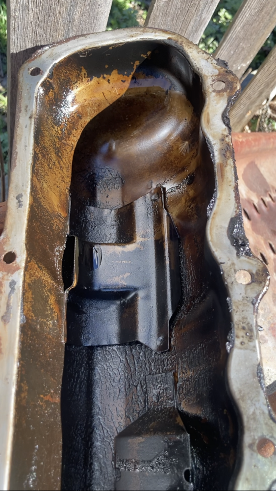

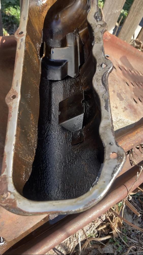

Problem is getting the oil pan off, you are not just replacing the oil pan gasket, which is a pain, the pan must come off all the way to replace the oil pump
Which usually means the transmission must come off
Remember, the oil pick up is at the bottom of the lowest part of the oil pan
So the rear of the pan must drop down and back(where transmission is an issue) and then the front of the pan must also be able to come down low enough to clear the oil pickup as it slides back
Pretty much pulling the engine is needed, or disconnecting trans and lifting engine up 8" or so in the engine bay
It won't lift up more than 2 or 3" with transmission attached as it hits the tunnel/firewall
