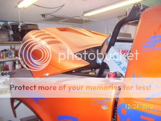

That little truck looks sick guys. I wish i had the money to make mine look and perform like yalls does. Good work, i like the paint job, and pics with the models standing by the truck.
man what a sweet build very well done nice work
I seen this truck at the ORO. GORGEOUS. crazy to think it was built in a garage. Amazing work guys.

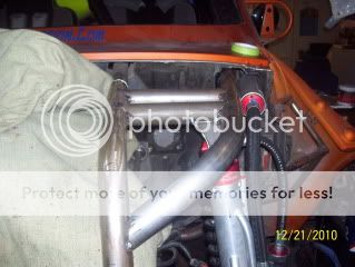

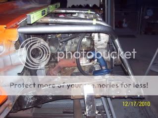

first tube
FAST Fabrication 94 b4000 turn into SNORE class 7 race truck build thread
second tube took awhile to get it perfectly plumb and level

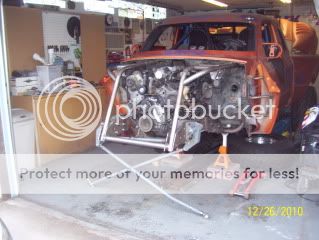

been working hard getting ready for our first race in Feb to start the season

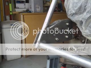

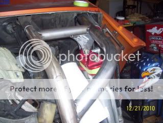

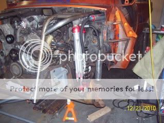

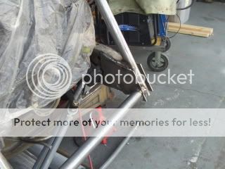

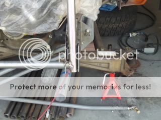

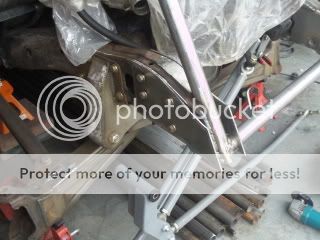

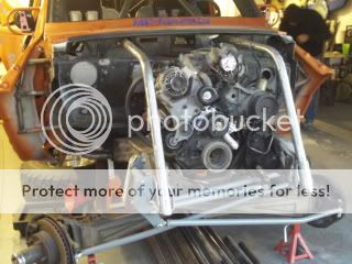

here is one of the gusset tubes, we decided to go straight in stead of down and bend, keep it stronger and cleaner

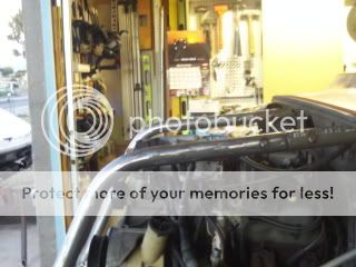

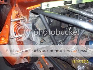

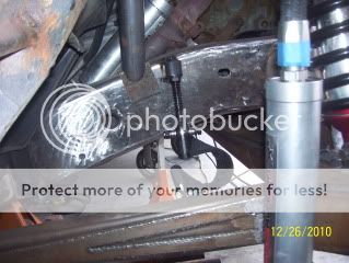

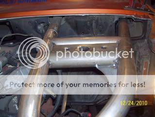

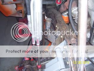

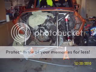

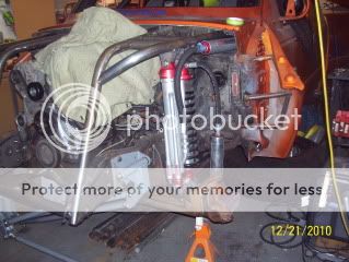

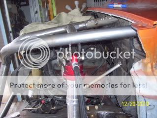

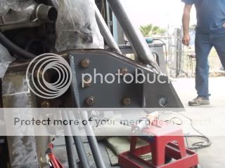

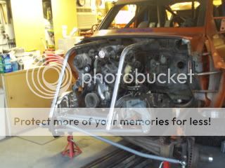

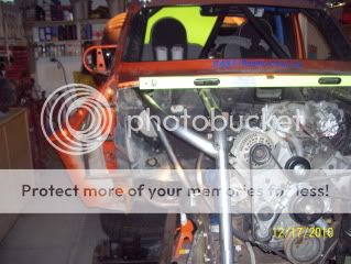

here are the pictures of the frame work... have 3/4 4130 250 wall crush sleeves on passenger side for swinger.. both sides have 3/16 plate on each side tieing frame to new engine cage and to the cross brace... it will be completely boxed on the ends once we build the bumper, plates already cut to close it up

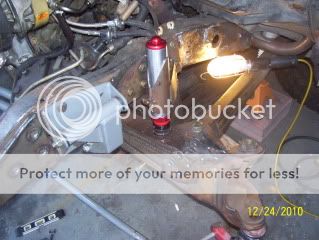

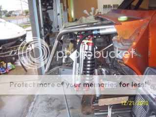

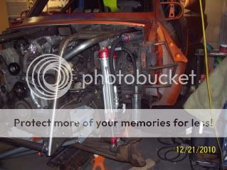

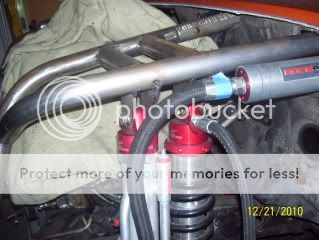

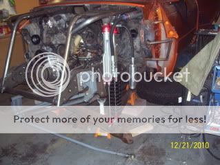

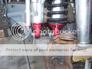

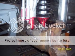

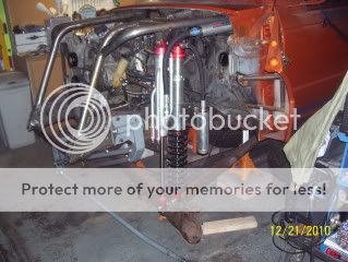

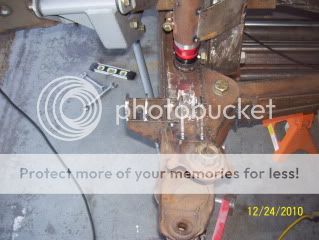

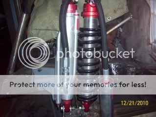

here are the picks from the mock up of the shock mounts... we are almost done with driver side bypass.... the coilover droop it self out without binding.. bypass is on the exact same plane as the coilover is and should have no issues either being that lengths are identical.. we will be gusseting and dimpling the sides of the tabs

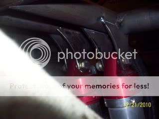

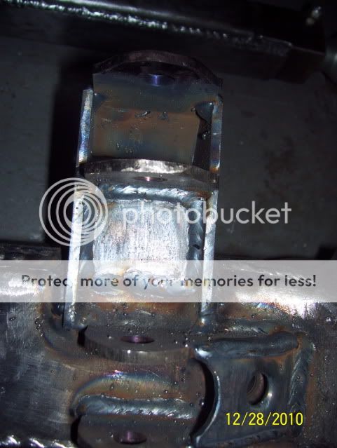

just about done... mocking up last tab on upper bypass mount

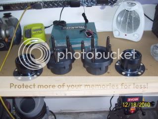

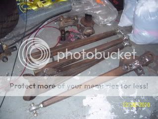

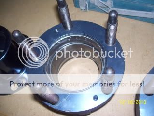

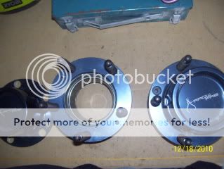

these are my old hubs that were in my previous housing... were only used for mock up... first $500 takes them.. same as the dezert nation ones, in fact use to say dezert nation on them until manufacture took back an unpaid order and re anodize the caps and I bought from him. Snouts not included I can get for under 200, they are 2.25 and are identical to dezert nation, camburg, and mitler brothers.. One has nicks in it because previous shop who screwed rest of the things on my truck did not use grease and bearings and nut had rusted to snout, had to use a screw driver to get it off. They are 5x5.5 with coarse thread. When I bought these they were $1100, they now sell for $1500 and only difference is the two snouts and the bearings and seal, I have the bearings but i suggest buying new ones. For the front you just need to get the snouts, for rear you need to get snouts and get hollowed out and get drive plates.

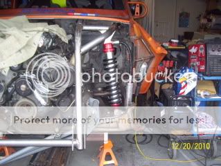

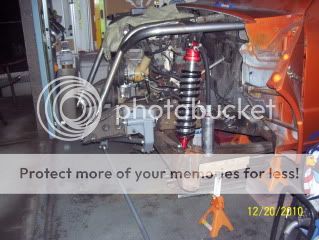

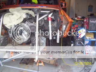

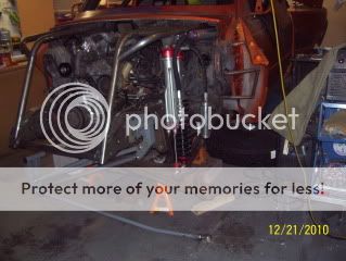

got the bypass finished.. minus gussets.. it cycle perfectly, took shots as it droop out on it own... no binding at all just like the coilover... think it looks so much better then before

here is the suspension drooping out on its own

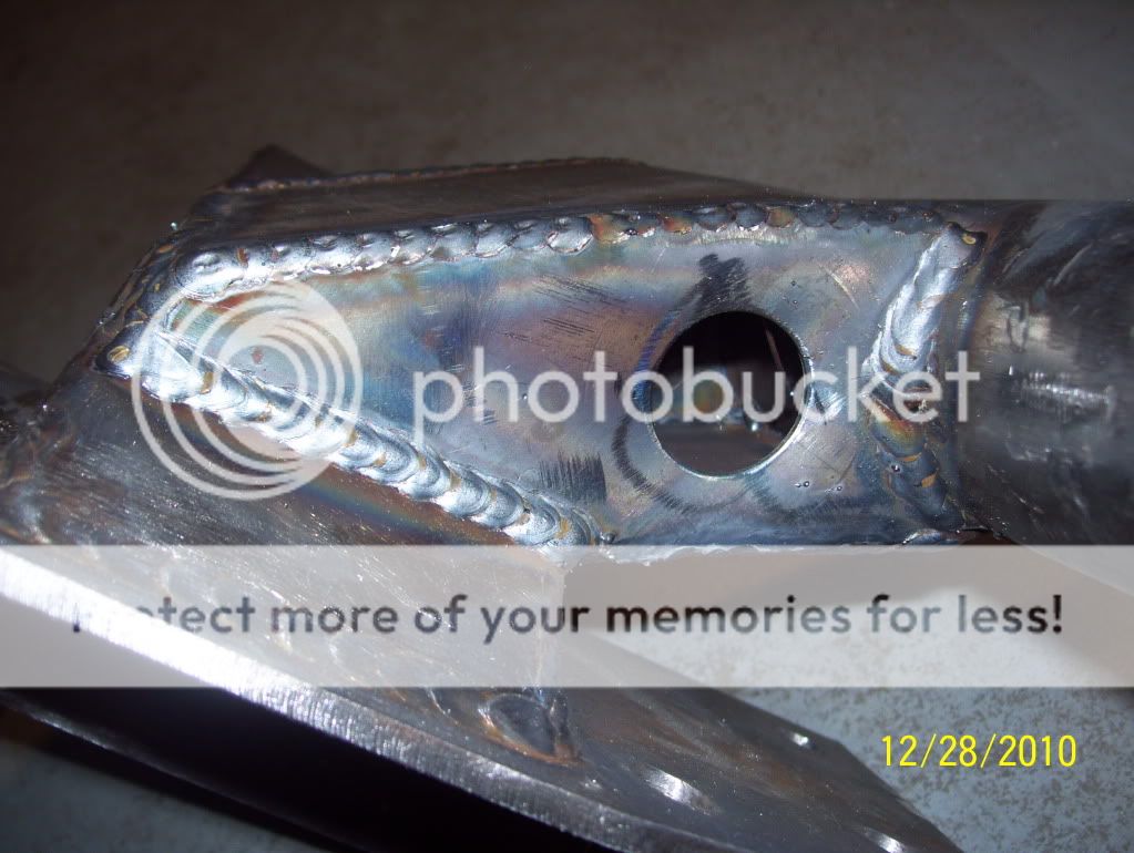

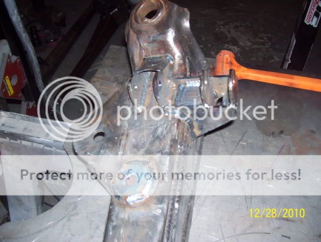

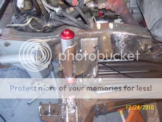

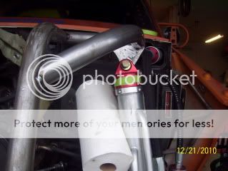

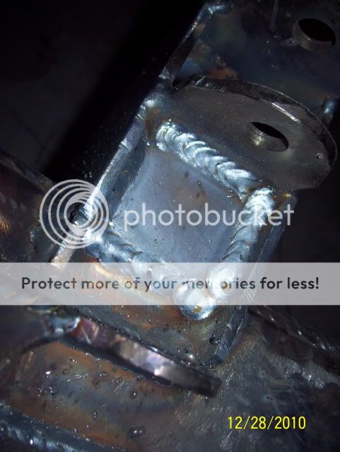

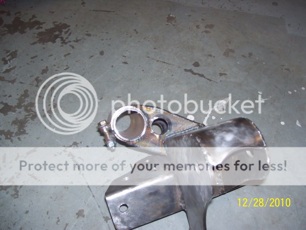

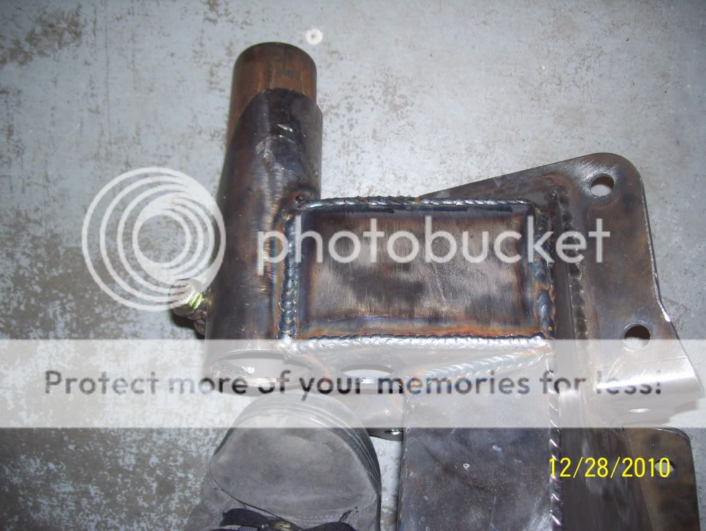

The start of the bump can set up, it’s bolt on since they are mounted to beam mounts… Took us a long time we tried so many variations trying to get it out as far as possible and not change through its travel so it would end up in our dimpled pad

Limit strap, it will have dual on each side

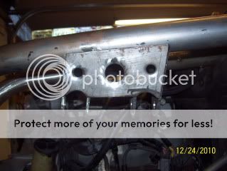

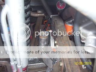

Suspension is off, to weld it up, cleaning it up and building our dimpled gussets to box in bump can mounts, there are these cuts all around one of the beams but it must have been like that when dave welded them up because they are only on the inner plate, if it was after I got them their be gouges on all the plates not just inner one all the way around

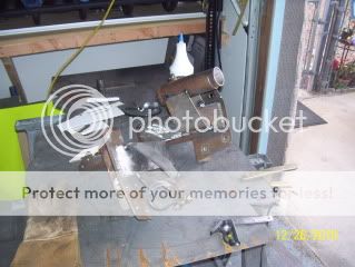

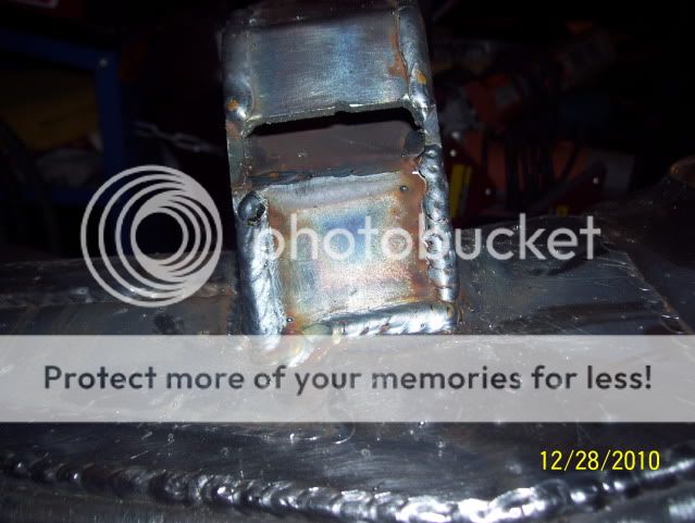

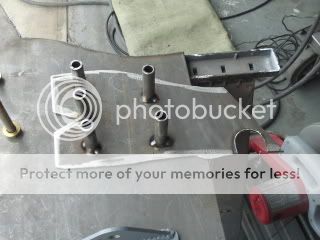

Started making all our gussets

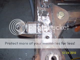

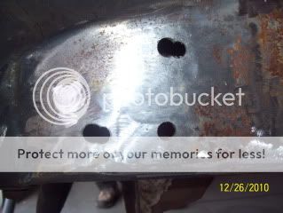

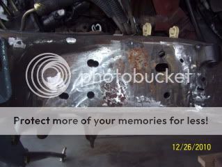

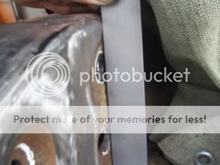

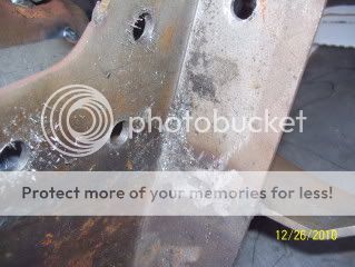

Not going to believe what we found after we removed the suspension for the first time since I had the truck, previous shop drilled beam mounts while mount was tacked up leaving a bunch of metal in between mount and frame rusting it all up and 3 of the holes have to be slugged and welded and redrilled because they didn’t set it up based on the factory holes and then take a marker or whatever and draw the other holes that have to be drilled, actually we might have to slug all them, now that I think about it.

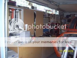

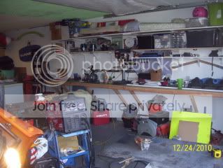

The clips resting space and some upgrades to the garage and our other toy 

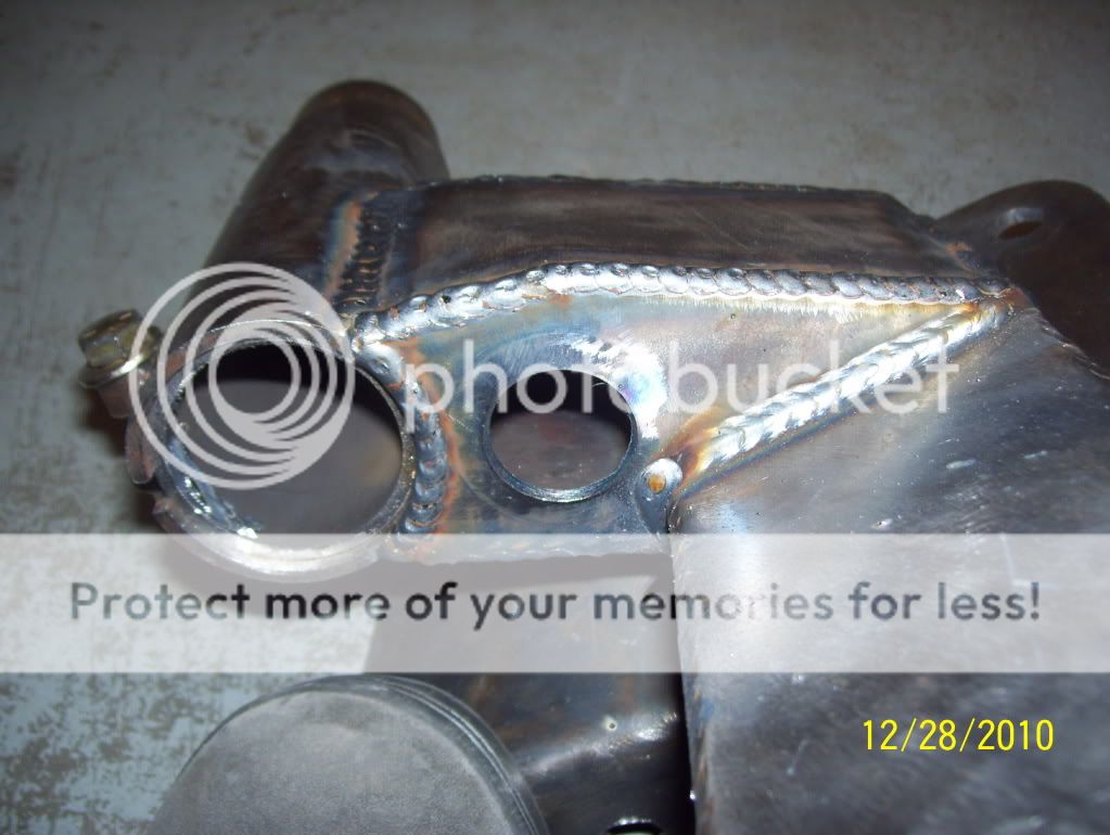

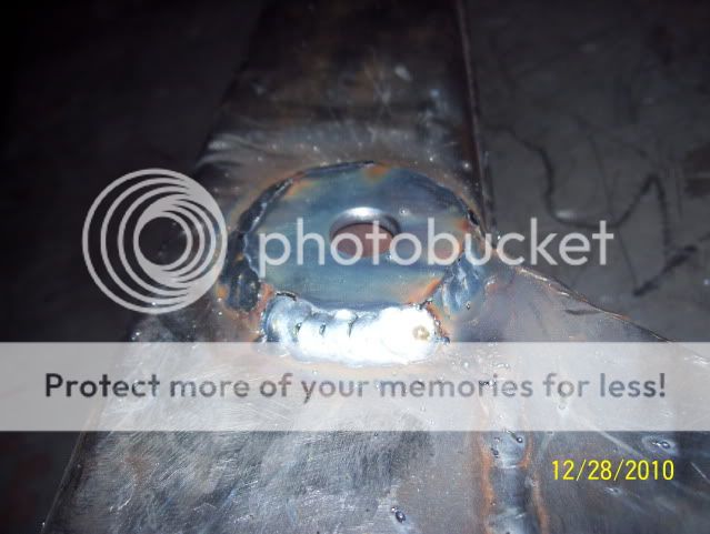

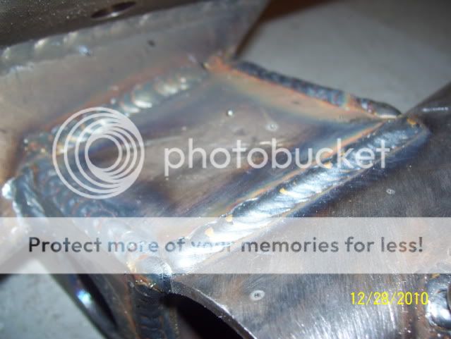

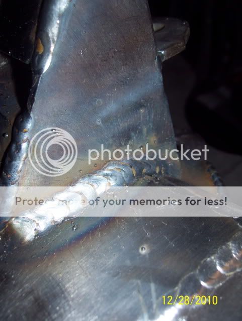

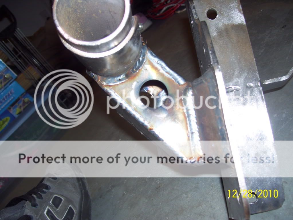

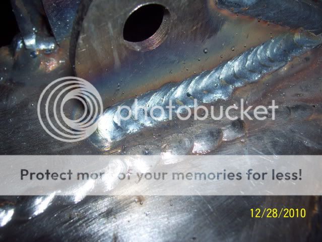

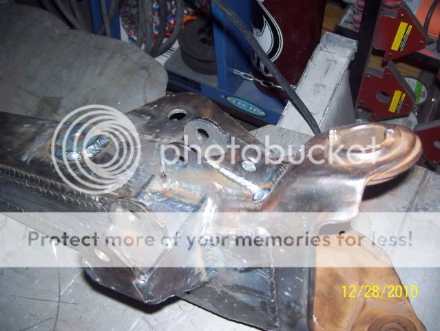

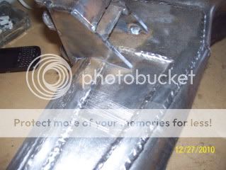

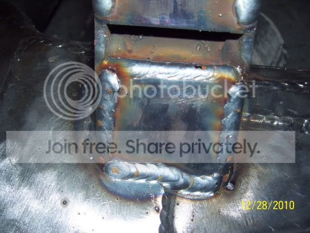

I was trying new size, so these pictures will be a quite a bit bigger, you guys wanted bigger pictures lol.... bump cans and suspension all welded up... just need to clean slag and were ready for paint
