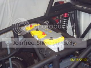

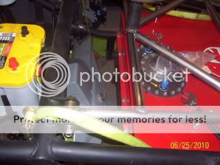

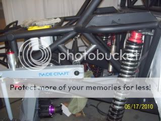

Installed are battery

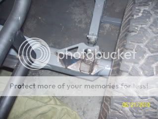

Started on sway bar completing today

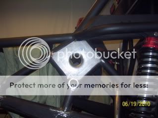

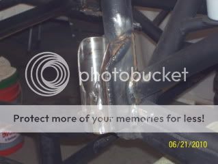

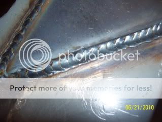

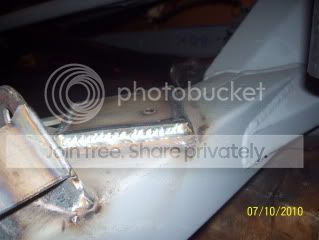

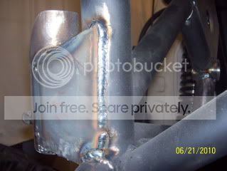

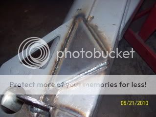

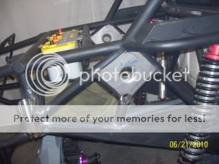

Got the Sway bar all mounted up and built a sweet dimple gusset plate, just need to fully weld it...

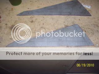

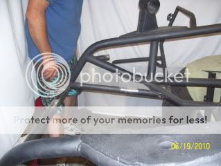

started on fuel cell relocation, built a gusset plate for back of frame will have a dimple in it and have front mount to fuel cell welded to it

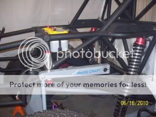

got lower link arm for sway bar pocket done and level out housing for bump pad

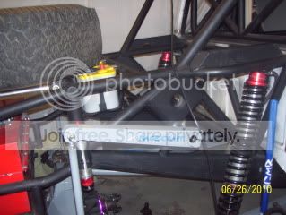

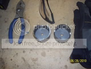

bump cans fully welded

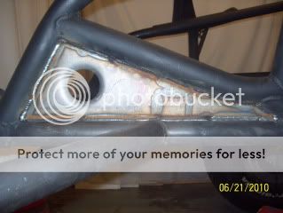

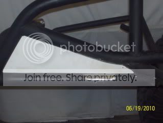

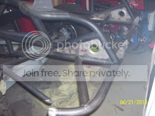

rear gusset which also was used to mount fuel cell due to relocation

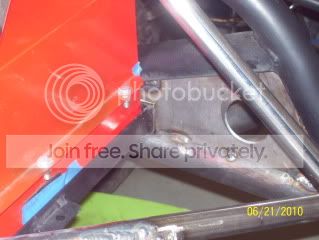

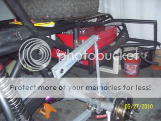

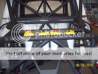

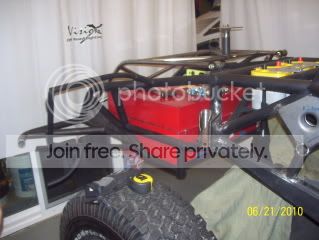

fuel cell back in

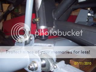

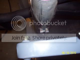

sway bar mount

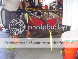

how far off driveshaft needed to be extended at ride height... getting custom one made
FAST Fabrication 94 b4000 turn into SNORE class 7 race truck build thread
full droop, roughly 35" of useable wheel travel, going to strap at around 25

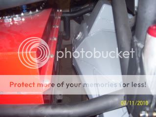

fuel cell clears now

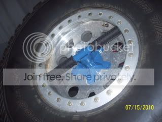

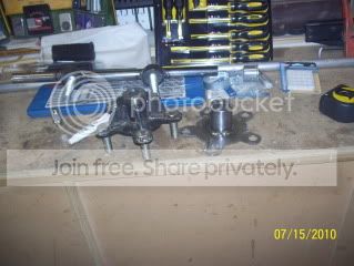

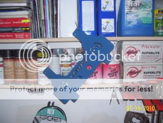

spare mount is done, finishing fabricating the spinners

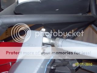

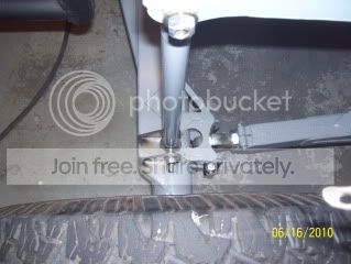

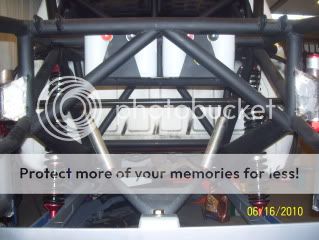

sway bar completed, going to add a quick disconnect pin set up

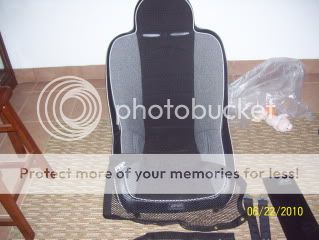

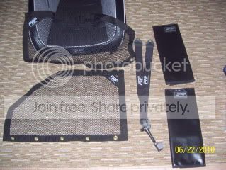

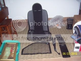

thanks to our sponsors PRP Seats at prpseats.com

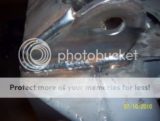

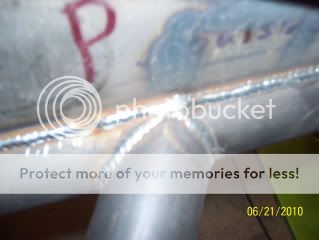

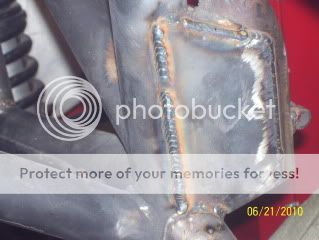

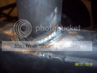

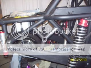

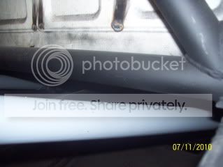

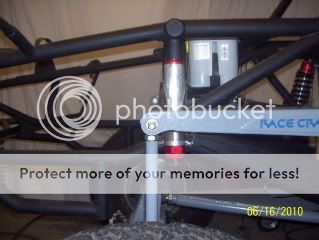

Welded and completed sway bar, bump stops & pads

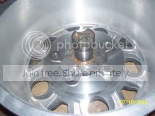

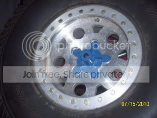

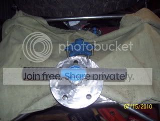

spinner parts welded, still need to weld handle bar, studs, and lil gussets

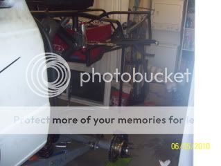

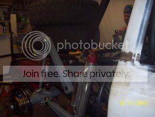

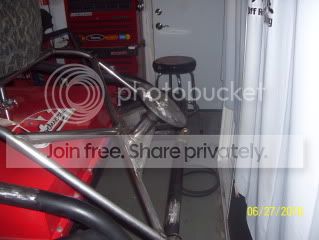

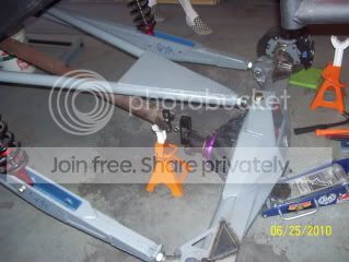

Axle painted, extended stock driveshaft in, suspension fully bumped plenty of clearance

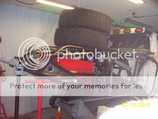

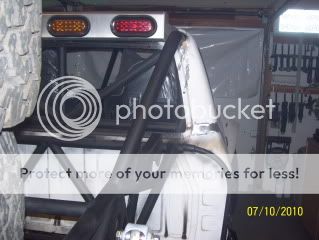

from back half

from fuel cell

from battery box/differential

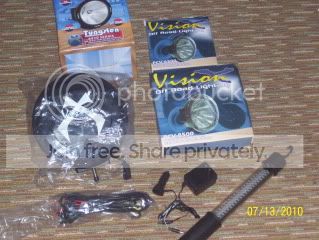

Vision X lights...one 9" and one 7" to mock up light bar and bumper, work light is insanely bright comes with car charger and wall charger, poly-cabronate lenses

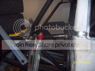

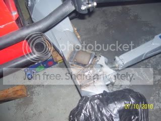

old shock mount pockets before cut
passenger side after cut

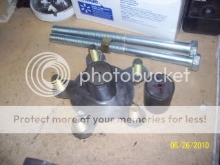

think i will call my truck the grasshopper or locust lol

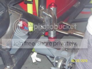

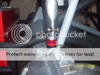

bypass will actually be an 1" taller and coil-over 1" taller from before, causing us to need 90 degree resi fitting.

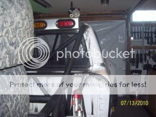

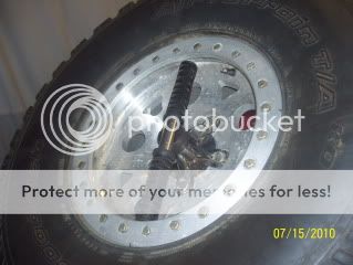

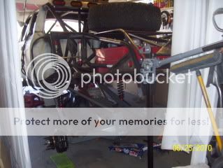

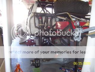

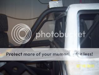

Spinner and spare tire is done, just waiting on shock ends to finish shock mounts, then rear is done until fuel cell decision is made...

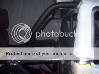

still pushing on just waiting for parts from sway away and tech guy from MDR/MORE/LORE/etc to come check cab cage and fuel cell and rest of truck he said for sure mon or tues, so once that is done we can actually continue full on with truck figure out our options with fuel cell and go from there. School starts again 21 next month so got to get as much as I can done.
