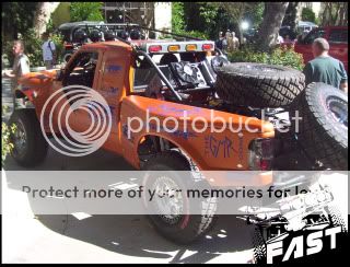

FAST Fabrication 94 b4000 turn into SNORE class 7 race truck build thread

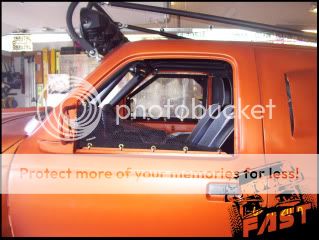

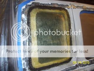

yesterday spent hole day mounting wheels, today we completed fresh air mount, led dome mount, window pillar gussets and started on light bar

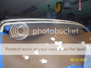

9/11 following thus-sat fiberglass work (visor and scoops wont have time for dash, finish any welds and paint cage work

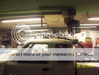

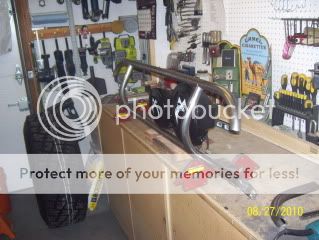

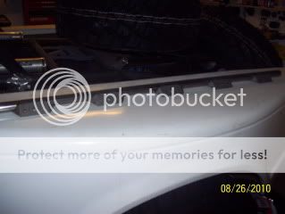

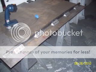

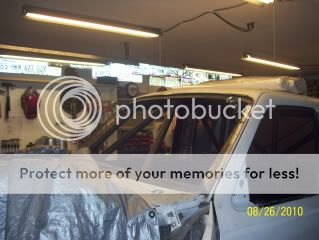

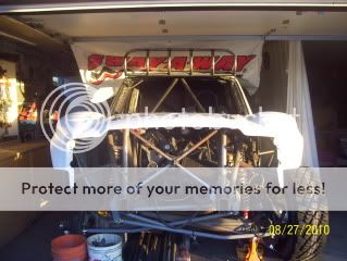

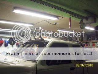

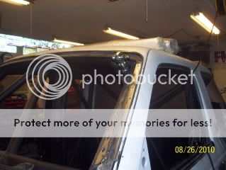

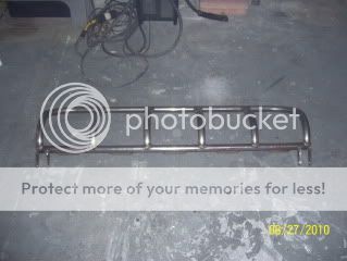

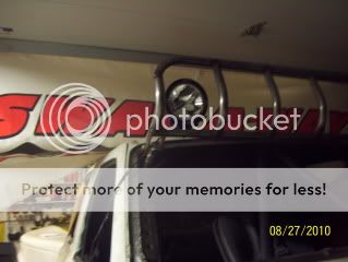

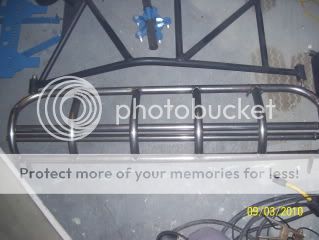

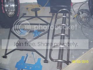

spent whole day on light bar, its a lot of work building everything from scratch (tabs, tubes, etc) especially with not all the fancy tools, i think it turn ouy bitchin though and we just need to do the adustment bars, I ran out of that tubing size.
One cool thing is that if we ever want to put the big lights we use for the front bumper up top they will barely fit.

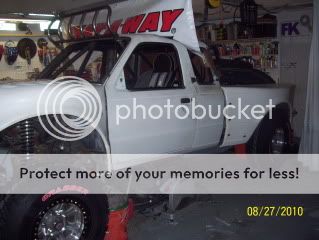

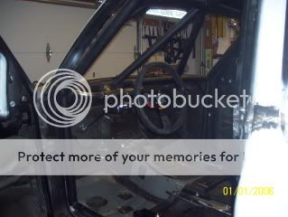

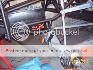

laid dash back on and slip on the new shoes over the stock d44 hubs barely able to get a lug nut on.. switching to 5/8 studs next week... best thing is we are exactly 85" and they were not tighten down and we know the suspension is not right, so looks like were all good on trackwidth

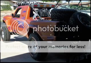

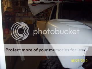

some of my fav new pics.. truck is sagging so much with that extra 250lbs in back..but we dont have coil springs tighten right now

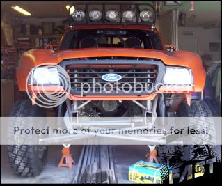

tested vision x 50 watt hid spot.. here is pic with light off and then with on in same spot... garage is about 90-100 ft away

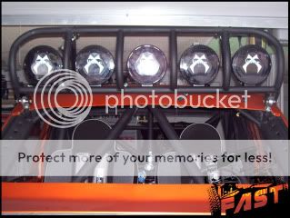

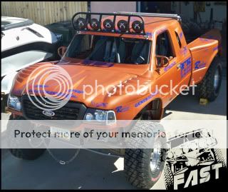

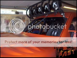

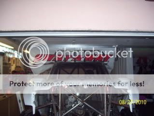

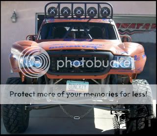

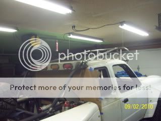

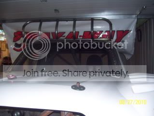

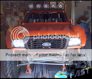

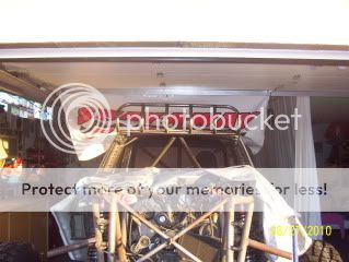

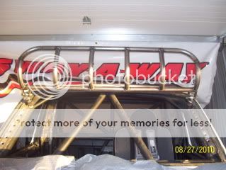

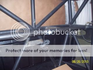

finished the light bar

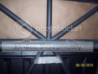

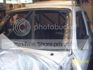

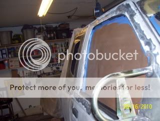

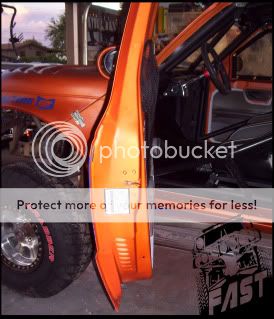

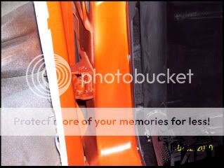

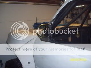

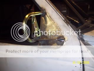

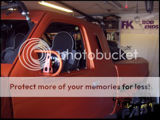

cut the door skin out.. we are doing a different door bar, havent seen anything like it that i know of but should be strong and easy for me to get in and out of

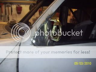

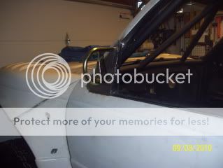

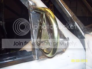

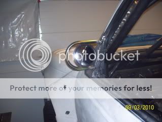

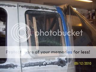

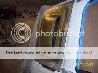

mounted the side mirrors, decided to make a 3d box to flow the spot were old mirrors use to be... this and the other things we have done in the cab has made this cab so solid to the truck you shake or bang on it anywhere and whole truck moves with no vibration

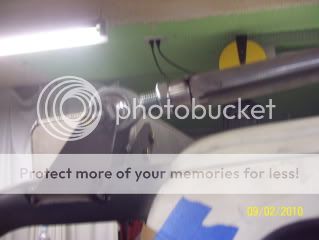

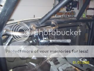

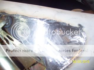

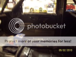

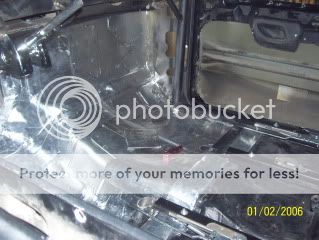

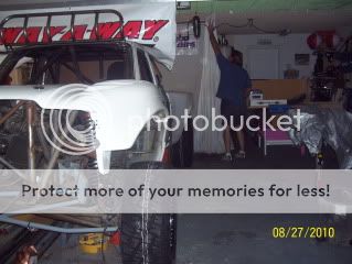

we also sealed up the passenger side of the firewall, tomo we are installing the steering and pivot and quick disconnect as well as seal up driver side firewall and get it finished like the back before i head back to CA

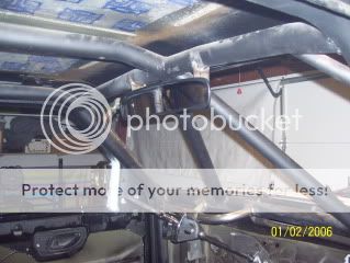

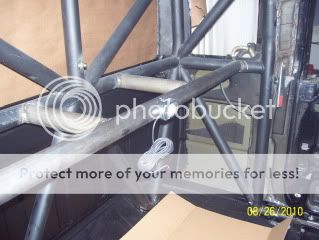

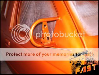

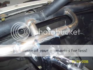

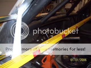

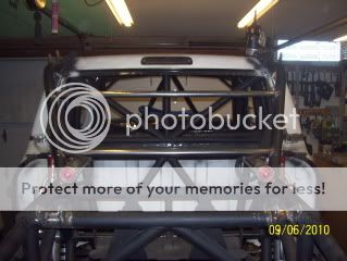

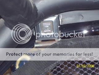

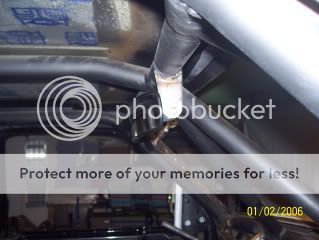

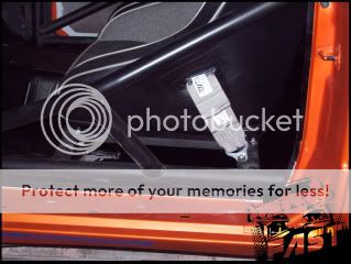

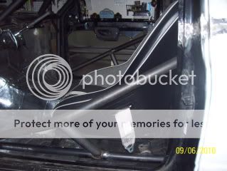

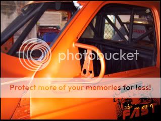

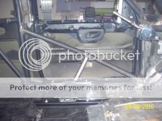

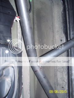

completed door bars, they bend out into the door making it stronger then just a straight bar, easy egress and ingress for me.... completed cooler mount minus the drilling and tapping into the pipes.

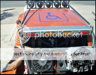

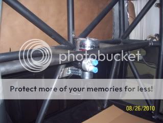

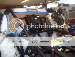

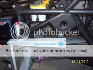

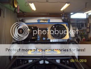

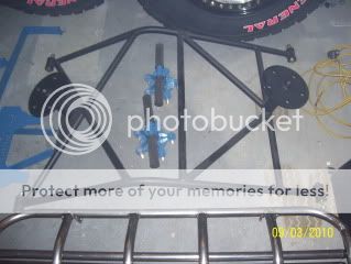

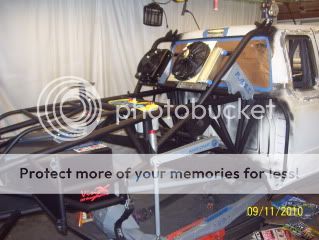

cooler mounts

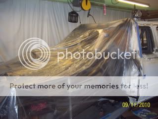

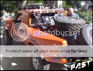

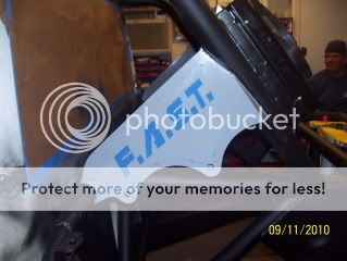

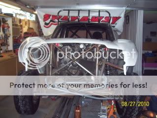

ok I was going to make these the last pictures until the day of the expo, but I think ill post a few pictures of the fiberglass scoops and visors and when body is primer at end of week. Then once paint begins its top secret lol.

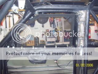

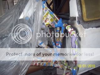

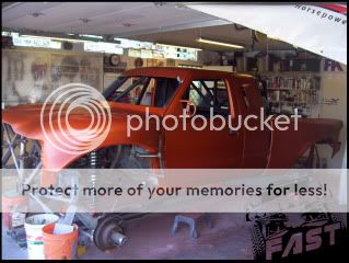

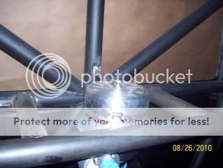

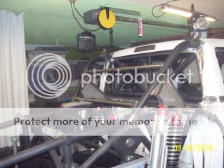

We got all trhe cage work painted from cab back (remember not touching front till after expo, so any work you see is mostly old shop)

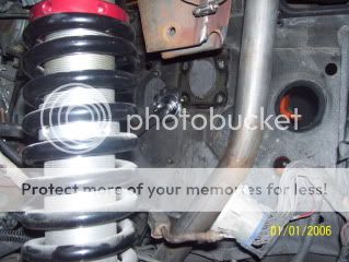

We are going to fix the tie rods on thursday, hoping to get them tap do not like the sleeve look or idea.
So here are the pictures, fabrication is done (metal) until after the expo. The engine oil cooler is not staying there, we just put it up there for show using the same mounting holes as second tranny cooler. The gusset plate was made with idea of two tranny coolers so it is correct. We made lil caps for the sway bar, on a BMS kit i think you get nice aluminum ones, mine didnt come with anything so made these.

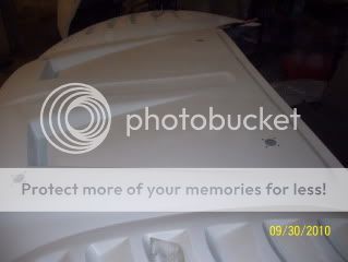

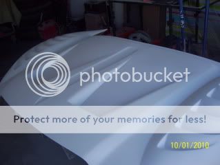

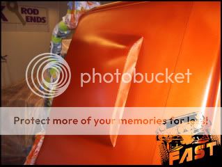

scoop

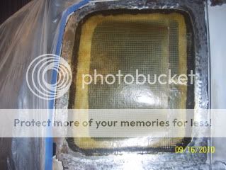

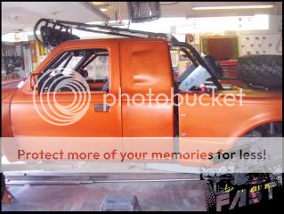

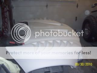

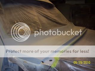

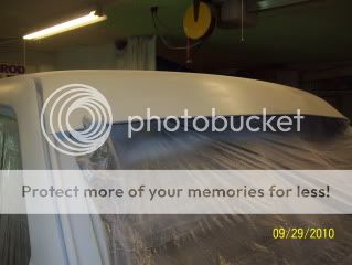

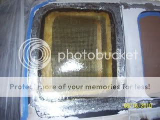

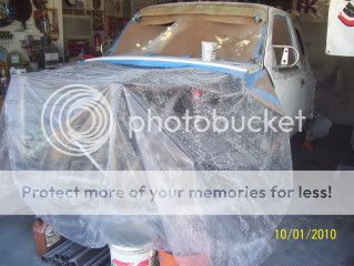

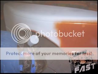

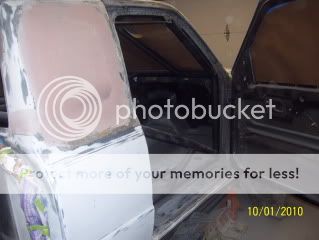

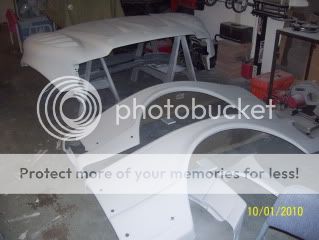

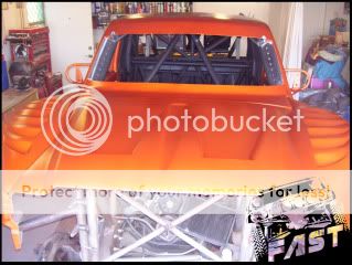

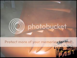

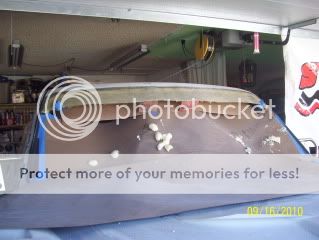

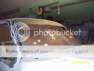

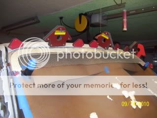

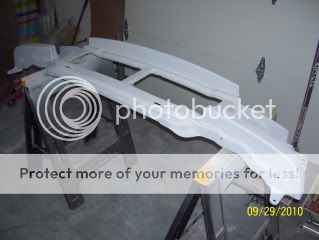

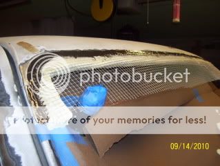

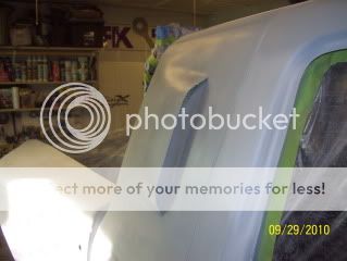

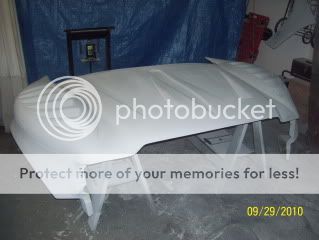

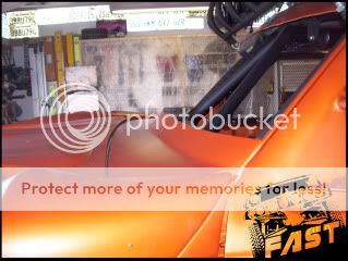

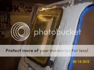

here is a picture of the truck primered that way you can see what we did to the cowl. Graphics are all layed we built a removable winch hitch setup, the steering is good to go cost me a quarter of what it cost to buy it new, not happy about that.. but everything is good you will see the paint and assembly at expo. I dont think i mentioned what color it is. Truck is mostly complete up to the front of the cab there were a couple fabrication things we did not get completed before expo...

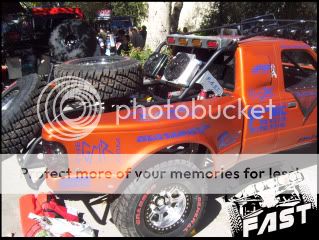

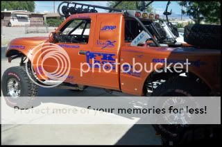

ok I have a break between classes i thought i post some of saturday pics of the models.... here u go enjoy, btw its a crappy camera
