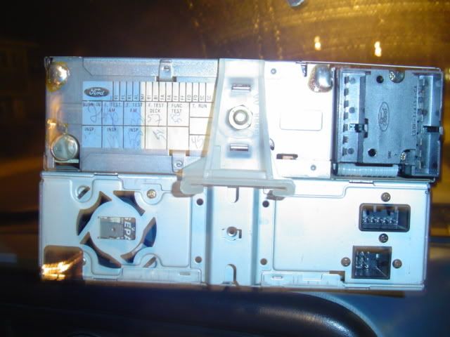

Well, I got the mini disc deck yesterday, and the connections are no where near close. So now I got on the great search for the male connector. I stopped in at a few stereo shops on my way home, and the best and probably most accurate answer I got was *looks at me, looks at deck, looks back at me, looks back at the deck, looks at me again* "You're kidding, right?". I will try Autotemp tomorrow, as they are the main Ford distributor in Calgary, if they don't have it, no one will, and then it will back to E(vil)-bay.
And some pictures, sorry, they were taken at night
The factory that came from my truck is on the top
Those plugs look like the newer style. Might want to drop in a junkyard and find a mustang and pull the wires out of it. Hell you have the deck, whats another few bucks on a harness. Wires should be easy to match.
I'm going to have to stop by Pick'N'Pull in the next few weeks, but If i can find them new, that would be nice. Pick'N'Pull really doesn't have much newer stuff, its starting to get everything early-mid 90's, and early 2000 GM cars :P. Plus when ever I go to P'N'P I always end up with much more then I went for, not that its a bad thing or anything.
Actually that "deck" isn't a deck at all.
It is JUST the mini disc player and it's an "add on" like the single disc add on deck that was available for Mustangs and Taurus/Sable...
So getting "Cables" to hook it to your truck simply don't exsist.
It will however connect with a relatively common power and signal cable
that can be found for the single disc CD player add on which will allow it to be connected to any premium sound head unit.
Though I'll warn you you'll also need an amplifier, because the premium sound deck that player will attach to doesn't have an inboard amplifier.
Lastly, you'll specifically need a '93-up single DIN premium sound head unit.(this unit is distinguished by it's TOTAL LACK of mechanical controls and it's "Smile shaped" volume control.
The line level inputs are different on the '93 up than on the '87-92 "pop out knob"
