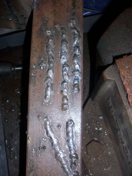

im working on learning to weld lol

but yea i somewhat improved since then, i slowed it down a lil and cranked her up a little bit
Try welding in little circles and if you have a good helmet you can see the puddle form
What kind of rod and machine do you use? I'll bet with cleaning the rust and mill scale off that plate first you'd see a difference, if you haven't tried that already.

Bogger slow down and turn the heat up. Yeah what rod are ya using too? You should have the rod at about a 0 to 10 degree back angle and feed it into the puddle. Once you see it form just start making little C's all the way forward or the circles. Some guys also push it forward than pause than push forward and pause. send us some new pics man
good luck
yea i kinda improved some since then ill try to get some pics of the new stuff tonight. im not sure what the rod is.. maybe 1780?
