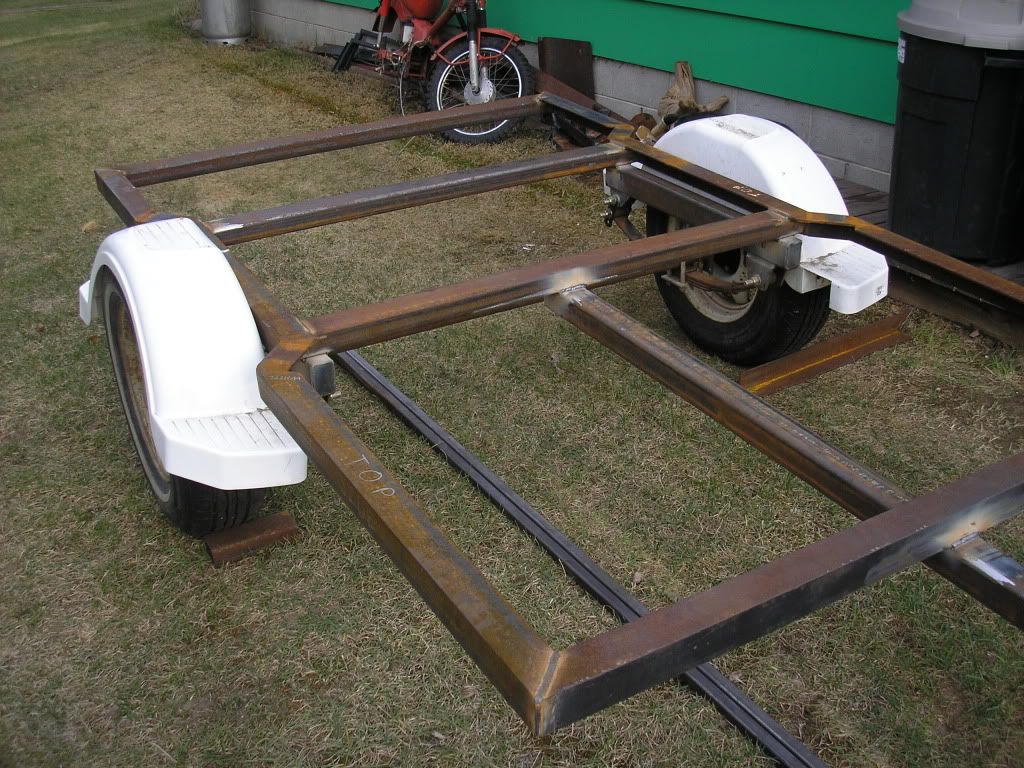

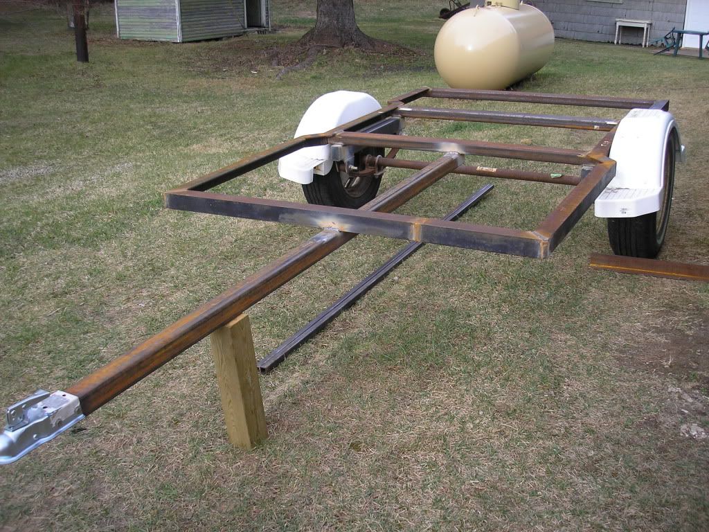

I've been working on recycling a trailer I made in highschool back in 2004. It was made out of massive 2 1/2"x 5/16" angle iron all the way around. Tongue was bent because 1"x 3"x 1/8" square tubing just won't do the job, and I never knew what a "gusset" was.
The trailer landed into the hands of a close friend of mine, and he just wanted the tongue replaced. I told him, after looking over this heap of crap, that I'd replace it only if I could redo the whole thing. He wasn't for it, but he caved in and agreed to it.
Only spent $200 on the lengths of square tubing, hitch receiver, and some angle iron, but this trailer is about 90% reused and it's strong!!
Not done yet, but well on it's way;
Fabricating anything right now?
The sides that clear the wheels were welded at work using the spray arc method, the rest is done using flux cored wire on a Hobart 140 welder. It's the cat's meow of outside welding!! :icon_thumby:
Thanks!
It's an 8ft long by 59" wide (or 5 foot if you add an inch) and 53" between the wheels. Up next is stake pockets for the custom sides, a custom made ramp style tailgate, and getting those wheel fenders mounted.
I gotta say, this one turned out pretty good! A trailer like this, not as heavy duty, would run you around $1200. Build one yourself same exact as the one for $1200: I'd say $500-$700 for all the materials, that is if you had nothing to start with. That's a big savings!
