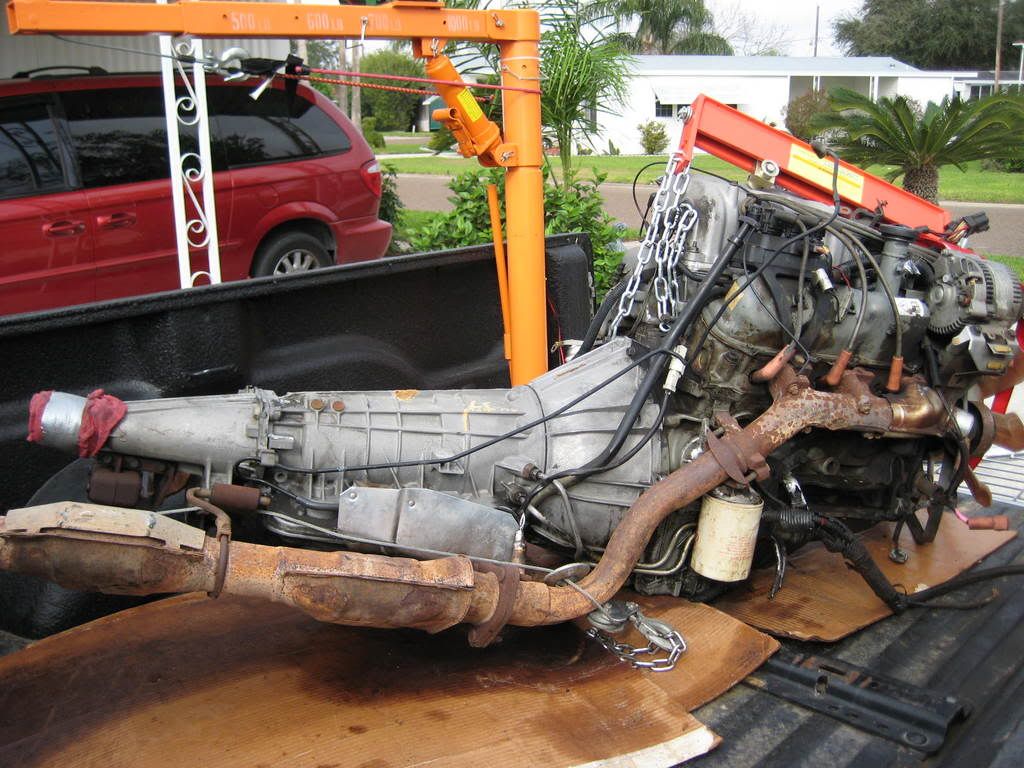

I am using a 4.0 from a 92 Explorer in a unique application. I need to feed it fuel from an inline, external electric fuel pump. The manual says I need 35-45 lbs pressure with key on, engine not running, but no flow requirements. I am having trouble finding a fuel pump that will be compatible with this engine where an intank fuel pump is not feasible. Has anyone solved this problem before?

Thanks guys, some more to investigate. My "unique" application is a replica of a 1936 Mercedes roadster, Marlene Dietrich edition.
