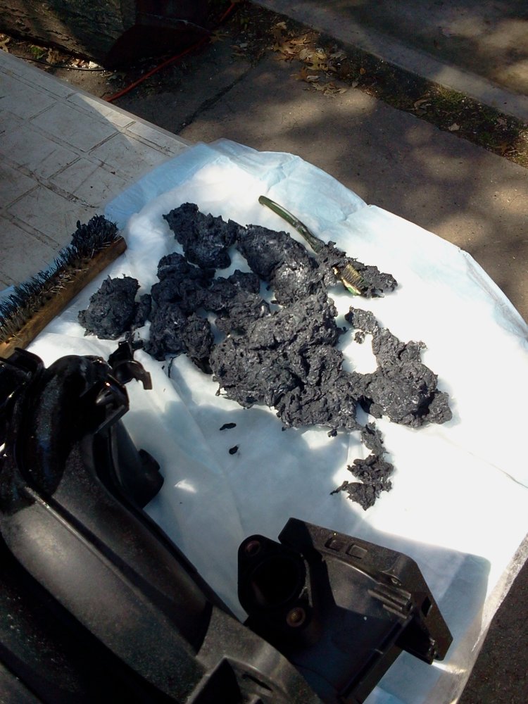

cleaning the carbon and oil inside the runners of a 2.3 Duratec intake. 367,500+ miles and used a LOT of oil in cylinder # 1.
there was about a 1/2" puddle of black gooey mud in the top chamber before the runners.
started with oven cleaner, got some out with no damage. can't get up into the runners.
switched to Draino, got more out, still left a rough coating, no damage after 6 hours soaking.
the crud inside is now white, I'm determined to get it all out.
using a bore scope I can still see crud up in the runners.

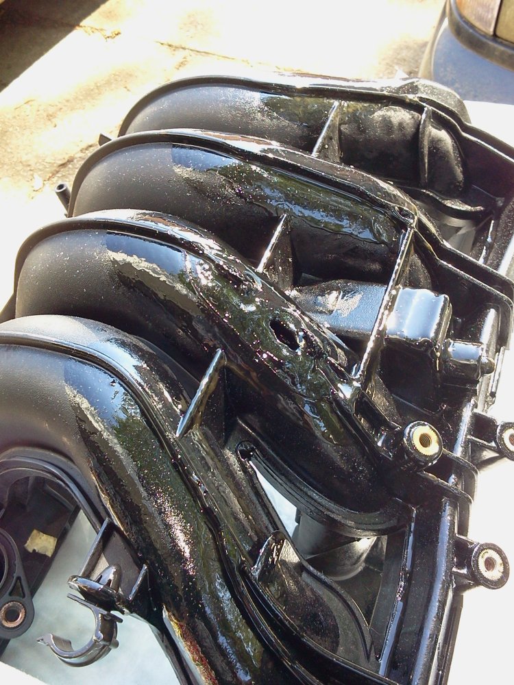

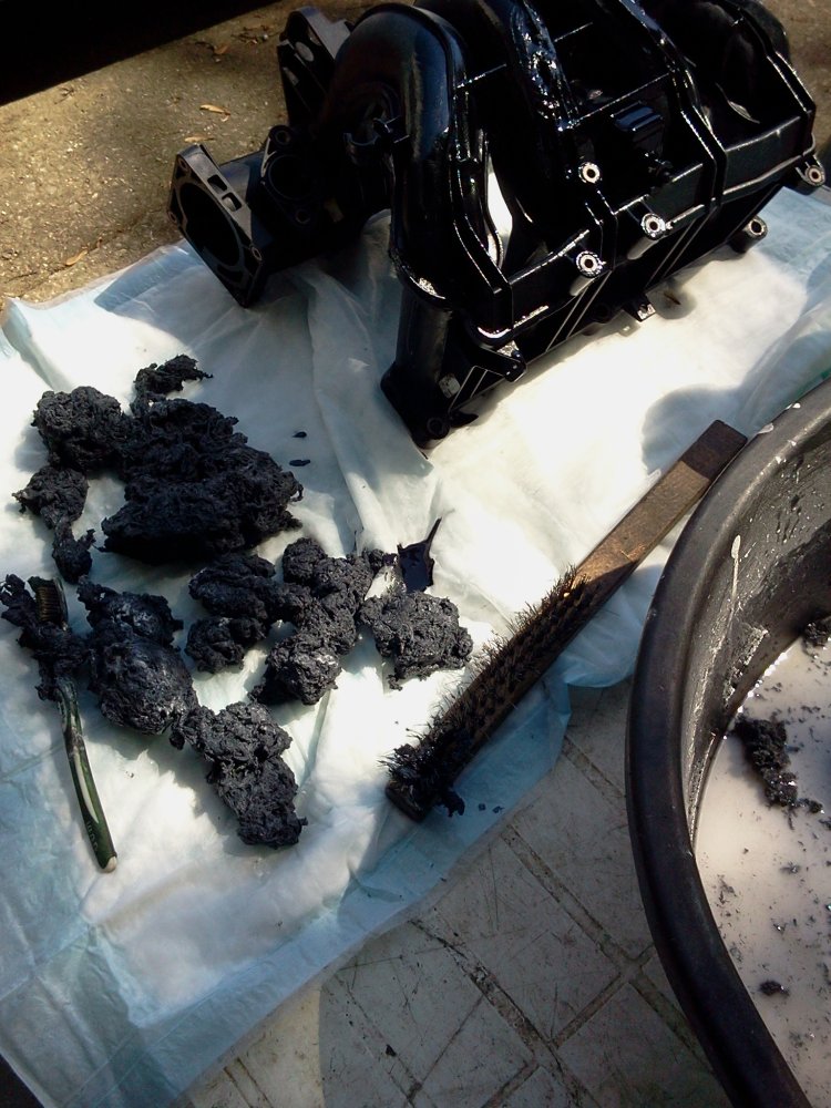

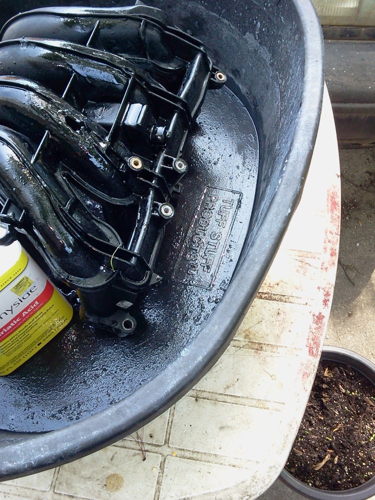

poured in some muratic acid , it comes in a #2 plastic bottle, it must be safe on the plastic intake , right???
let it soak overnight, apparently the intake isn't genuine plastic. metal nut inserts sure are clean. plastic tub is OK.
the big plies of gray stuff are the result of about 2 lbs of baking soda neutralizing the acid.
word of caution, hold your breath when using concentrated acid. if I wasn't bald I'd be a blonde now. :icon_rofl:

Whoa, that sucks that it melted your intake
Good excuse to buy a fancy new intake?
There are a lot of different types of "plastic". Obviously, that one is different from the bottle your acid came in.
We use murattic acid to ruthlessly strip anything/everything out of old fuel tanks.
It is super nasty crap.
Most "plastic" intake manifolds are made with nylon/polymides and other poly-things. Some have a combination of other materials like fiberglass or ceramic resin injected into a mold. All the materials are compatible with petroleum products. Not so much with anything that causes oxidation. The process you just experienced is called hydrolysis.
I've seen videos of people cleaning them with brake cleaner and mineral spirits without any problems. There's a video on youtube where someone left oven cleaner on a valve cover (made from the same material). It didn't melt through the valve cover, but it caused enough damage to the gasket mating surface that it made the valve cover useless.

the runners were up side down compared to the pics. the runners pointed up so pouring liquid into them filled the entire runner.
so this damage was from the inside. I had observed the acid for 3-4 hours and didn't see any bubbling so I thought all was OK.
overnight it failed and acid flowed out to form a shallow puddle in the container which damaged the outside of the other runners.
only two runners had the acid in them.
this was supposed to be a temporary engine so I'll either modify a 2002 manifold or get a used 2005.
Ford has new listed as backordered.
before this I got lots of gunk out with oven cleaner, but it left a film of crusty stuff.
then Draino, it got more out but there was still crusty stuff where I couldn't get a brush.
then vinegar, the 4% cooking stuff. not much effect on the crusty stuff.
then Simple Green. by now the film was white and still around the curve where I couldn't reach.
last was the acid. I haven't looked yet to see if the crusty stuff is gone.
thoroughly rinsed between all concoctions.
I'm going to try a repair, have to find some glue or remover that will soften the material for a patch.
maybe...
EDIT: found more holes, it's too damaged to repair.
