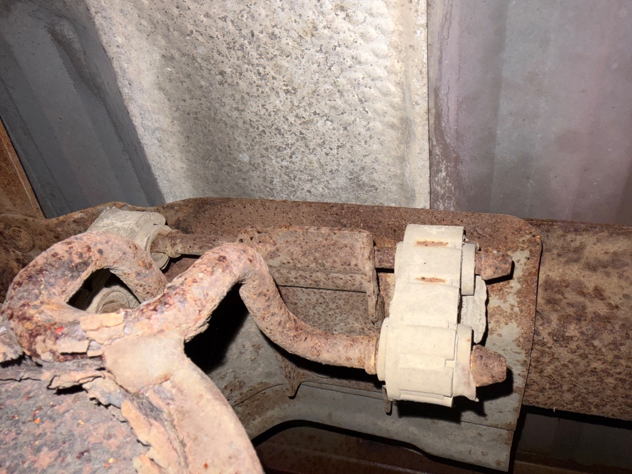

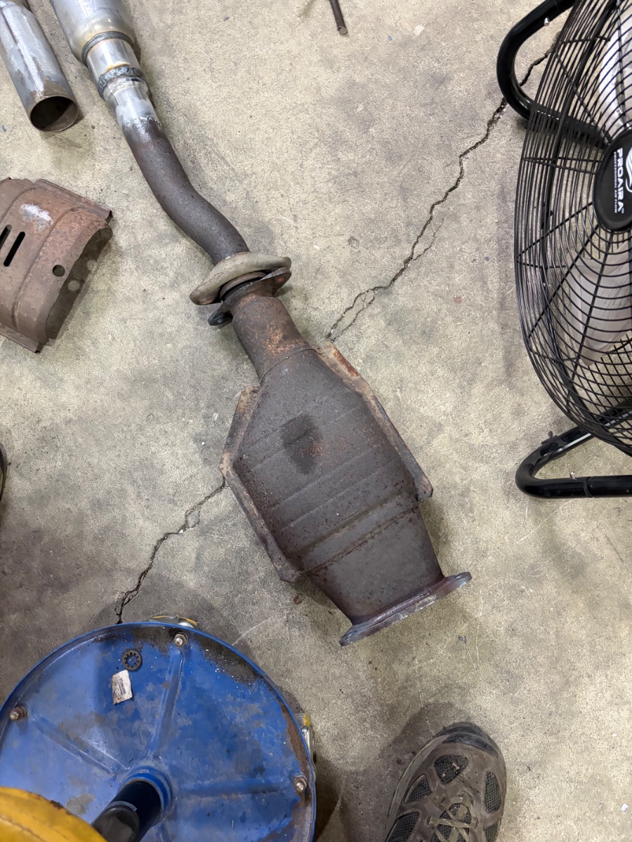

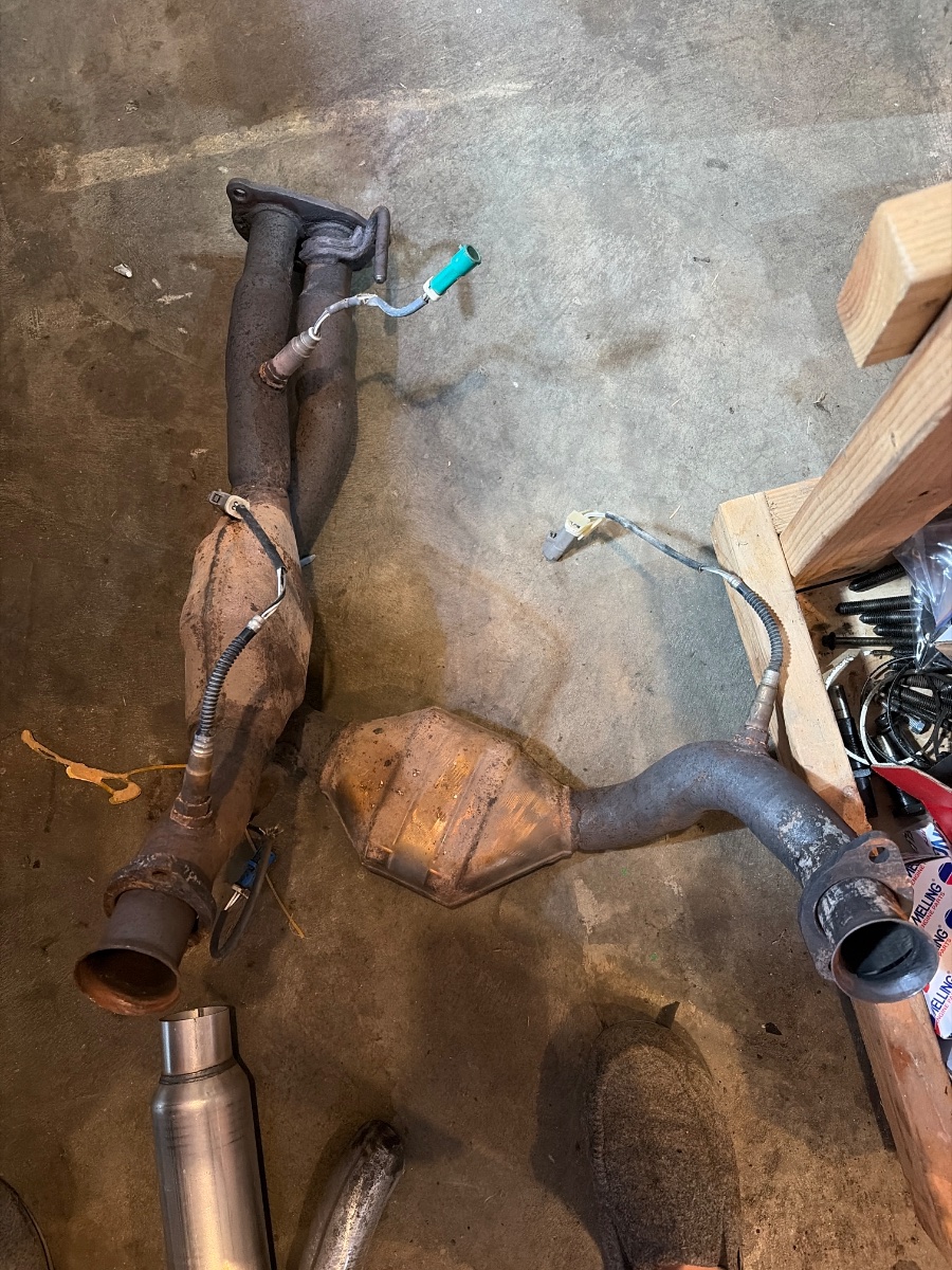

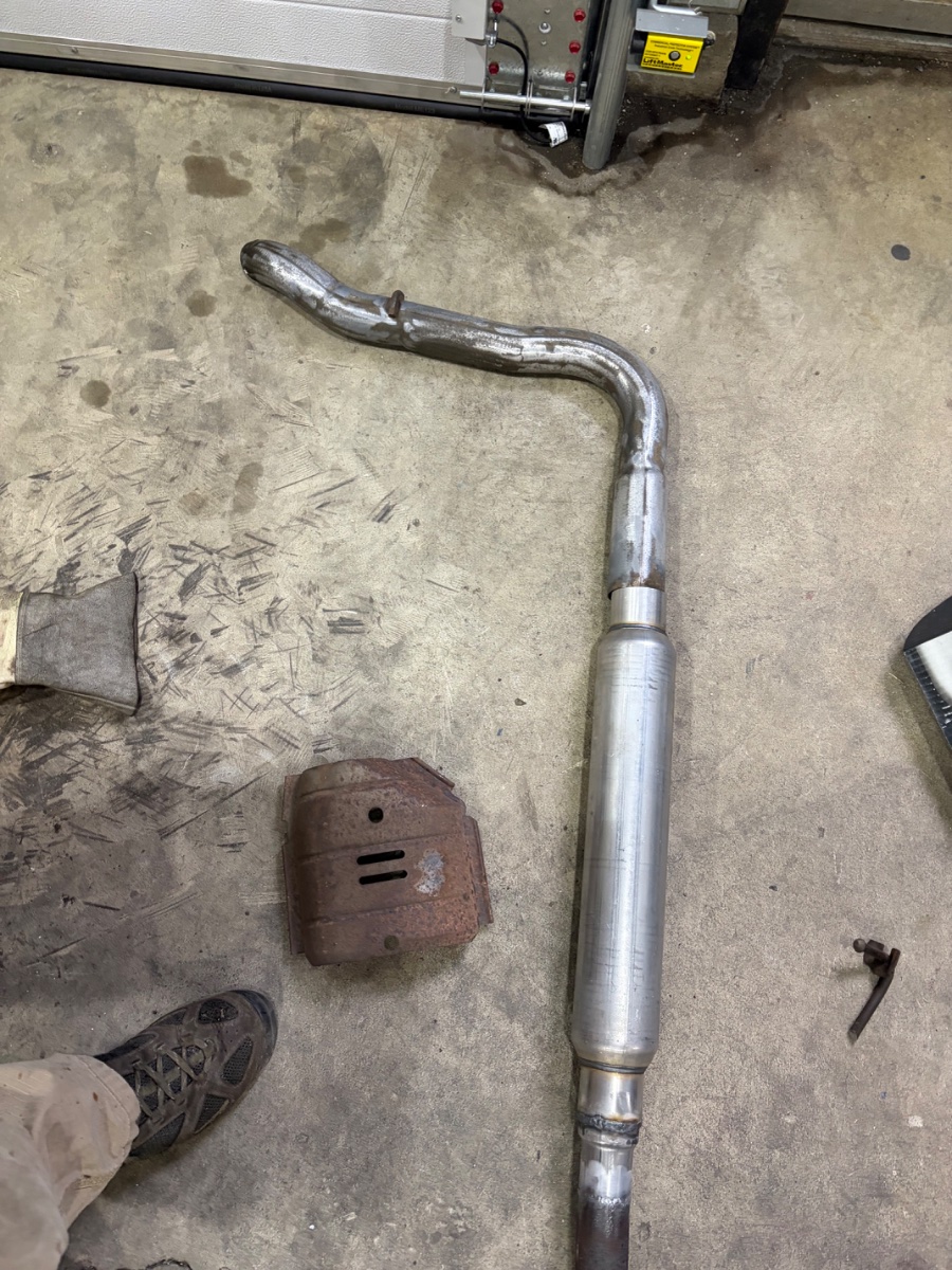

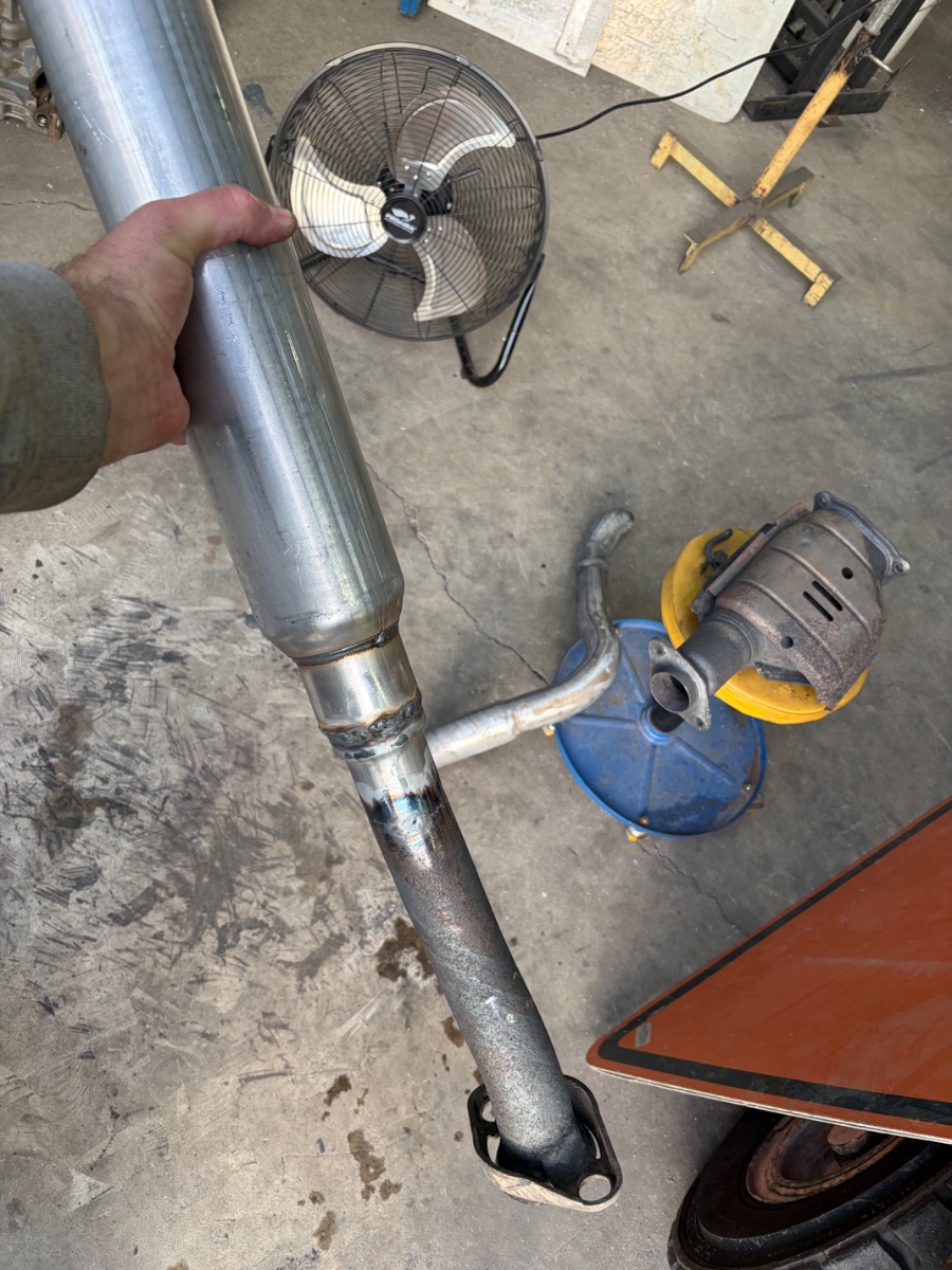

While waiting on engine stuff I took out the exhaust and brought it in to the weld lab to make some mods and clean it up with the laser cleaner. Knocked out all the crap of the rear cat so it’s just a straight 2into1 collector, cut out the muffler, welded in a glasspack muffler. I left the last section off so once the engine is back in and I get the rest all lined up I can make sure it’s positioned right.

I'd recommend getting a functional cat back on it, removing it isn't legal and as a bonus it'll act like a resonator and improve the exhaust note.
It’s got functional cats on each of the pipes just below the headers before it joins into one pipe.
  • Exhaust mods

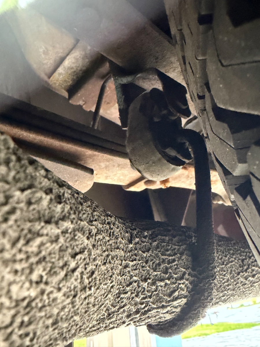

my exhaust looks like that except i didnt unbolt it used a sawzall bolts to stiff and v8 swapping so just need it gone
