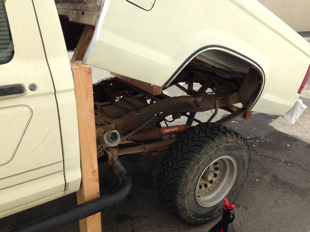

Trying to pass CA smog and still have Evap leak on 1989 Ranger 2.9L. I built my own smoke tester and thought I connected and tested everything but must not have gotten all the way back the smog shop thought the gas tank filler neck was likely. Any tips on best place to connect to smoke test that section? Just plug the filler neck and smoke it there? Want to test before just throwing in a $175 part.

With my home smoker I tested again and did not get anything from the filler neck. I was glad I ruled out that $180. Part at least. However it was a pretty breezy day and I didn’t conclusively get smoke from anywhere so I brought it to my favorite smog shop and told them at least I knew it wasn’t that filler neck.
They did their own test and found out the ring on the fuel tank sending unit could have been tighter so they turned a quarter turn and that was it! These guys are awesome because they basically charged me $20 plus the smog to take the bed off and mess with that. If anyone is in Sacramento area message me and I’ll give you their info.
