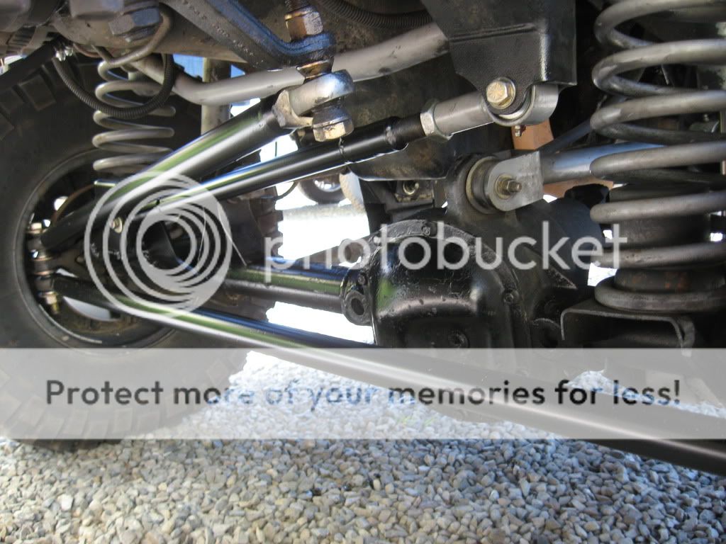

I would run the draglink on top of the knuckle so that if it doesn't work then it can be on the linkage.

Here is what I am doing for steering. It will be exact to this picture but the rod end will be on top of the pitman arm. Even the trackbar bracket is what I will be using.

Oops, here is the pic.
Escorts 2nd SAS
Sent from my HTC ONE S using Tapatalk 2
I still see no pic...?
I see it on my internet tablet, phone and computer.
Maybe it's an Apple thing.
Sent from my A500 using Tapatalk 2
I wasn't on my phone, I was on my Windows laptop. I see it now, I refreshed the page like 5 times earlier and it never showed.
Your f5 button must be screaming at you now.
