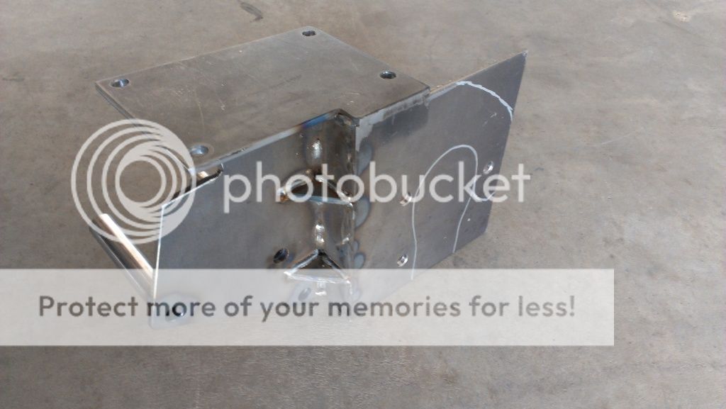

Well, had to make two modifications to the bracket to get the ac pump to mount. Hopefully I can make it work cause I am running out of time and money.
