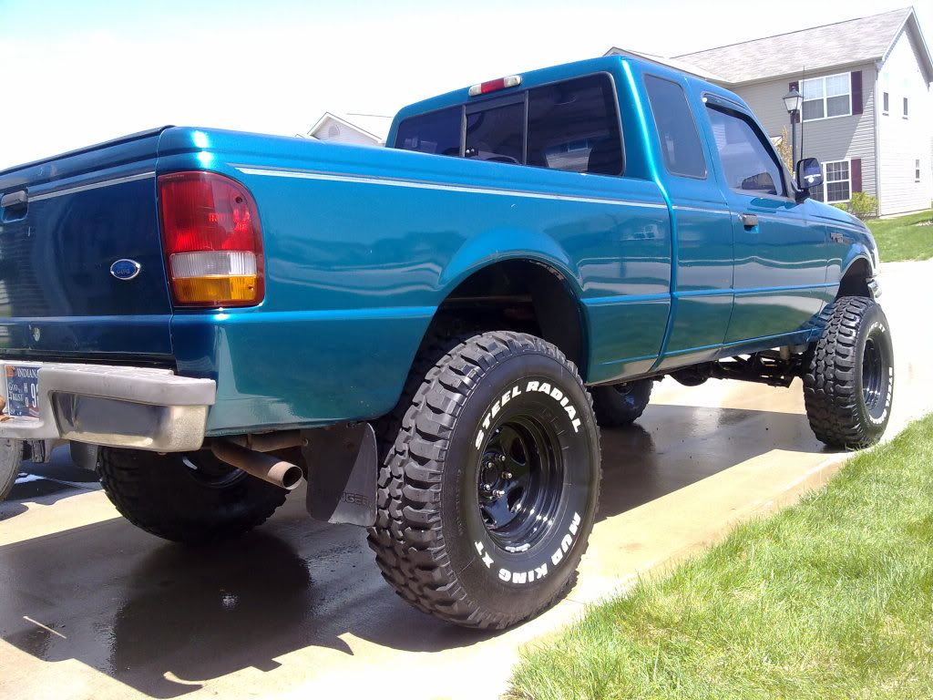

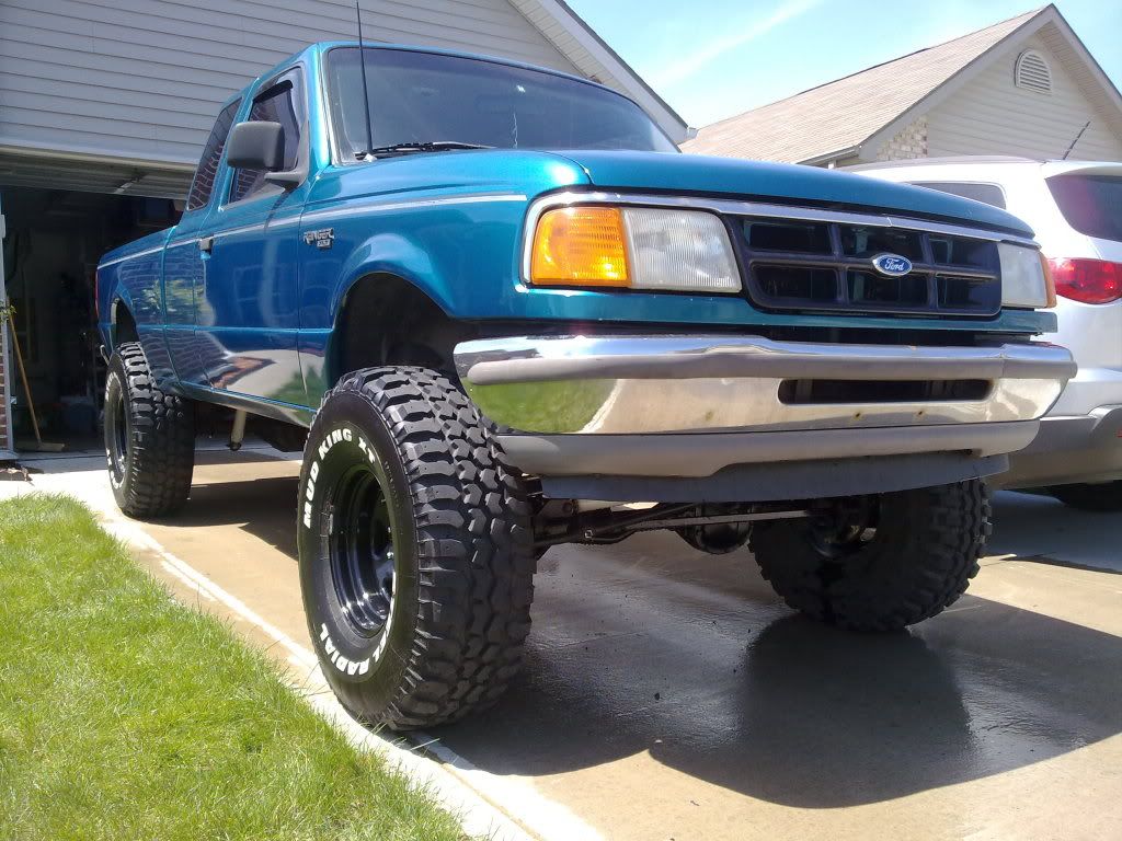

Gave it a bath and waxed it to. Looks really nice for a 93.

hope you dont mind me sayin, but i like it better than the first one
Thats ok, it's starting to grow on me. I have always like this generation better.
